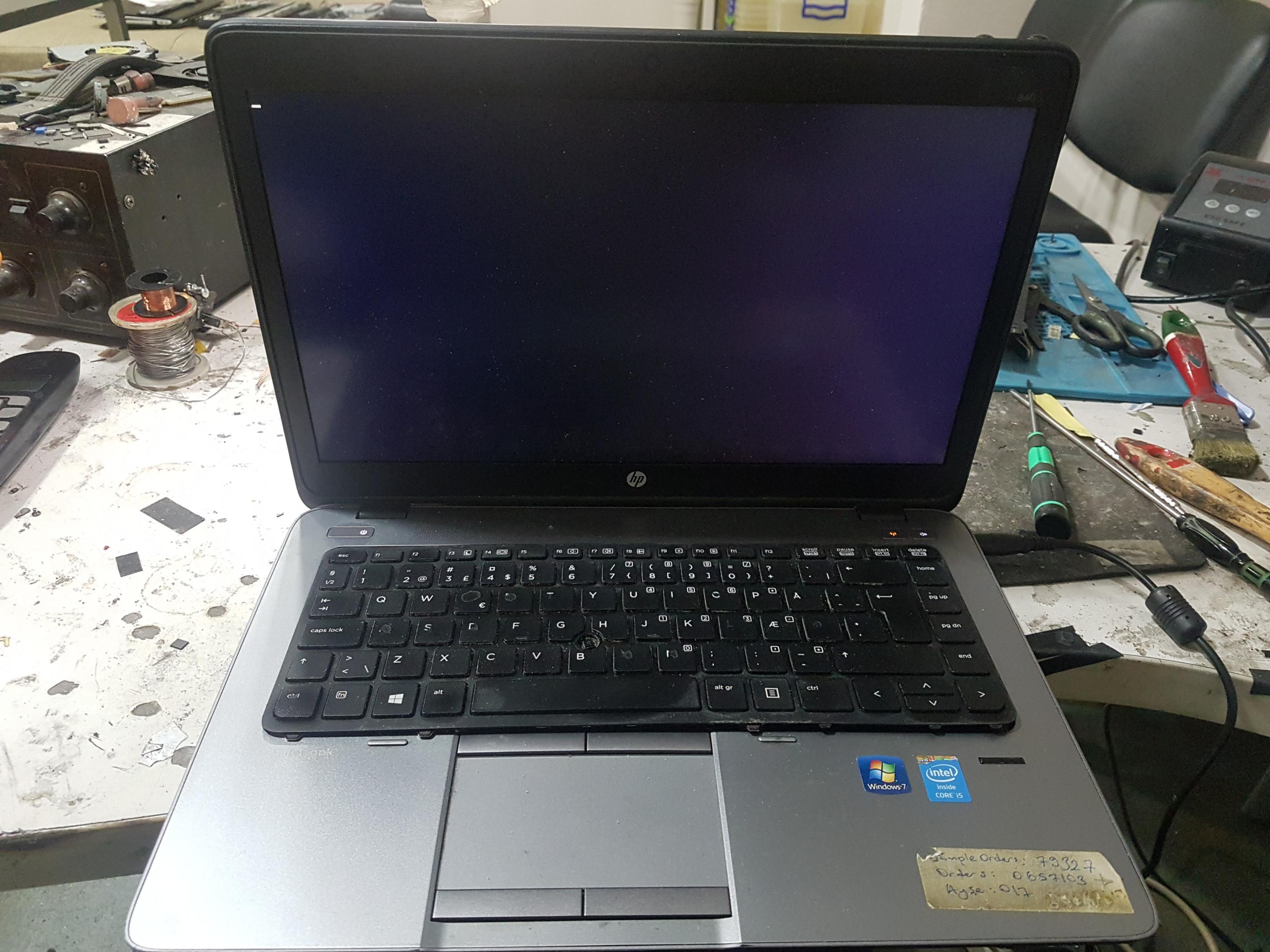

                                Hp 840 g1 - 6050a2560201-mb-a02
                                LATE IMAGE AND WAITING ON THE FIRST SCREEN
                                Can you fix it ?
                                OLD DUMP :
