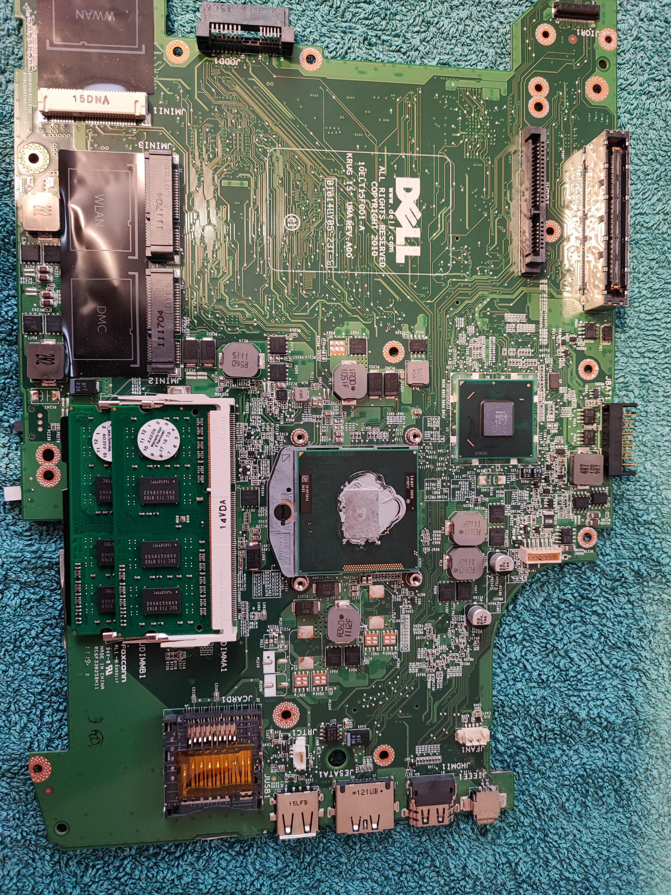

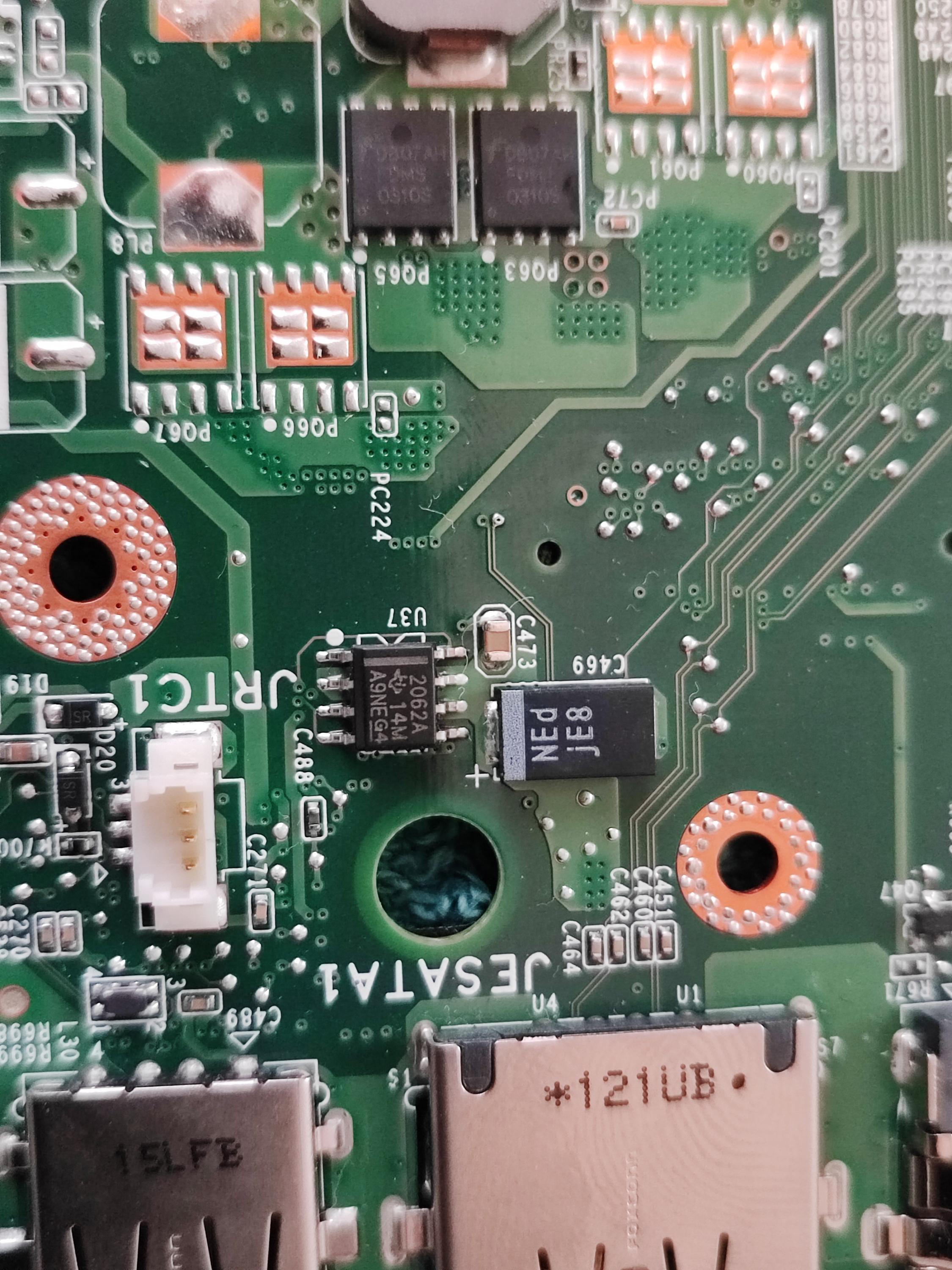

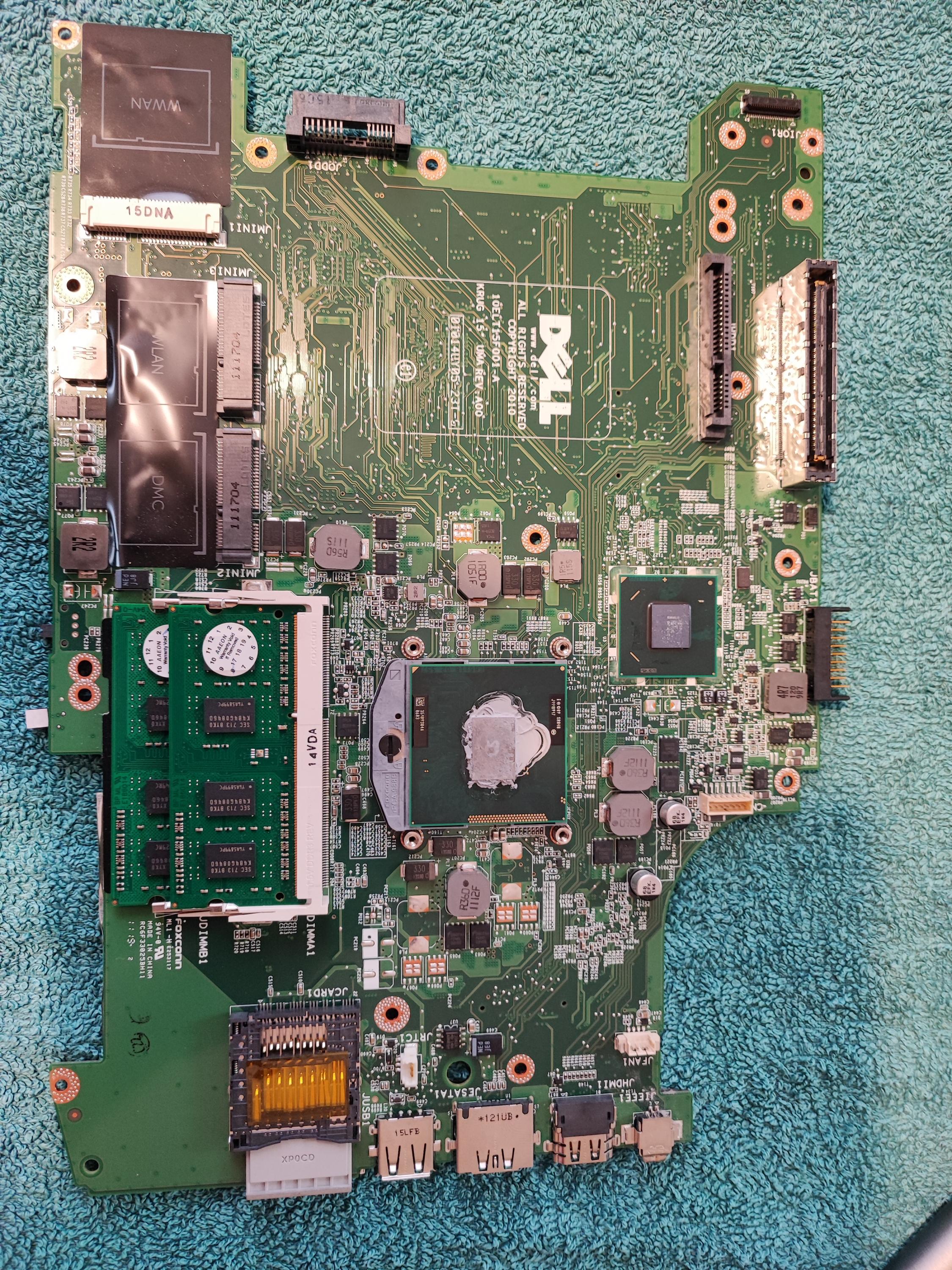

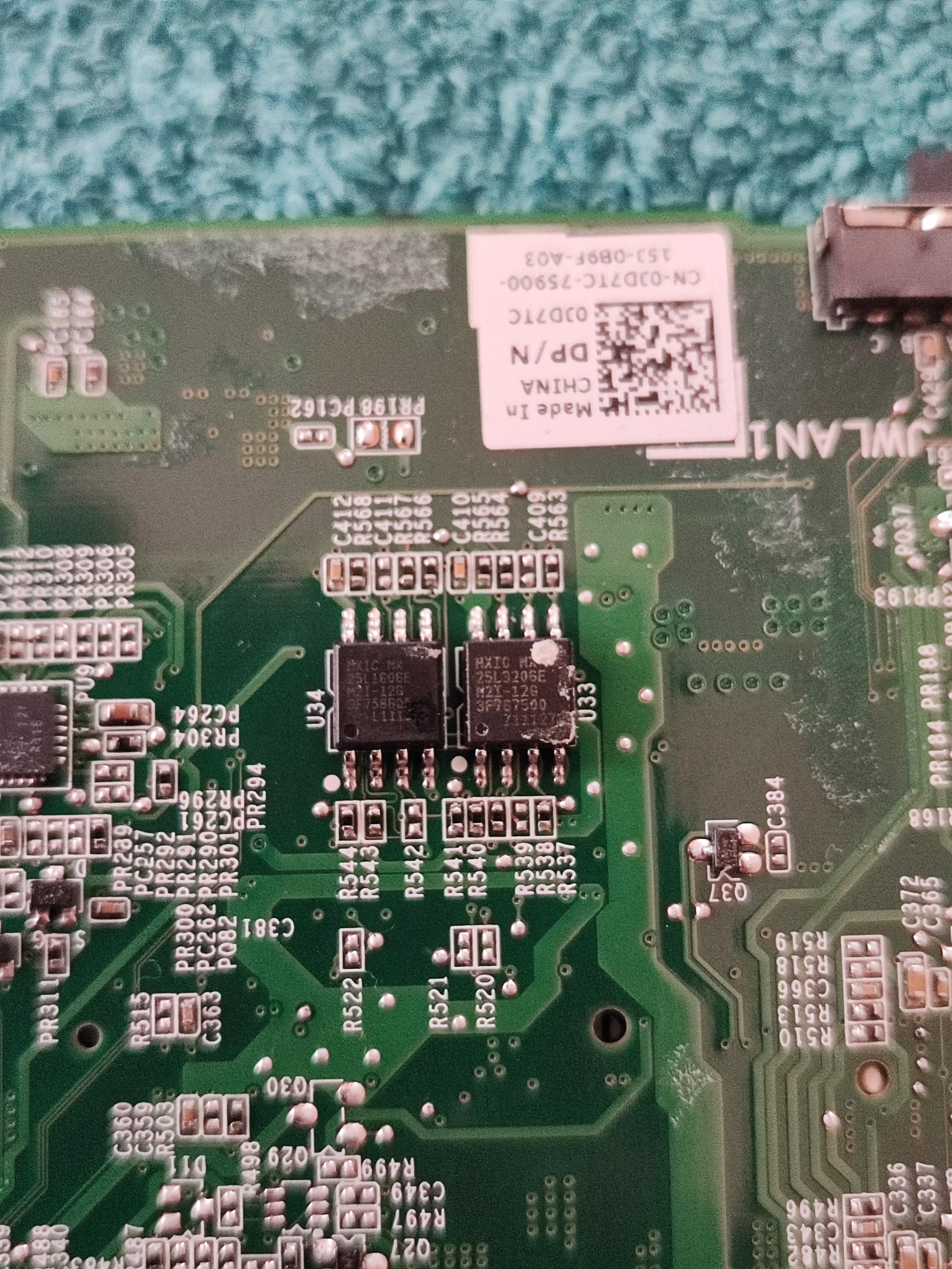

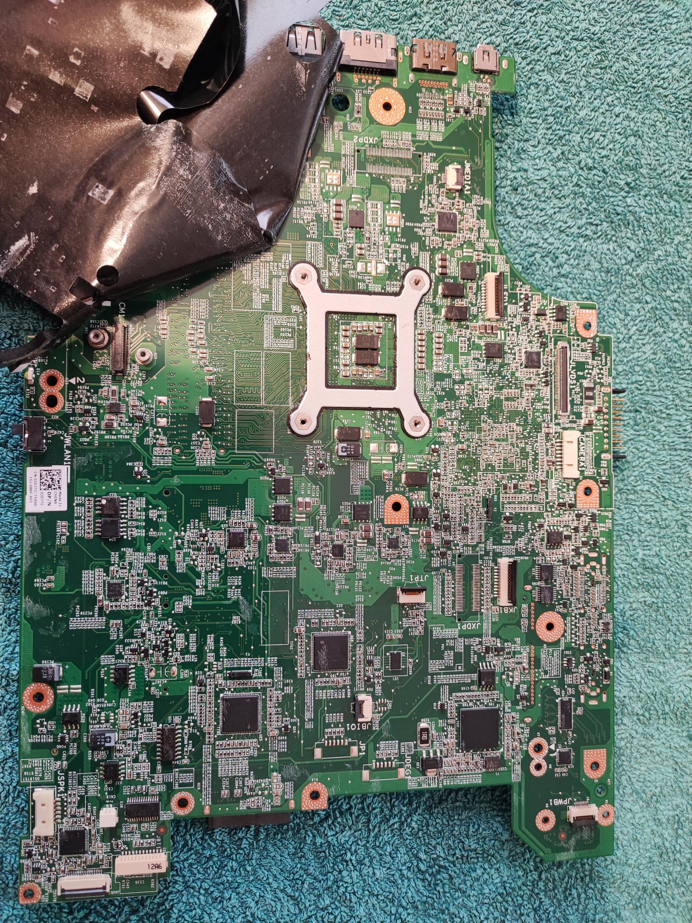

                      E5520 bios
                      Hey Guys.
                      I have Here a e5520 with Password. So i would Backup the original BIOS but who ist the Chip?
                      And can anybody remove the PW when i Upload the backup
                      • peste
                        • Dec 2016
                        • 13599
                        • ROMANIA
                        Re: E5520 bios
                        Originally posted by Skrillex1989
                        Hey Guys.
                        do you have a SPI programmer??? take clear pictures on both sides of the motherboard..
                        • Skrillex1989
                          • May 2022
                          • 16
                          Re: DELL E5520 with bios password
                          Yes i have a programmer
                          Here the pictures i think in the Last Pictures ist the BIOS Chip or?

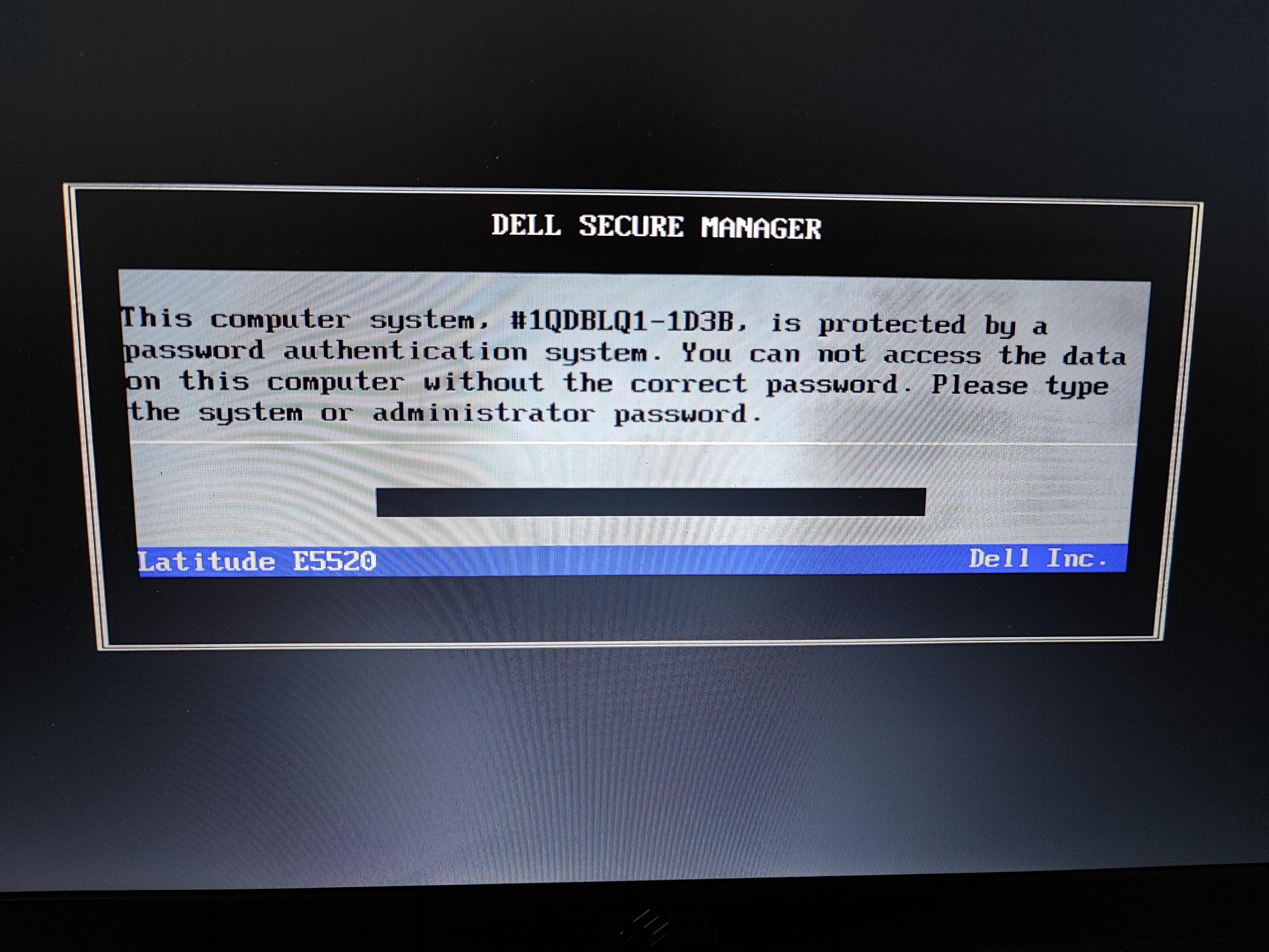

                            • 21922
                            Re: E5520 bios
                            Hey Guys.
                            https://beta.bios-pw.org/
                            BIkm028N93OIYsPx
                            • Skrillex1989
                              • May 2022
                              • 16
                              Re: E5520 bios
                              This Password dosnt work
                                • 21922
                                Re: E5520 bios
                                Are you using a US qwerty keyboard
                                • Skrillex1989
                                  • May 2022
                                  • 16
                                  No is a qwertz Keyboard and i have Test BIkm028N93OIZsPx too
                                  • Skrillex1989
                                    • May 2022
                                    • 16
                                    Soo its worked the I is a little L after O
