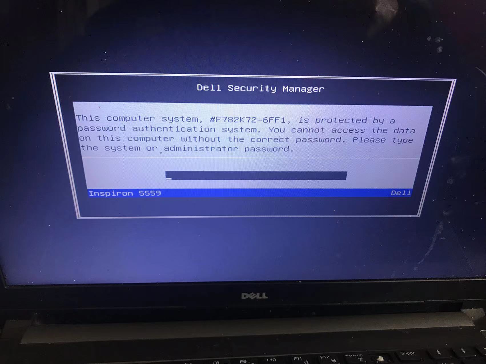

                          #114
                          hi everyone
                          so I have BIOS problem with Dell Inspiron 5559 with Service Tag: JC0M462.
                          "board Info: AAL15 LA-D071P Rev : 1.0(A00) 2015-07-06"
                          I have to add I replace the BIOS IC with new one, Because the old one can't read from or write to.
                          because of that I can't Read the old File.
                          IC name it's "winbond 25Q128FV" .
                          I already try all BIN file provided here so in general I facing 3 result:
                          1-machin turn on ,no screen , fan working full speed .
                          2- it's turn on ,no screen , slow fan speed ,but then after a few sec it's turn off itself.
                          3-totaly NO respond and do not do anything.
                          thank you all.

                            #115
                            Originally posted by stars.4u
                            hi everyone
                            thank you all.
                            Try this file ......
                            • stars.4u
                              stars.4u commented
                              Editing a comment
                              thanks Bro, do you have admin password for this file or same Bin file with no Password by any Chance?
                          • stars.4u
                            • Dec 2023
                            • 3
                            • CHAINA
                            #116
                            Thanks Bro,
                            do you have admin password for this file or same Bin file with no Password.
                            it's boot in the first try, but it need password immediately after boot
                            screenshot its attached.

                              #118
                              Thanks Bro,
                              Try this ..
                              F782K72-6FF1 Password is: oxzoVmttoEsEVRrm
                              or
                              F782K72-BF97 Password is: N2sppjNZE[kXcsNZ
                              The password was generated for a US keyboard and it is very important to write it that way.​
                              If the keyboard type on your notebook is German ( QWERTZ ) or French ( AZERTY ), connect a USB keyboard with QWERTY type
                              Enter the password slowly. Pay attention to big and small letters.
                              After entering your password, press the left Ctrl key and continue holding it, press Enter twice
                              • stars.4u
                                stars.4u commented
                                Editing a comment
                                working just fine, thank you so much Bro.
