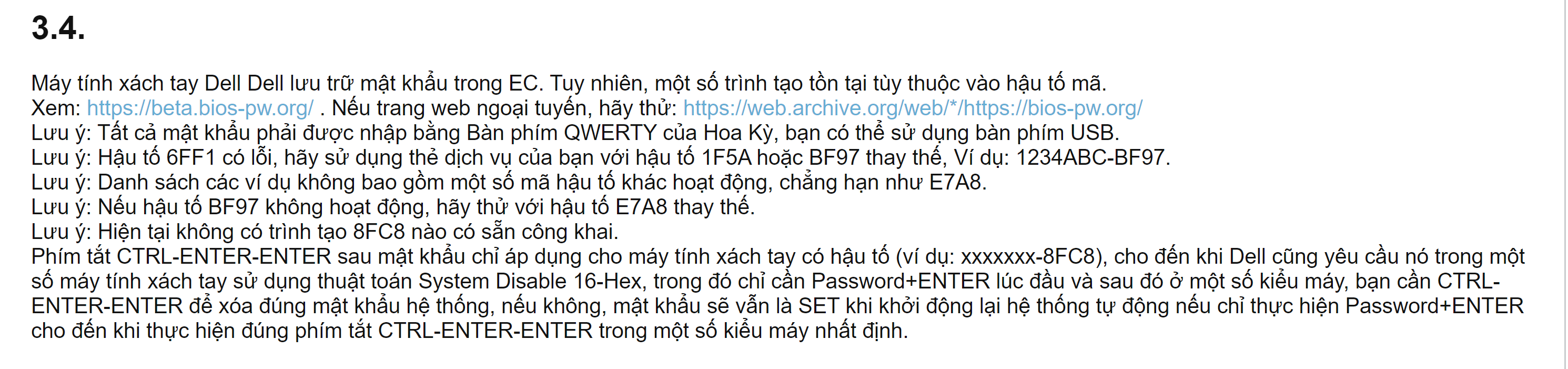

                Did you try other suffixes https://www.badcaps.net/forum/troubl...=4#post1622423
                Note: The 6FF1 suffix has a bug,use your service tag with the 1F5A or BF97 suffix instead,Example: 1234ABC-BF97

                        https://bios-pw.org/
