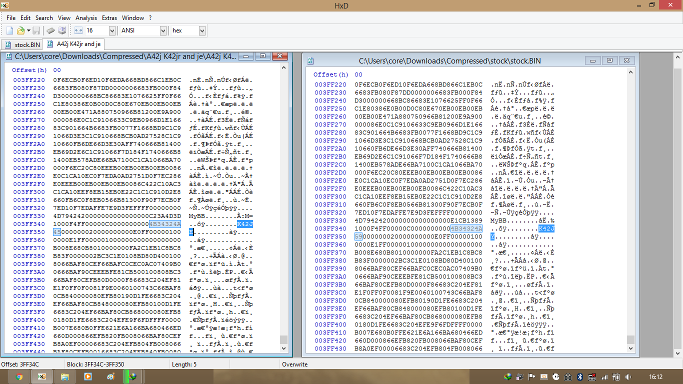

              Re: Asus X42J bios dump
              i think it was different file. if i look with HxD at address 3FF34C is K42JY (stock) and your file at address 3FF34C is K42JE. but i don't know...maybe different model and not working. just my opinion
