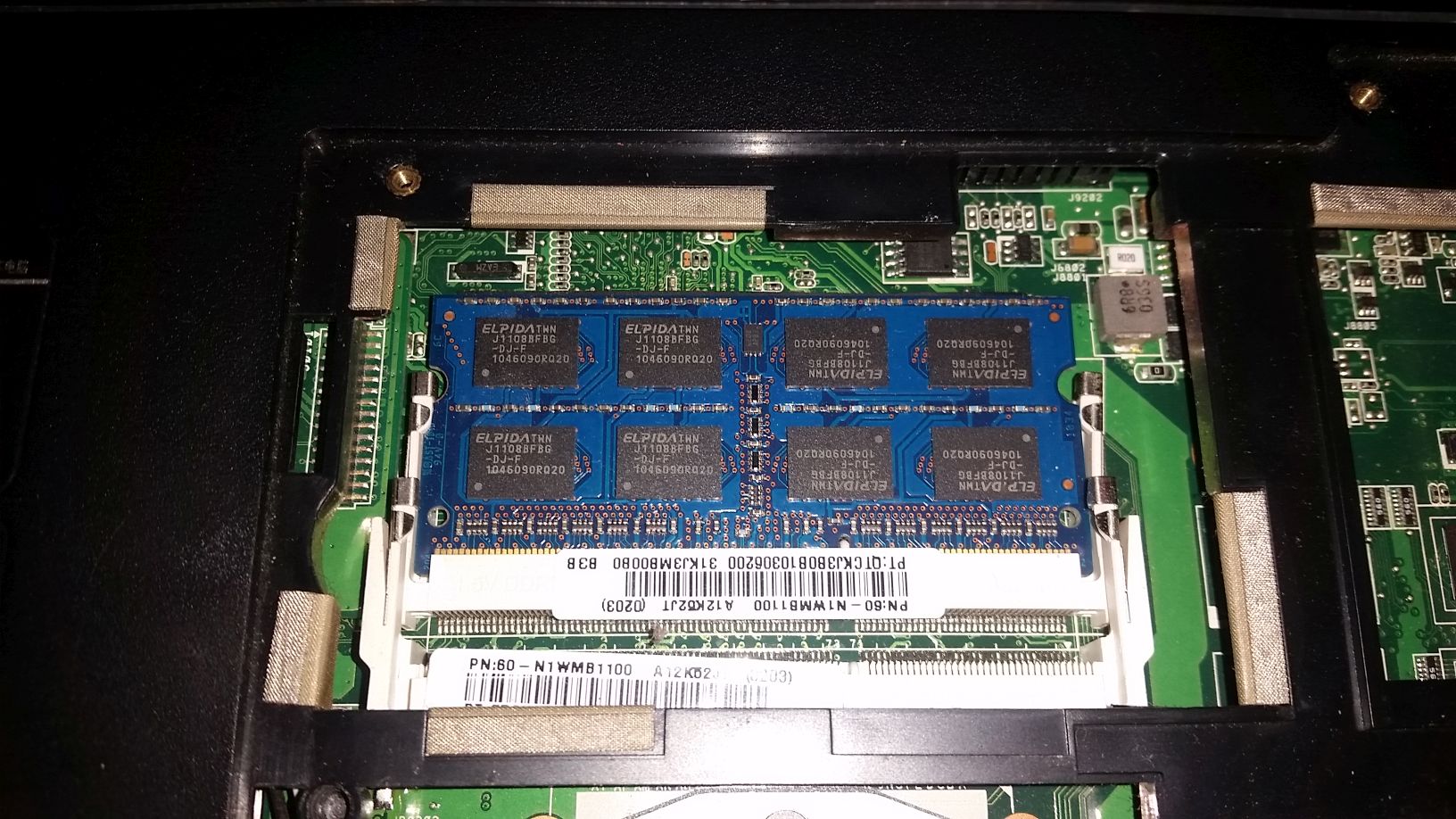

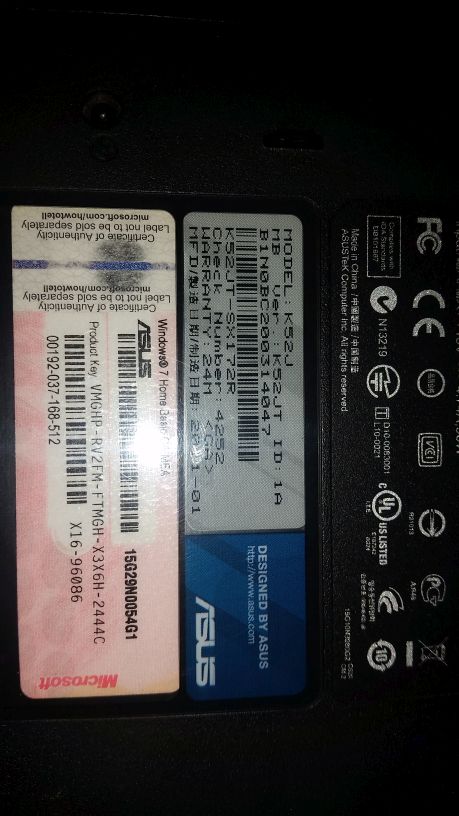

          It reads K52JT at the bottom of the case, and K52JT is written on the RAM slots. But Bios version K52JU.206. I re-flashed lower and same versions from Asus site but nothing changed.

          I don't know if the problem is in the bios, but the models are different (K52JT and K52JU) in the motherboard and bios.

                          Upload the image with the motherboard stickers.

                            Sure. Here they are.
