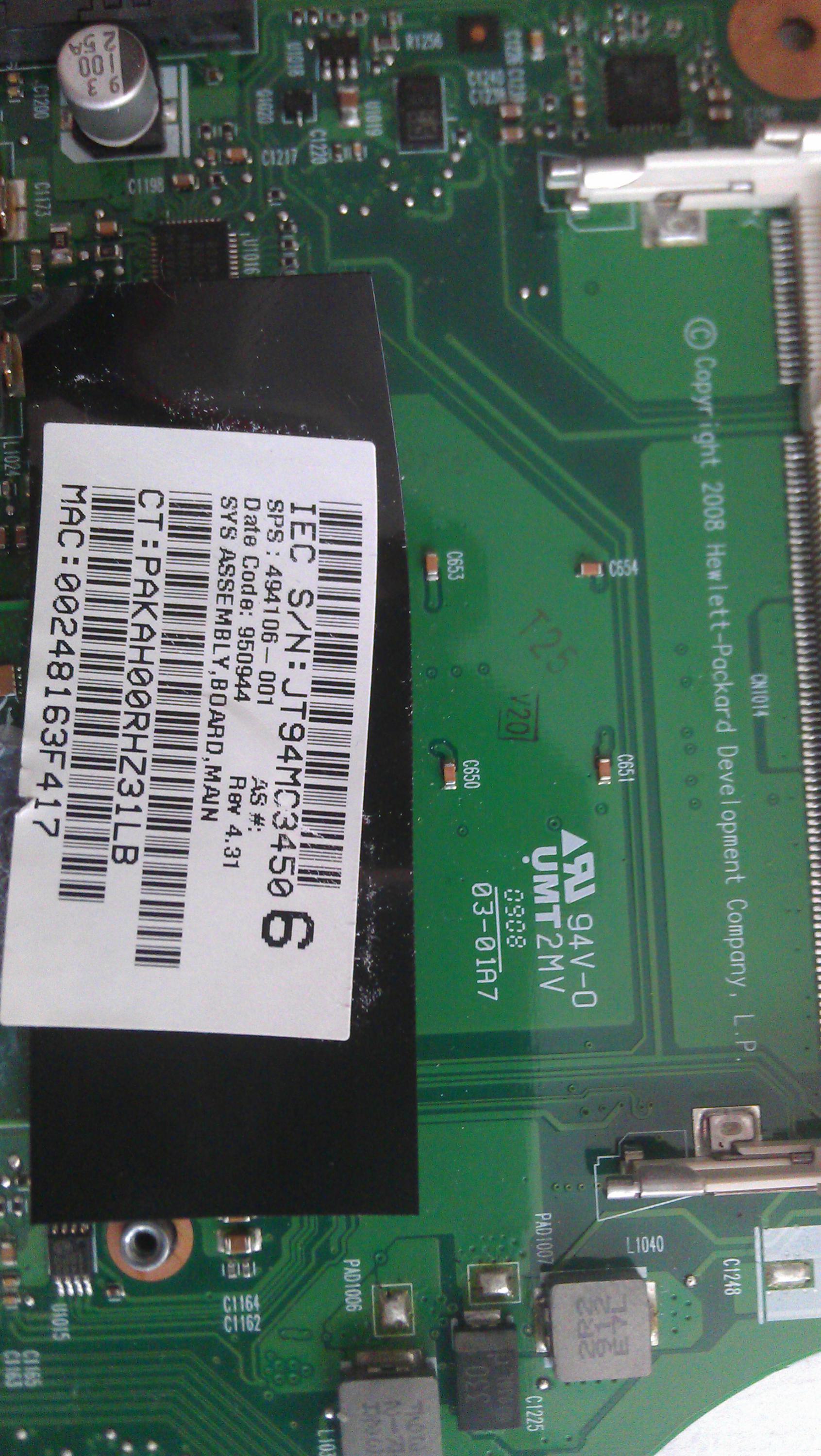

    Hello. Have this HP6735S with error "invalid serial number". i read about serial changers booting from usb, but i cannot make any usb booting from it. I see that bios ic was touched.
    Bios bin from hp website have 2MB but i have only 1MB chip so bios is needed.
    Its full AMD/ATI system

                Re: HP6735s "invalid serial number", bios needed
                i found only this mark /photo/
                i attached original rom that showing error. bios ic is 1mb
                  underneath that sticker is a motherboard code which is i guess 6050A2235601-MB-A03
                  all dumps i found are 2 mb.... schematics also says 2mb SST_25VF016B...
                  why not take eeprom from other non working board and put it in... its worth a try.... any 2mb spi eeprom should work
                  did you see traces of soldering when opened? maybe someone did some work before you... :/
                    i found the right ic in hp 625 board. programming with origo hp rom.
                    ill let u know how it goes
                    • ktmmotocross
                      Boardkiller
                      • Feb 2014
                      • 3577
                      • slovakia
                      Solved.
                      i bad check bios id. it was 2MB, but it was corrupted. Cannot program it to end. So i took the same from HP 625 and program it. now i can see boot devices and can boot to DMI and change the sn.
                      I attach DMI with usb format tool.
