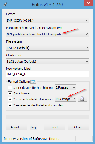

    Hi brother, I need toshiba c50-a628 bios. Because this bios only support UEFI boot. So i need update bios for CSM boot. i have downloaded toshiba server but this bios is more than 8MB so that i cant use it.
    System model: C50-A628
    Part no: PSCJGV
    Motherboard PN: DB10BM-6050a2623101-mb-a02
    If anyone can please help me.
    Thanks advance
    I have attacched orginal bios below.

          This bios only support uefi mode and I can't boot windows 8 also.when I boot from pendrive or windows 8 dvd it gives this message ``checking media failed``Or tell me how can I update this bios. Waiting for good solution. Thanks again.
          • ala_borbe
            aka Donald
            • 1625
            • Malta
            Re: Toshiba C50-a628 BIOS need.
            use rufus to create uefi bootable usb installation diskof win 8, works 100%

                Thanks ala_borbe, i have tried with your bios but its not power up my laptop. also try with rufus to make bootable pendrive but also same no bootable media found. Please give another bios file.
                • ala_borbe
                  aka Donald
                  • 1625
                  • Malta
                  try this bios
                  this is tutorial on how to use rufus
                  Code:
                  http://www.nextofwindows.com/how-to-make-uefi-bootable-usb-flash-drive-to-install-windows-8/
                  maybe you don't have uefi win8, some installation discs do not have uefi files on them, so they cannot be booted on uefi environment
                  if so, you need new win8 installation iso
                  you can also try downloading iso bios update for this model
                  Code:
                  http://support1.toshiba-tro.de/tedd-files2/0/bios-20140402102034.zip

                    Thankss lot all off of you speacially ala_borbe. I have updated bios with your provided ISO image. By the way i want your help , Can you give your e mail id to me?
