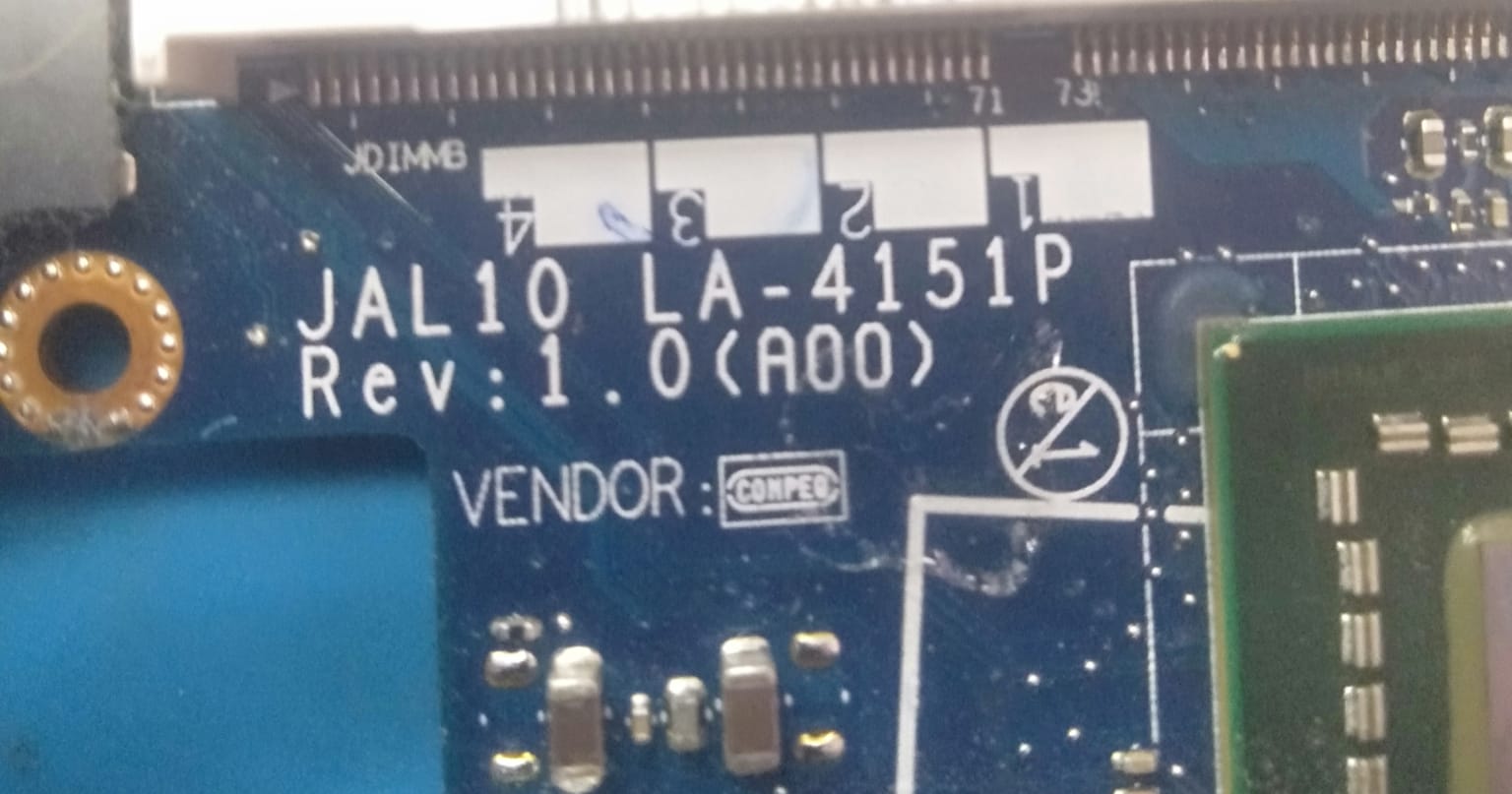

                Dell Latitude E4300 BIOS need
                I need BIOS BIN for Dell Latitude E4300
                MOBO : JAL10 LA-4151P REV: 1.0

                  Re: Dell Latitude E4300 BIOS need
                  Your file is badly damaged and cannot be recovered. This file was found via google search.

                    Re: need dell latitude e4300 bios dump
                    Thanks but not working to me
