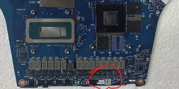

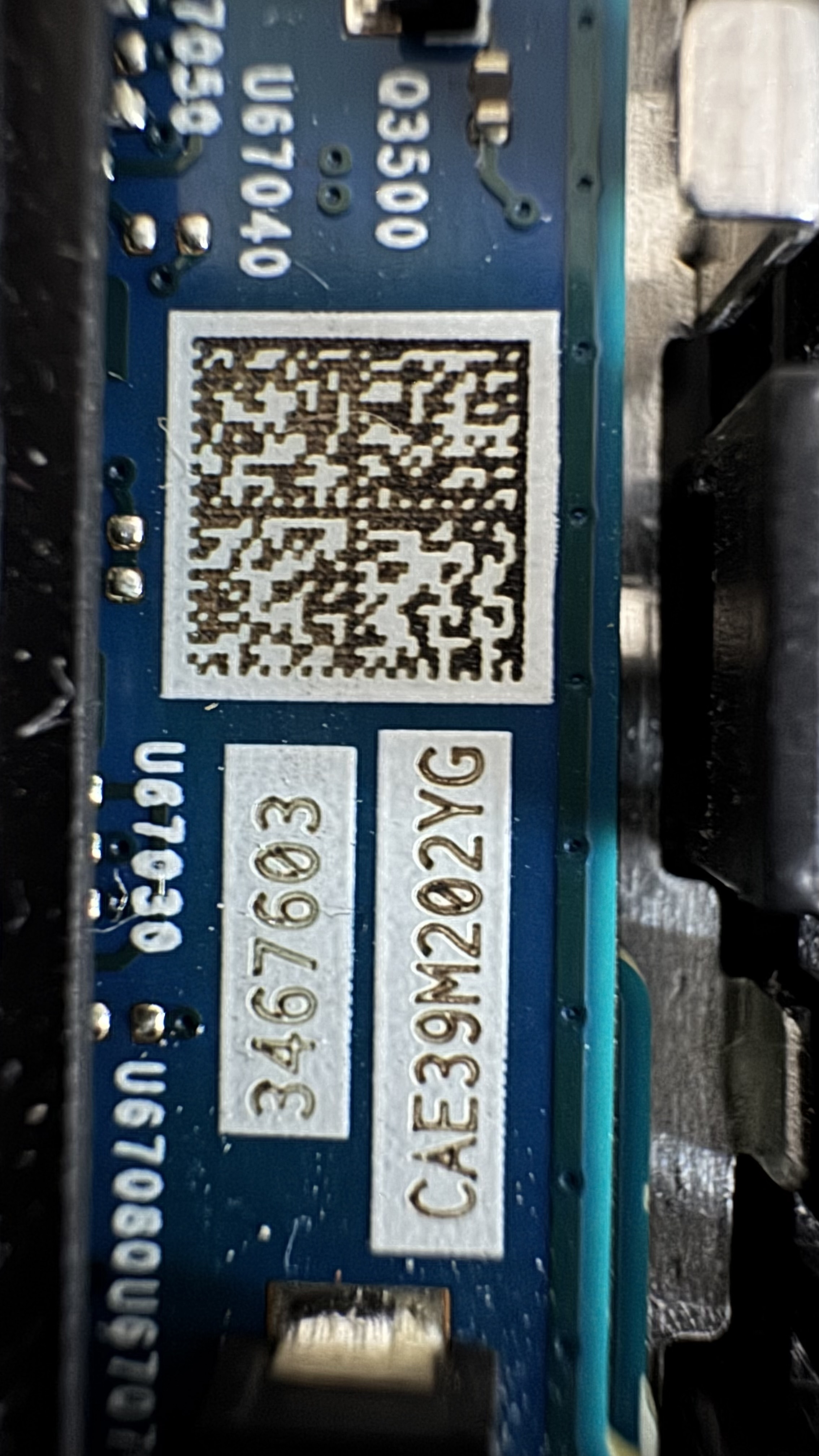

                    Scan the QR code on the motherboard and post what it says. If you can`t scan it post a good clear picture instead.
                    • Tondo27
                      • Aug 2024
                      • 21
                      • slovakia
                      I am attaching a photo of the motherboard. QR code
