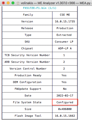

    Originally posted by tech_guru
    I found a dump for FX517ZE (attached). Laptop turns on and bios gets updated normally, but once the system boots and the nvidia driver gets installed, the laptop hangs and fans spin so I guess it only needs to clean the ME. Because also the ME analyzer says it has configuration so it's dirty. Can you clean it or show me a guide please? It is 16.0.15.1735.
    Thank you.
    your file has a clean ME ...
Name:	Screen Shot 2025-06-25 at 12.45.34.png
      Oh, then what does the bios need. I feel pretty sure it's the bios issue. Does it need to have all the dmi data from the original maybe?
        hoaca388 file should work, if not it means you have a hardware issue.
          Send to you

            Originally posted by minhdigital
            Send to you
            It turns on with minhdigital bios, goes in windows, but NVIDIA error 43 in device manager. I have seen it again in Asus same story but could not find a way to fix it. Any idea how to solve it? Maybe bios needs some kind of special config? EC reflash? Although I have SVOD4, I did not find a config for this model in the software.
            Thank you for your effort!
