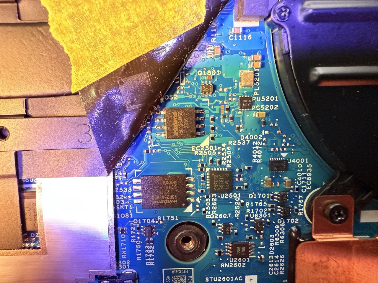

      Hello SMDflea,
      I tried to export it but the BIOS chip is a low profile smd and the Soic8 can not reach the pins.
      The chip is: WINBOND 25R256JWEQ
      2222
      6219
      M0047​
      Can i dump the BIOS with another way without desoldering the chip?
        https://vi.aliexpress.com/item/10050...8-be93c5fc5481

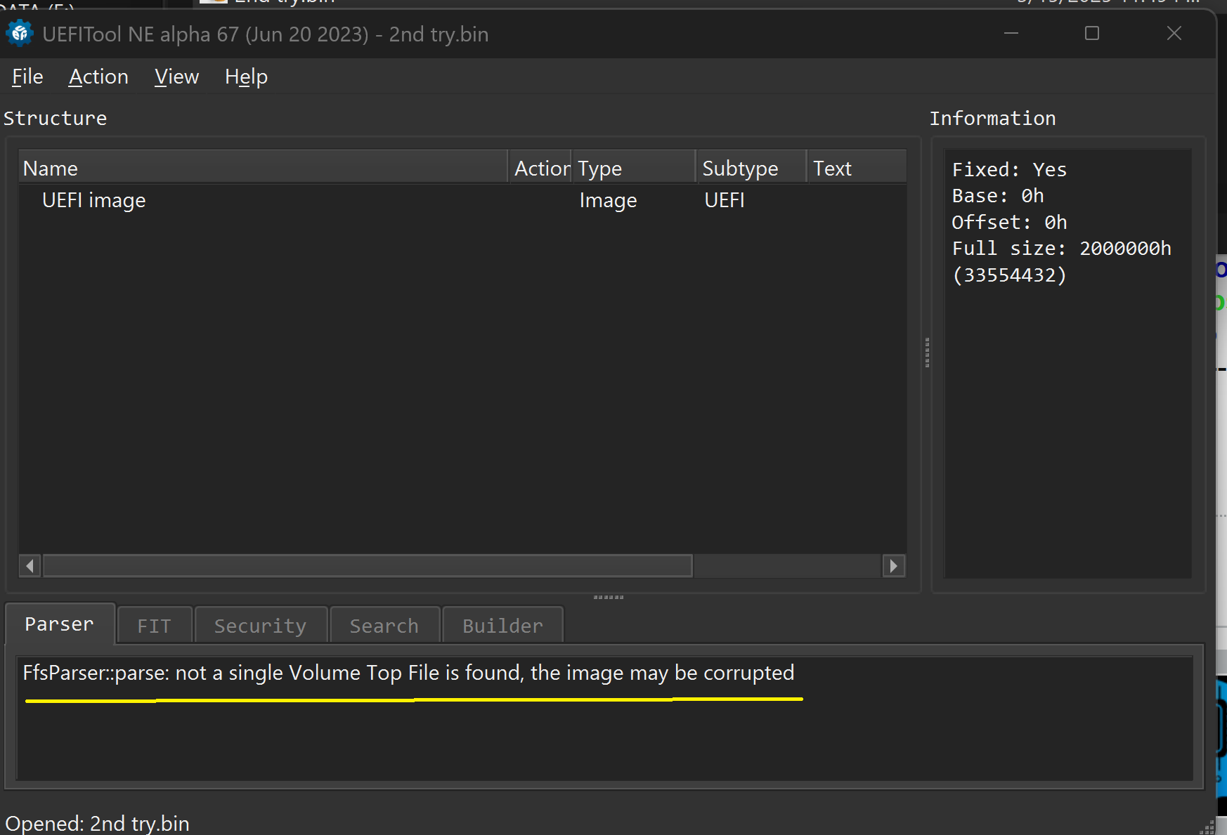

            Read chip again, file's corrupted.

              I have tried to capture the BIOS 3 times and every time the BIOS dump seems to be identical according to HxD.
              I have attached the examples.

                Discard the clip, remove the bios chip and read it.

                      It seems I was trying to read the wrong chip.
                      The correct chip was: W25Q128JNSQ
                      I have tried to use your OF_W25Q128JW1.8V@SOIC8.BIN file and the charging light turned on.
                      Afterwards the Escape, F1, F4 buttons were blinking continuously and the laptop could not be turned on.
                      I have attached the original W25Q128JNSQ dump in case anyone can help me since I do not know how to proceed.

                                      How did you flash the 25R256JWEQ​?
                                      Have you desoldered it or did you use a Sop8 wson clip?
                                      • Alegoff
                                        • Oct 2023
                                        • 10
                                        • Ukraine
                                        Desoldered with a hot air station
                                        I don't recommend using a Clip when there is more than one flash.
