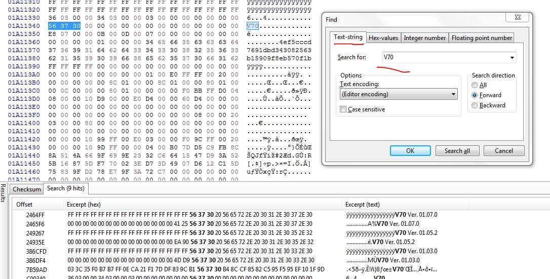

Check your bios with a hex editor to see if the BID is V70 ,if it is you can use the bios posted by rex98 further up https://www.badcaps.net/forum/troubl...15#post3585615Comment
Hi, how do I check BID v#
I looked over hex editor but could not find it easy?

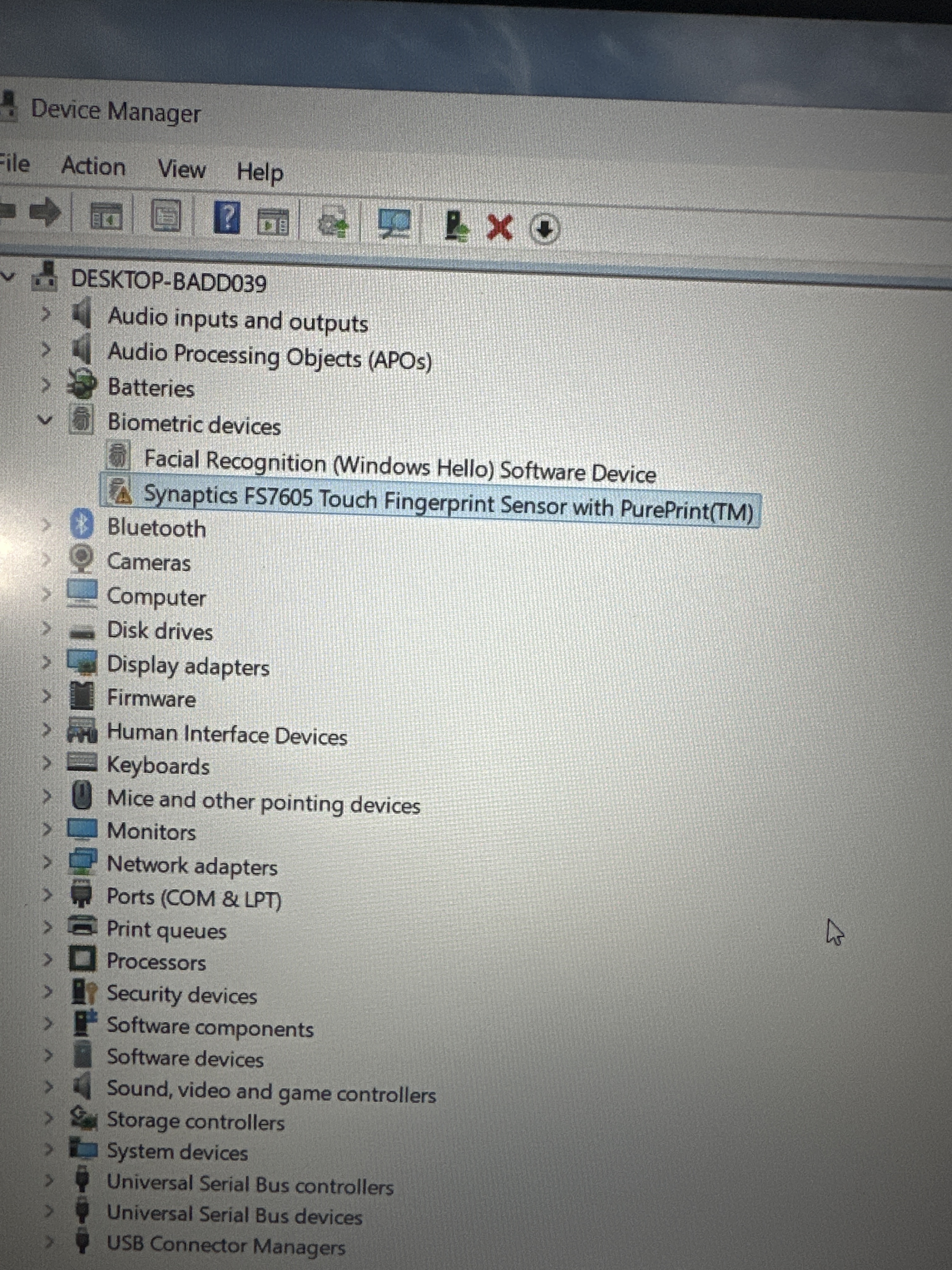

I end up using windows uuid for SMBIOS without the "-" and it worked, new issue, hp 860 G10 fingerprint scanner shows issue with device/driver after bios flash from post #27, i redid windows , drivers from hp site , did whole hp recovery image thing, no luck, im sure cable for fingerprint plugged and it was working 100% before the bios flash, possible bios chip has unique data about biometric fingerprint scanner? and any fix for that?
