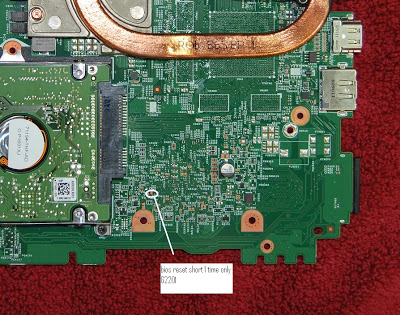

    Reset Dell 15R-N5110 Bios
    1. remove motherboard from you laptop.
    2. connect power and turn on.
    3. short G2201 only one time.its shout down.
    4. remove power and assemble your laptop again
    5. Then go to bios by press F2.
    note: This instructions for help only and for professionals only. general users do not try this.
    Don't short G2201 two times or in even count.it will show you password prompt again.

      Short g point indicat un pictcher

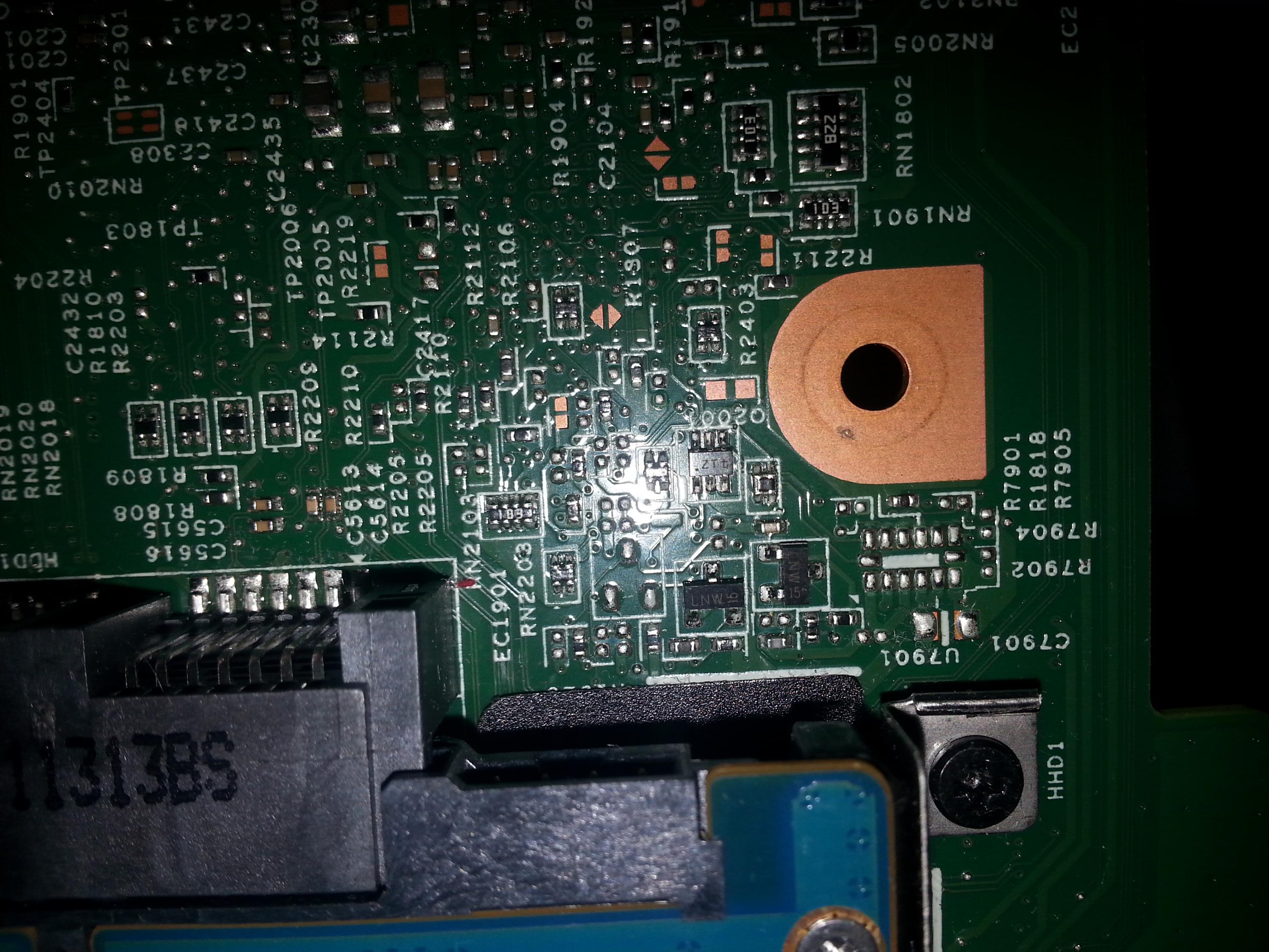

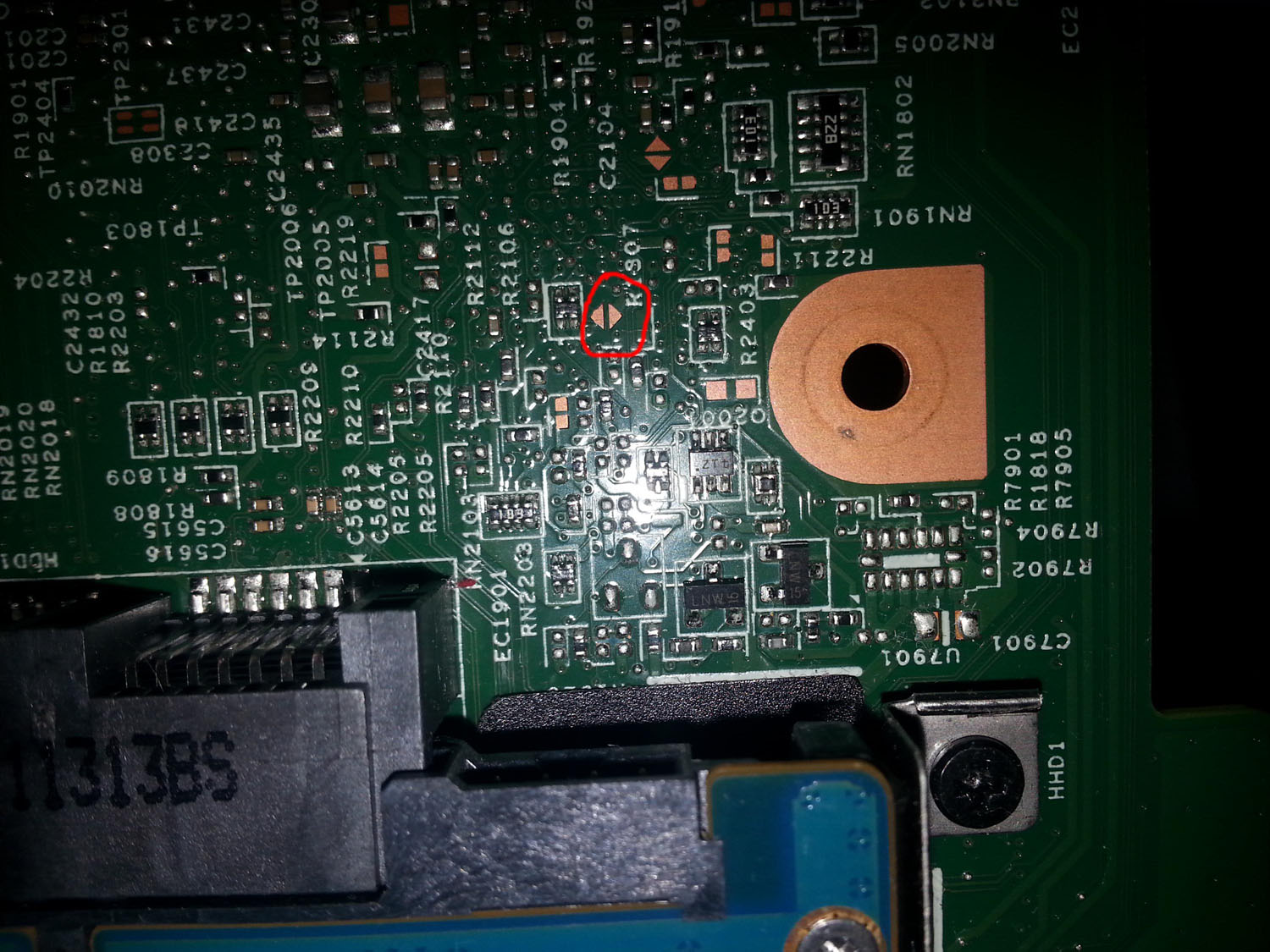

          this method worked for me. but i did something hes not mentioned.
          01.remove the RTC battery
          02.plugged in Ac adapter and power on
          03.Short those small rectangle pads for single time
          04. turn off
          05. then re-assemble everything with new RTC battery and its working without that annoying password.

            hello kandyan
            I see two pairs of rectangle pads, what pair are you talking about
            the pair pointing up and down or the pair pointing left to right

              Re: Reset Dell N5110 Bios password
              he is saying these pads.

                  exactly..those are the pads for clearing pw and its clearly mentioned in schematics.
