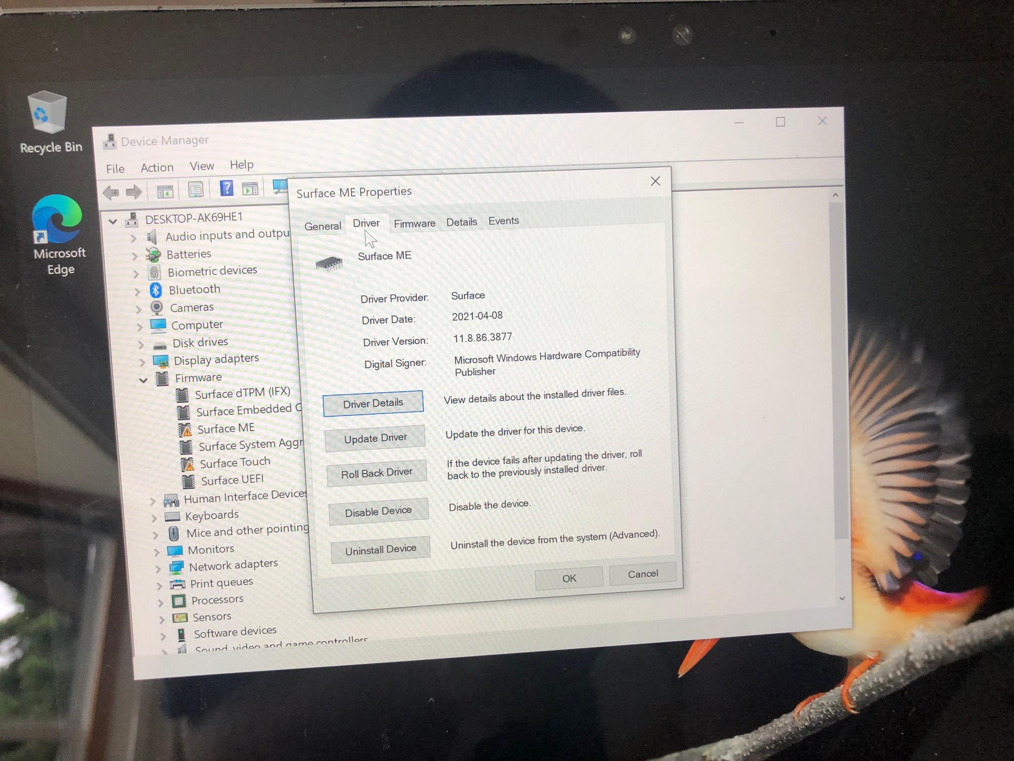

    i tried the last 3 days to repair my surface pro 4 because my touch is not working.
    I think i tried all the different possibilities from here. Thanks to all of you.
    I have a few last questions.
    1. Is it possible to repair the touch with special bios ?
    2. How can i get my own bios ?
    3. I dont find my ime 11.0.11.1006 to download, only for money.
    4. I put all edited bios on a bootable usb stick and start it, something happend but the problem is the same, no working touch.
    I will very thankful for an answer.
    Excuse me for my bad english. (60+)
    Surface pro 4 i5 8GB 256 GB.

    Is the laptop bootable into windows,have you tried installing any updates.

      Re: repair my surface pro 4 because my touch is not working
      thanks for your fast repond.
      Yes its bootable into winows. All updates are installed. It works fine but without touch

        Re: MS Surface no touchscreen after cleaning ME Firmware **FIX**
        after a looong search i think i found the right bin file and i modified it for my surface pro 4.
        I take it on a bootable usb stick and run it.
        My touch still not working. What do i wrong !?
        Anyone an idea.
          Anyone an idea.
          Post your original unmodified backup
            Hello SMDflea,
            thanks for your answer.
            I have no oriinal bios. I dont now how to get it. Need i a spi prorammer ? Is an USB programmer possible?
            i tried it with fptw64 at cmd. But it failed.
            At my uefi IMe is 11.0.11.1006. I found a similar bios and i modified it like here discribed.
            Now the bios looks like the picture in an other post. But if i use it at a bootable Stick something installed (change). But the touch not working
            Maybe its a Hardware mistake. Then i stop my and your efforts.

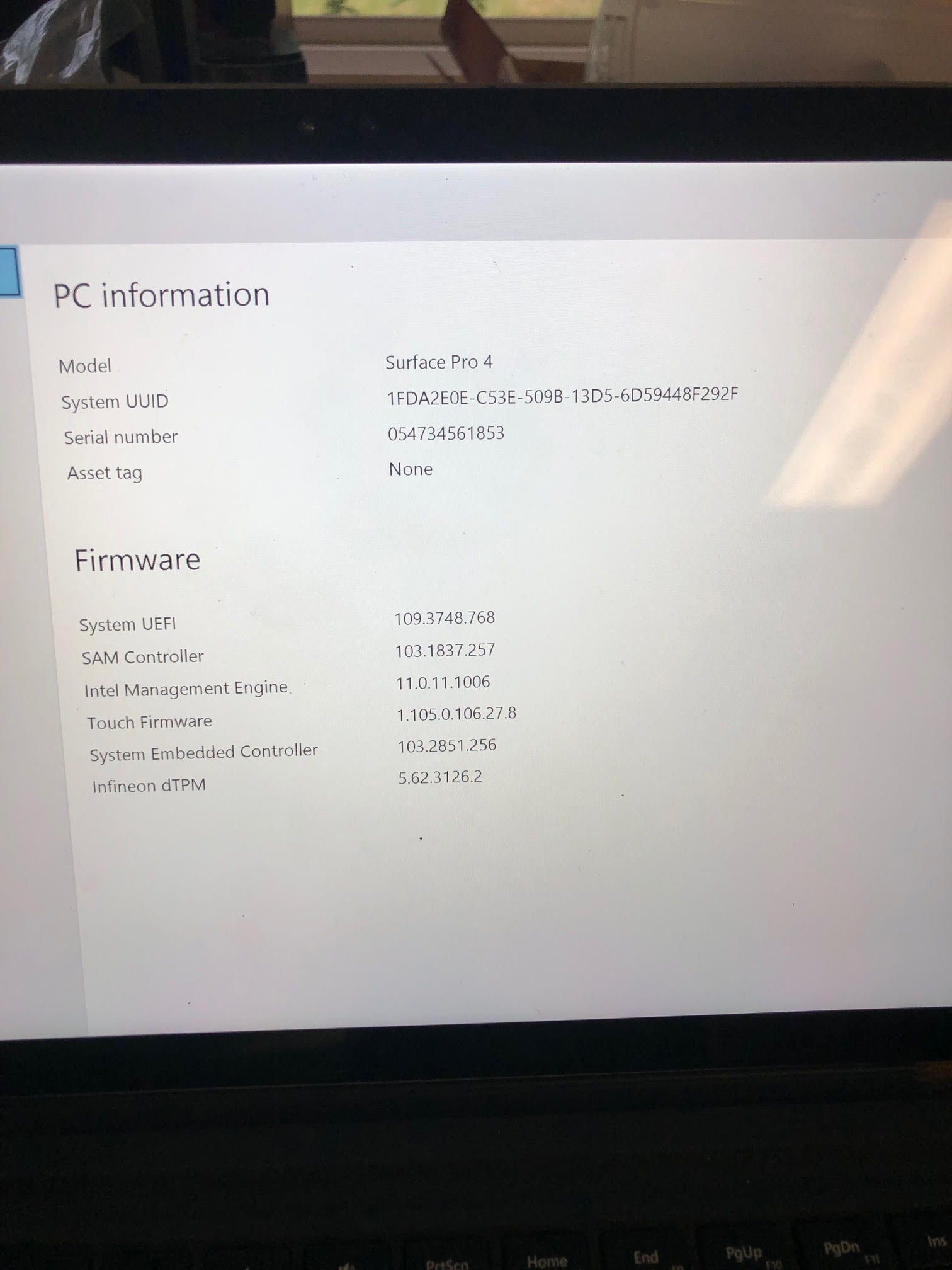

            Firmware
            System uefi 109.3748.768
            SAM Controller 103.1837.257
            Intel Management Engine 11.0.11.1006
            Touch Firmware 1.51.149.106.104.36
            System Embedded Controller 103.2851.256
            Infineon dTPM 5.62.31262

                I have that same problem. The original bios was damaged during the update. Surface ME device cannot start and update. I can't open bios file with FIT.

                  Originally posted by SMDFlea

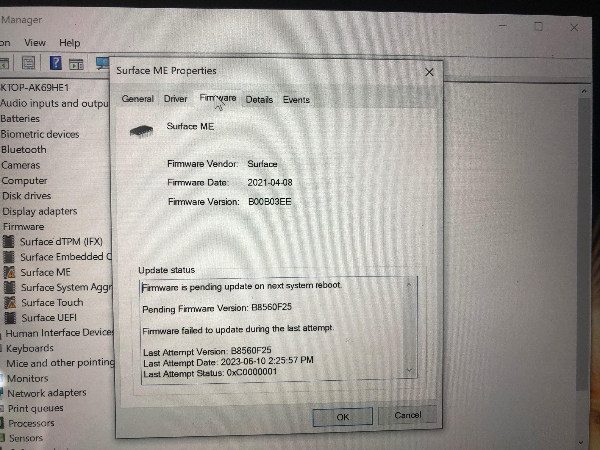

                  Only with an SPI programmer.
                  I used my serial programmer and I have BIOS, but its saying it doesn't not contain contain Intel Engine Firmware. Nor ISHC.
                  Any suggestion what I need to do with this BIOS. Serial Number are correct.
                  Thank you
                  It is winbond 25Q128 Flash Contain
                    Thank you
                    Try this one.
                    And if it doesn`t work:
                    https://www.badcaps.net/forum/showthread.php?t=104153
                    *You should install the latest updates from microsoft,including the driver packs before assuming there is a hardware problem.* - See Post #2
                    EDIT: If nothing else works try this fix - https://www.badcaps.net/forum/showpo...8&postcount=40

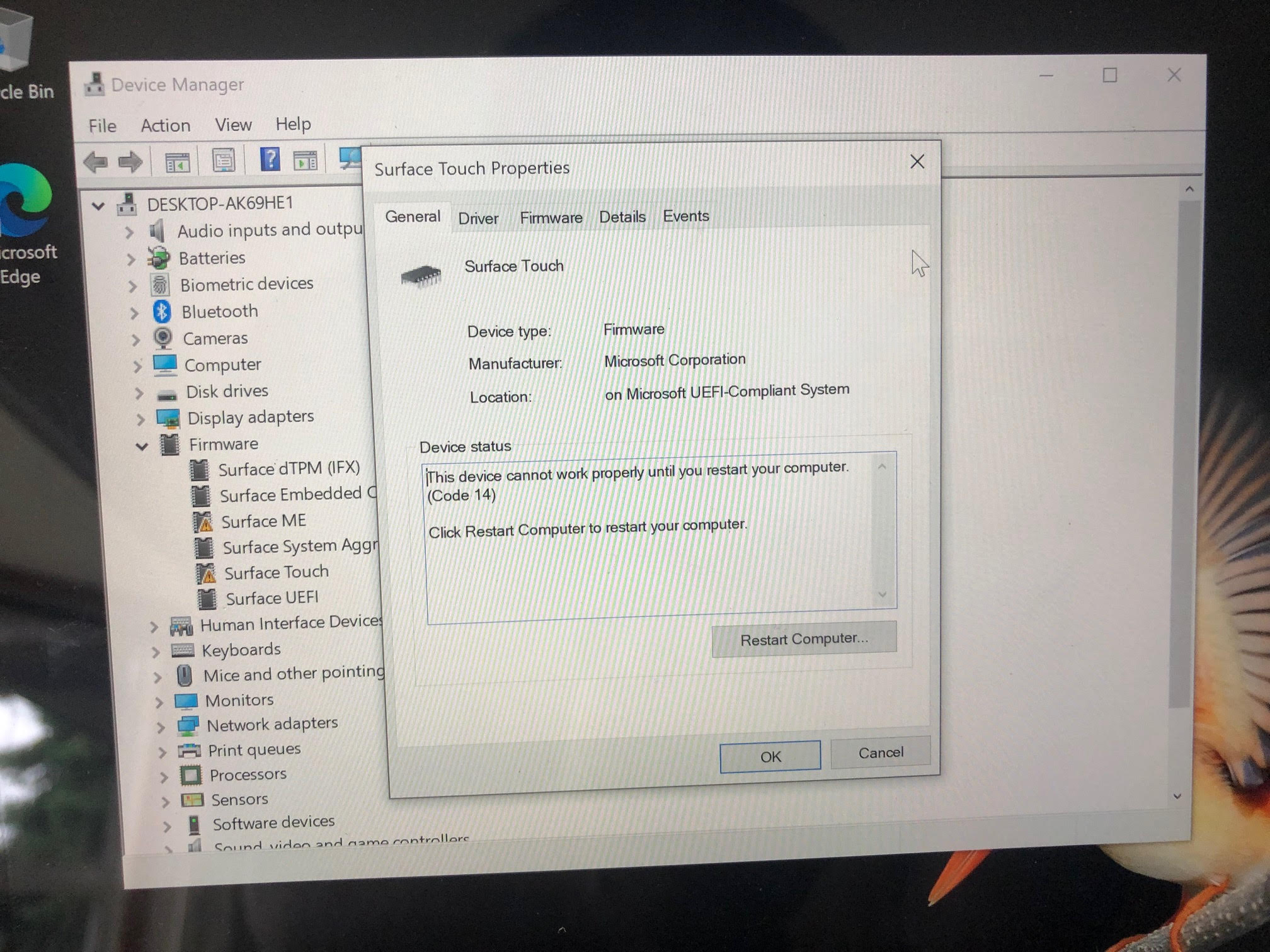

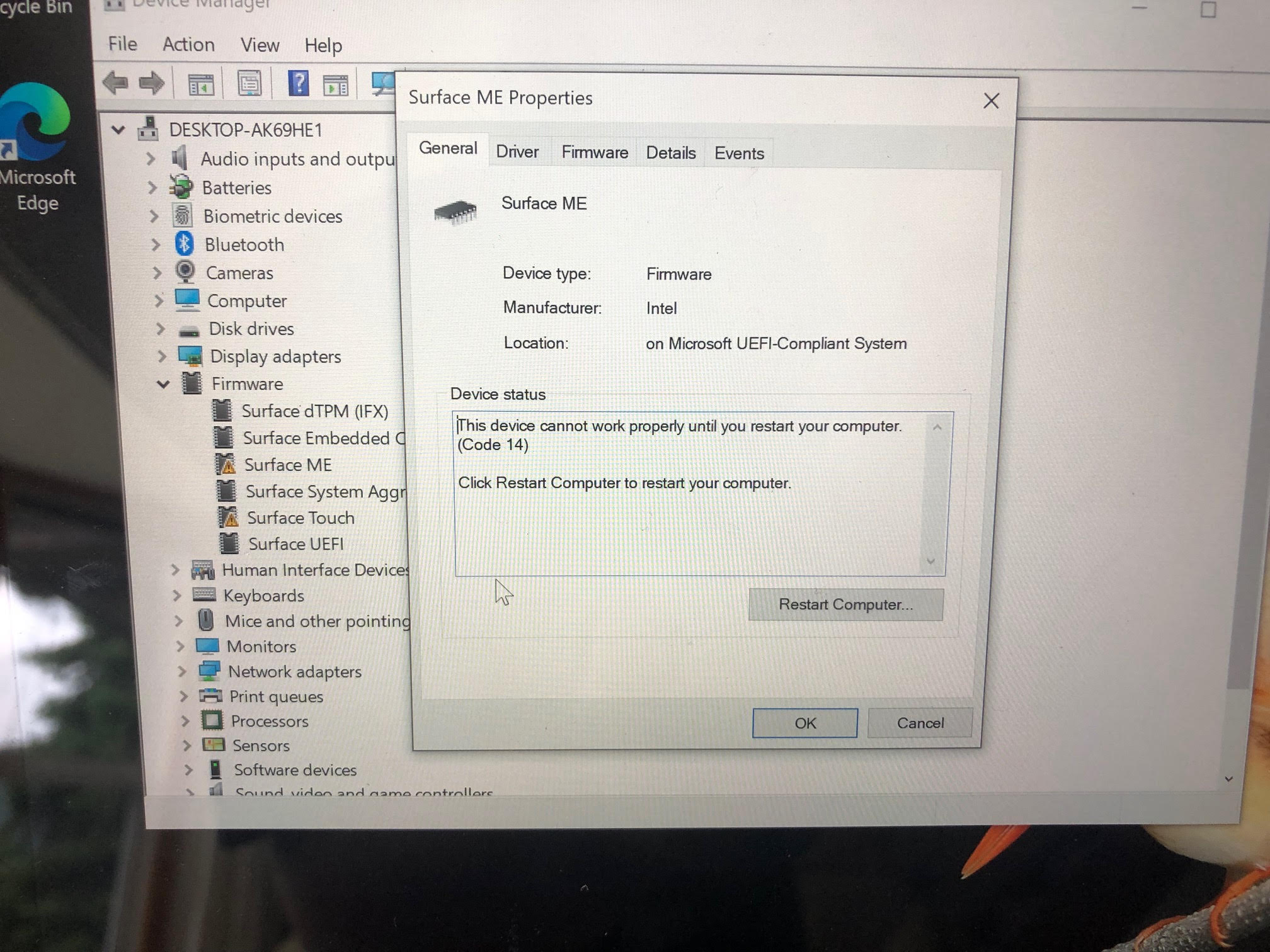

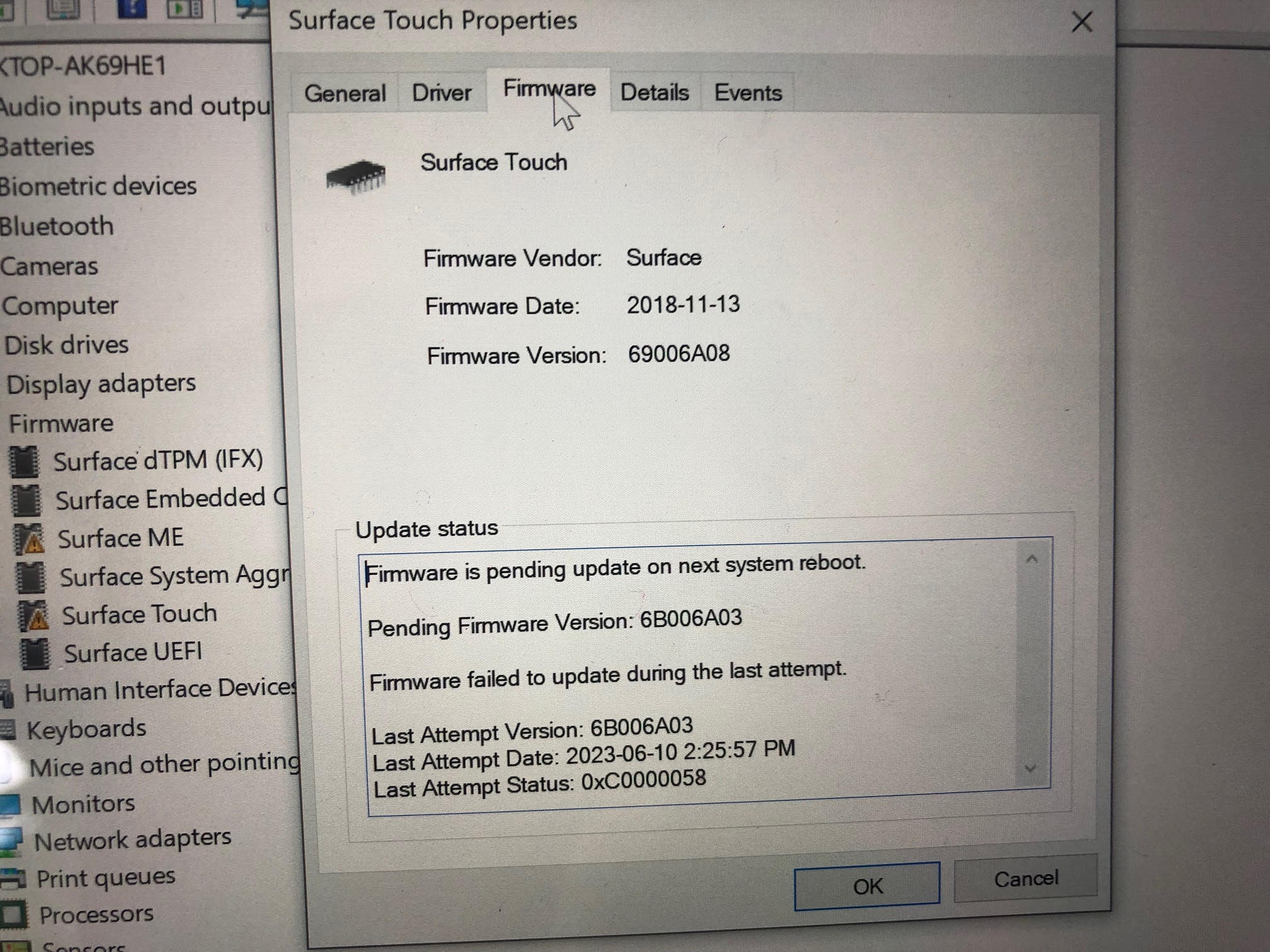

                        I did it, I program BIOS, all good except touch, I Restore, update, no touch and only still Failed Update on ME, needs to restart and it is same after restart and for Touch same, need restart and after restart its need restart. See pictures. If I can program directly the fw I would do it, but looks like there is no way. Maybe MS doing this to increase sell for new tablets...
