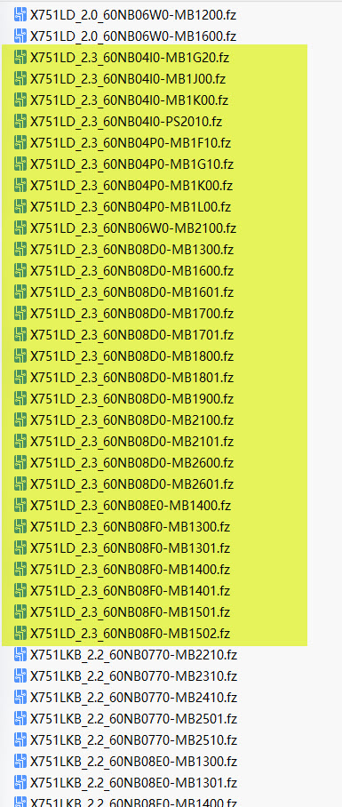

            • mon2
              • Dec 2019
              • 14659
              Re: Short circuit on soldered RAM on PC Asus X751L
              See attached - which one is yours ?
              • totof
                • Feb 2017
                • 169
                • france
                It's X751LD_2.3_60NB08D0_MB1600
                  Attached,
                    Thank you mon2.
                    I have moved R2145 to R2144 (for PCB_ID0 signal) and R2153 to R2146 (for PCB_ID1 signal) to disable onboard RAM but unfortunately it does not change nothing.
                    To be continued ...
