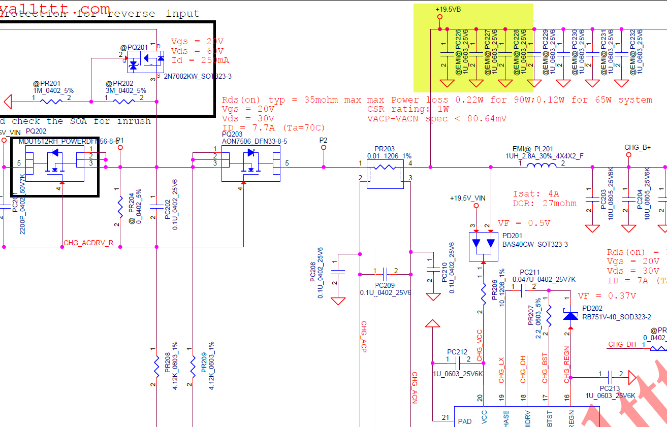

Hp 15 la-d707p not power on .

    Re: Hp 15 la-d707p not power on .
    Sorry to be late.
    Yes there's no short to GND , so a leaky component is most likely
    Test of all coils with Diode mode / Resistance mode :
    PR 203 = 0.433v /
    Pl8 = 0.508v / not stable start from 10.70mohm than decrease
    Pl9 = 0.345v / not stable start from 540.1 kohm than decrease
    Pl11 = 0.234v / 330 ohm
    Plv2 = 0.014v / 10 ohm
    Plv3 = 0.014v / 13.5 ohm
    Plw1 = 0.097v / 72 ohm
    Pl 15 = 0.408v / 29.43 ohm
    Pl 602 = 0.089v / 46.6 ohm
    Pl 1206 = 0.026v / 18.4 ohm
    Pl 1203 = 0.010v / 9.9 ohm
    Pl 1205 =0.012v / 11.4 ohm
    ACN (1) / ACP (2) reach the current sense resistor = yes
      Remove all power -> meter in resistance mode -> measure the resistance to ground of +19.5VB.
      What is the measurement?
        6.812 mohm ...b ut not stable it decrease
          That is a very high resistance.
          Can you post a picture of your meter with the scale being used for the resistance measurements?
          When you short the meter probes, do you see ~0 ohms on the meter?
            the scale is automatic , short the meter probes 000.7 ohm.
            maybe i must focus more at all jumpers !!..something is blocking pu201 to accomplish his rule..
              Can you confirm the following ?
              1) If you remove pq203 and apply a DC power supply onto the main power rail - the logic board works fine ? You also see the ~24v on the ACDRV pin of the charger IC ? (after you remove PQ203)
              2) if yes, replace pq203 (even though the readings are good with the meter) and test again.
              3) if the fault remains, replace the charger IC and test again.
              It is the charger IC that is responsible to drive the ACDRV pin and respectively, creates the boosted gate voltage. Also monitors the current draw on the local rails (main & battery charge) to enable / disable ACDRV.
              It is vital to inspect that the current sense circuit is operational and all parts are present to the charger IC. After this review, consider to replace the charger IC and test again.
              Update this thread as your proceed.
                Try replacing PC208/209/210 with exact same value.
                Did you acted on this??
