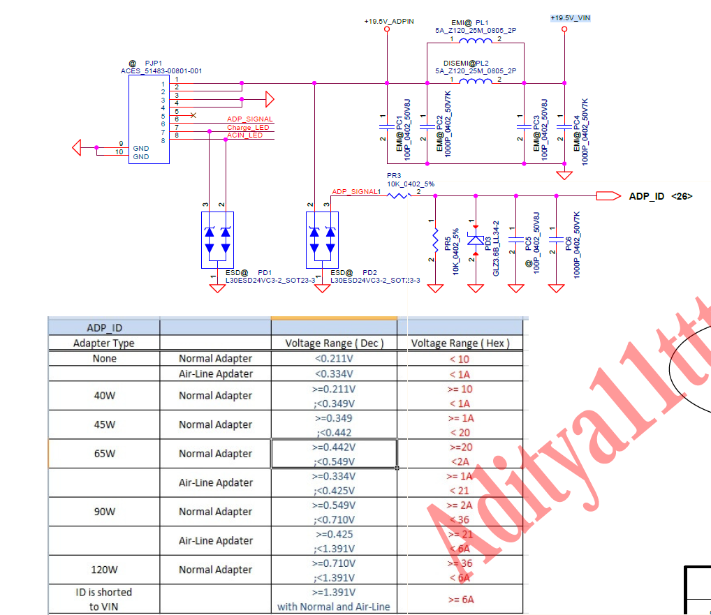

    Hello friends .
    I've got this lap la-d707p motherboard (With GPU) that is not starting. I have no power/charging LED on the connector when plugging the power charger.
    I tested PQ202 and PQ203 the first 2 mosfet but i got only 19v at the drain of PQ202...
    no short to GND at all coils , pq202 / pq 203 are not shorted.
    Consumption is 0 amp. Gate of PQ 202 = 0v
    BQ2472A requirements :
    pin 20 vcc = 19v ok
    pin 6 acdet =2.6v ok
    pin 16 regn = 6v ok
    pin 5 acok = 0v !! must be 3v
    no 3vl at pr214 , no 3vl at pu2.
    Troubleshooting :
    i desolder pq203 , i got 24v at gate of pq202 , inject 19v at the pq203 ( non soldered) i got my 3vl ; acok = 3v...power on the lab work .
    i changed pq 203 still same behaviour...what i must verify too !
    thank you

    Re: Hp 15 la-d707p not power on .
    Remove all power. Measure the resistance across the same 2x DCin mosfets.
    Review the other threads here for more details.
    Post the measurements of each mosfet check.
      Thank you mon2.
      PQ 202 :
      Source/drain = 17.84mohm
      Gate /source = 10.76mohm
      Gate/drain = 18.87mohm
        Resistance is fine on the mosfets.
        1) What is the voltage of BTST pin # 17 (PU201) ?
        2) Confirm the resistance on PR209 (~4k).
        3) Confirm that PR209 is connected to the source pins (1-2-3) of PQ203 and also connected to pin # 3 (PU201). This feedback pin (CMSRC) is important.
        4) What is the voltage of CMSRC pin # 3 ?
        5) If ACDRV is turned off, there may be a violation of one of the conditions for this charger IC. Confirm that the current sense leg of the circuit is working properly.
        Measure the resistance from each side of the current sense resistor back to the charger IC. The traces must not be damaged or missing.
        6) As a quick test, remove PR208 (4k resistor). Power up again.
        What is the voltage of ACDRV at the pin # 4 (PU201) ?
          Ok
          pin 17 = BTST = 5.93v
          PR209 = 4.11kohm
          PR209 connectevity is confirmed.
          pin 3 = CMSRC = 3.8mv
          the current sense continiuty with pin 1/2 of pu 201 is ok.
          PR208 = 4.11kohm...removed = not power on.
          Pin 4 = ACDRV = 0v.
          a violation of one of the conditions for this charger IC...i think yes because 3vl who supply acok is missing
            The pull-up voltage of +3VL is only on after the 2 x DCin mosfets are enabled (CLR) = +19.5VB
            Is mosfet @ PQ201 stuffed on your logic board ? If yes, remove it for testing.

                                What is the voltage of ADP_ID ?
                                      Yes i verify this from first and nothing unusual.
                                      pin 75= 0.655v
                                      as i said before , when charger plug in there's consumption but soon return to 0 amp...so i think that there's a leacky mosfet/capacator somewher...tht's complicates my research.
