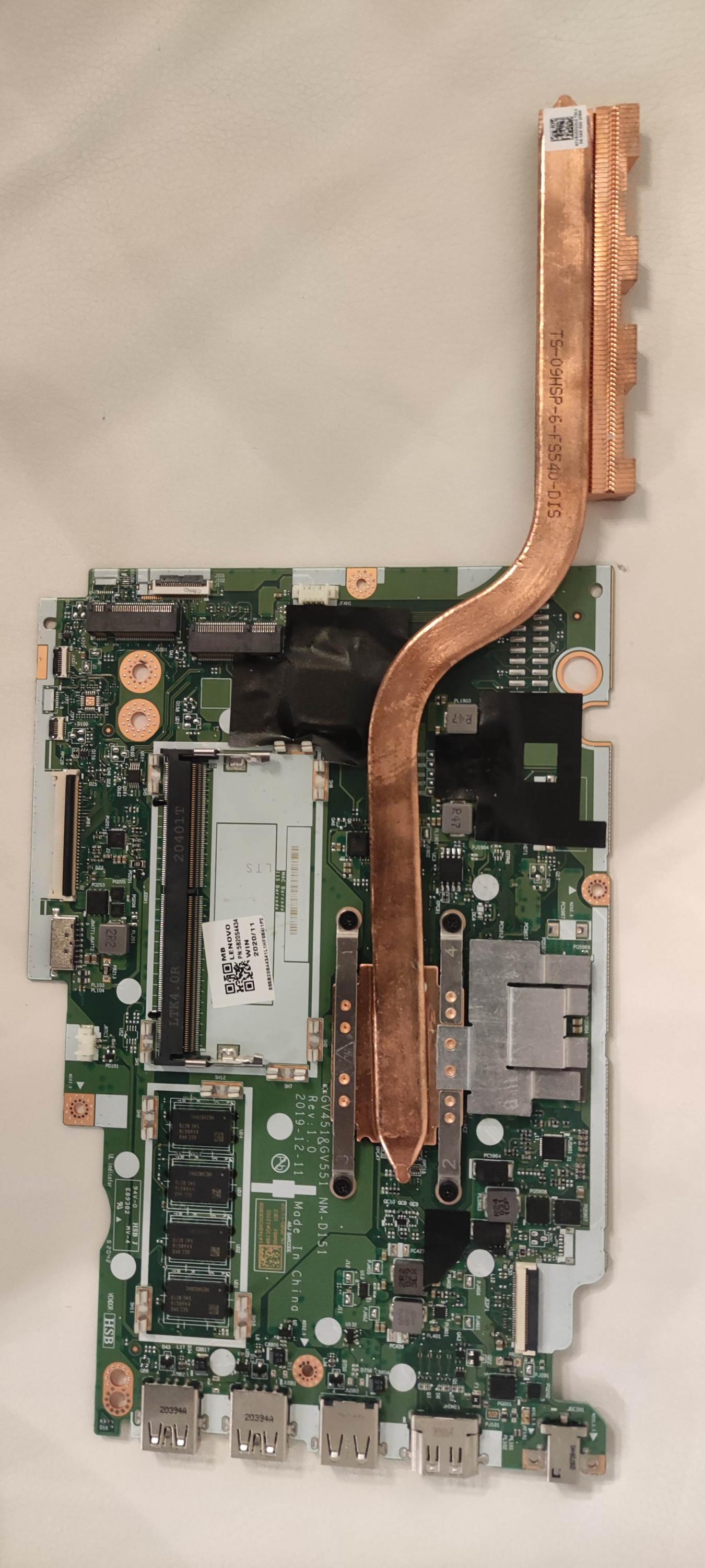

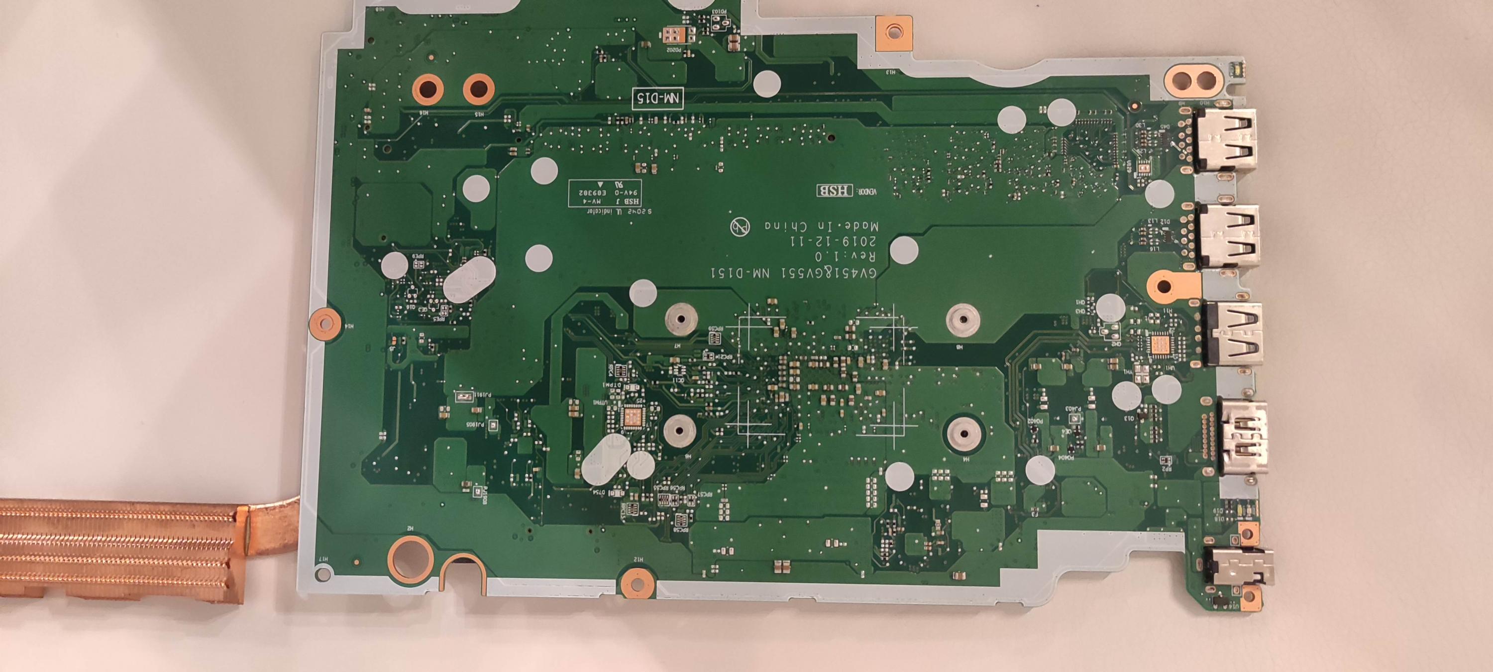

    Hi, I have this laptop that acts strange. If I try powering on, the power led, the numeric keypad light and the fans will turn on but the screen has no image. The fuse F2 near the lcd connector is blown, I tried to replace it with some similar fuses (1A) but it keeps blowing. I tested these mosfets with multimeter:
    PQ201 drain 20v source 20v, gate 26v
    PQ202 drain 20v source 20v, gate 26v
    PQ5907 drain 20v, source and gate 0v (both shorted to ground too)
    PQ5908 drain 0v shorted, source 0v shorted and gate 0v (connected to pin 33 of PU5901)
    a lot of capacitors behind the cpu are shorted. thermal cam shows heat on the cpu shield
    maybe the problem is in the backlight circuit? too bad I cannot find schemathics for this laptop.
    any hint?

    First i would give resistance to ground on all coils put it and the current sensor on the picture. So that somebody can look at it and help you how to further investigate. My gues it will be 3,3 v is shorted or and mosfet on vcore maybe.

      sorry I'm trying to learn. with coil you mean, for example, PL401 and PL402?if yes, with multimeter in resistance mode:
      PL401 open circuit on both sides
      PL402 open circuit on both sides
      PL5903 8,4 ohm on both sides
      PR201 open circuit on both sides

        So no short on the currentsensor to ground . Did you check the first second mosfet for internal short. If the are good i would look into the charger circuit the acdrive pin is the one that controls the mosfets.

          multimeter in diode mode
          no short on PQ202 (I only find short for a few seconds between source and drain after I check between gate and drain..is it normal behaviour?)
          no short on PQ201
          source (1 2 3) is shorted to ground in PQ5907..is this mosfet is connected to F2 fuse that keeps blowing?
          I found other coils and mosfets under the cpu shield:
          resistance mode
          PL5901 and PL5902 around 80 ohm to gnd both sides
          PQ5901 to PQ5906 I can check if it's needed.
          acdrive pin... where can I find it?

            I can not open boardview . Fuse blows so you must have a short can you give close up picture from the area. Fuse can only blow if you have a short.

              No point probing the charging circuit here. Measure resistance on both pads of blown fuse after removing the fuse. One side is definitely shorted. Then you need to inject voltage on the shorted side of fuse. Voltage should'nt be more then 1V.
              Resistance measurements should be done twice
              01.With edp cable inserted
              02.Without edp cable.
              No power should be attached to the board while checking resistance.
