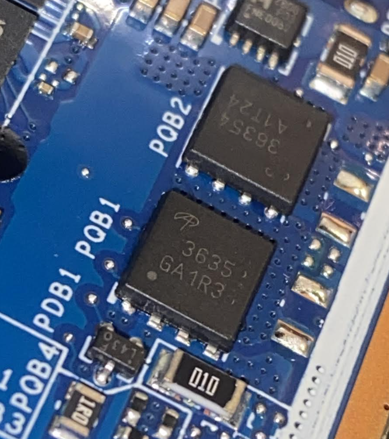

    I've had a Lenovo Ideapad 5 14ITL05 for a few years now, with motherboard LA-K321P. I would never leave it plugged in unless I was using it, and always turned it off after I was done, but last week the laptop just wouldn't start upon plugging it in. I tried following a previous post on here, but due to my lack of knowledge in the subject, I am lost as where to look next.
    I began by removing the back cover and exposing the internal components. I wanted to see if my PQB1, PQB2, and PQB13 MOSFETs were working properly, as suggested in the aforementioned post, as they handle providing voltage to the board from the USB bus. I recorded the following resistances between the sources, drains, and gates for each component:

    1. How are the pins laid out for these components? I assumed that, starting from Pin 1, they would increment upwards counterclockwise. Meaning they would go 1, 2, 3, 4 descending on the left side, then 5, 6, 7, 8 ascending on the right side. Is this correct? I wasn't able to find a layout for these two MOSFETs (3635? GA1R3? for PQB1 and 36354 A1T24 for PQB2)

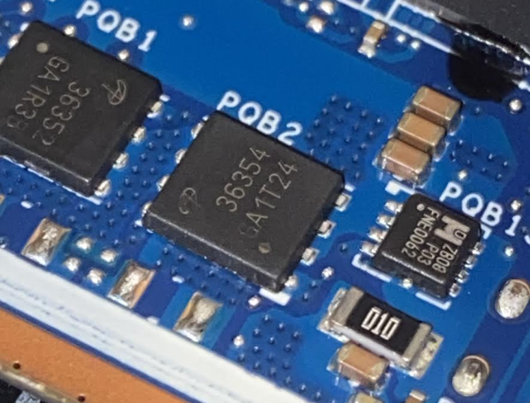

    2. Are the pins in the below pictures properly soldered? To my eye, it looks as if one pin on each component isn't connected to the board, as the solder seems to bubble up on the tip.

        Hi mon2, thank you for your quick response! I received the needle-point multimeter probes and revised my measurements. It seems like PQB2 source to drain is still extremely low, hovering at ~2 kΩ.

        Hi mcplslg123, thank you for your comments. I checked the diode voltage across pins 1 and 6, which according to the schematic are G1 and G2, respectively. There is no mention of pin 8.
        The readings I received are as follows:
        PQB1 PQB2
        G1-G2 (1-6) 1.152 V 1.173 V
        G2-G1 (6-1) 0.0 V 0.0 V
        Does this mean that PQB2 is defective, considering its source-to-gate and drain-to-gate resistances are extremely low? What are the next steps? I cannot find this exact part online.

          To mee,the mosfets dont appear defective. You are yet to share the voltage on all pins of PQB1/PQB2.Only adapter connected.
