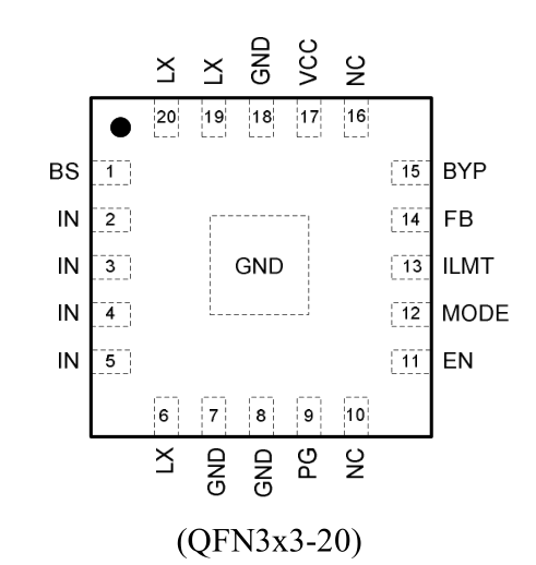

    Hi all, I am working on Hp 15-ca2003ca (MB DAG7BDMB8F0 REV:F). The problem was totally dead. Upon diagnostics, there was a burnt SY8286BRAC. I replaced it with another one. Now the WHITE LED on the DC-in jack glows & when the main battery is installed, the status of the LED changes to Orange. But when I press ON/OFF button, I see the power LED glows for a sec & then shuts off. Same happens when I press the ON/OFF button over again. I just put the Meter leads on the 3.3/5V coils & the meter shows that these both volts are generated & then in a sec. goes away. I re-programmed the BIOS too, no luck. There does not seem to be any short on the motherboard. Any repair tips will be greatly appreciated. Thanks in advance

            Please don't randomly reflow SoC. Do you have proper output (3.3V) on pin 17 of the changed SY8286BRAC? Also post resistance to ground on that rail (+3VPCU). Since you mentioned that this IC is overheating, that not necessarily means that the IC is damaged, but something is overloading it, which could be a short or low resistance on the +3VPCU line.
            Perhaps this leads to nowhere, but it's worth checking before reflowing or doing something that extreme.
            Here is picture of the IC pinout to avoid losing time searching for pin 17.

                Thanks for the help "DanielDacko" & "mcplslg123"., The voltage on Pin 17 of chip SY8286BRAC is 3.3v which seems to be right. Yes I was not going to do the re-flow UNLESS & UNTIL very nesessary, because when I removed the 1.8V coil, still the chip SY8286BRAC was turning hot when the motherboard was turned ON for a while, assuming that before the SoC some other component might be shorted. The resistence from GND to both the coils 3.3v is 4.2Kohms & the 5V coils is 11.52Kohms respectively. It's looks like the resistence is not right on the 3.3V rail. Beside this nothing is getting hot. If I inject continous 3.3V, where should I attach hot wire to? As before I mentioned that near the audio chip ALC3258, 4 tiny ceramic caps (assuming 10u 6.3V) are showing shorted. Removed all 4 of them but that rail still shows shorted. I think the rail is of +5V_AVDD & +1.8V_AVDD. Since no boardview & no marking of any component on the motherboard, cannot confirm this.
