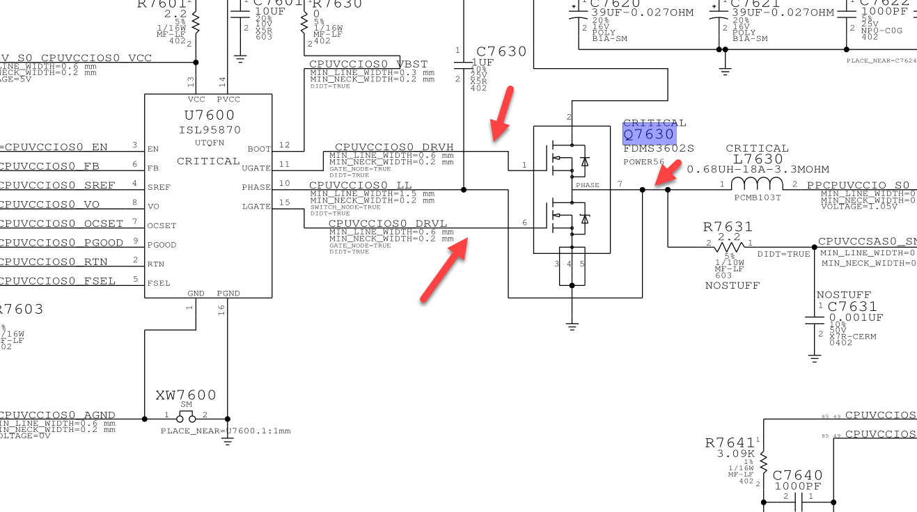

            #65
            Re: Macbook 820-3115 missing 3V42_G3H
            hi. no, leave the mosfets off. only interested now to resolve the short that is on the consumer side (downstream) that is connecting to fuse F7040, pin # 2.
            Consider the following process:
            1) leave F7040 off. confirm that F7040, pin #2 has a low resistance to ground.
            2) see attached for the fanout of the PPBUS_G3H power rail for this logic board.
            3) Remove the backlight as the guilty party by reviewing the fuse on PPBUS_S0_LCDBKLT (F9700). Suggest that you remove but solder one leg on the pad so that you do not lose the fuse - just our method. Just be careful the fuse does not short against any other part or trace.
            Now check the resistance to ground of PPBUS_G3H - still low ? Continue...
            4) Remove all power. Inspect the mosfet linked to the CPU power rail @ Q7630. This is a DUAL mosfet inside a single package.
            Meter in resistance mode.
            Check the resistance across the mosfet legs of:
            2 & 7
            1 & 7
            1 & 2
            and the other internal mosfet
            7 & 3,4,5 (pick any pin since they are shared)
            7 & 6
            6 & 3,4,5
            Record each resistance reading and post them here along with the scale used on your meter.
            If the resistance is a low value, the mosfet could be defective.
            We want to be sure the mosfet is not leaky for the CPU so that we can proceed to adjust the injection voltage and/or current settings.
            Repeat the same testing for Q7100.
            • Nuld_
              • Jun 2022
              • 64
              #66
              1) Yep still low
              3) Low aswell
              4)
              Q7630:
              2 & 7: 5,1 Ohms (Ohms)
              1 & 7: O.L (MOhms)
              1 & 2: 98,9kOhms (kOhms)
              7 & 3,4,5: 0,4Ohms (Ohms)
              7 & 6: 5,92MOhms (MOhms)
              6 & 3,4,5 5,92Mohms (MOhms)
              Q7100:
              2 & 7: 19,8 Ohms (Ohms)
              1 & 7: 97,6kOhms (kOhms)
              1 & 2: 97,6kOhms (kOhms)
              7 & 3,4,5: O.L (MOhms)
              7 & 6: O.L (MOhms)
              6 & 3,4,5 33,7Mohms (MOhms)

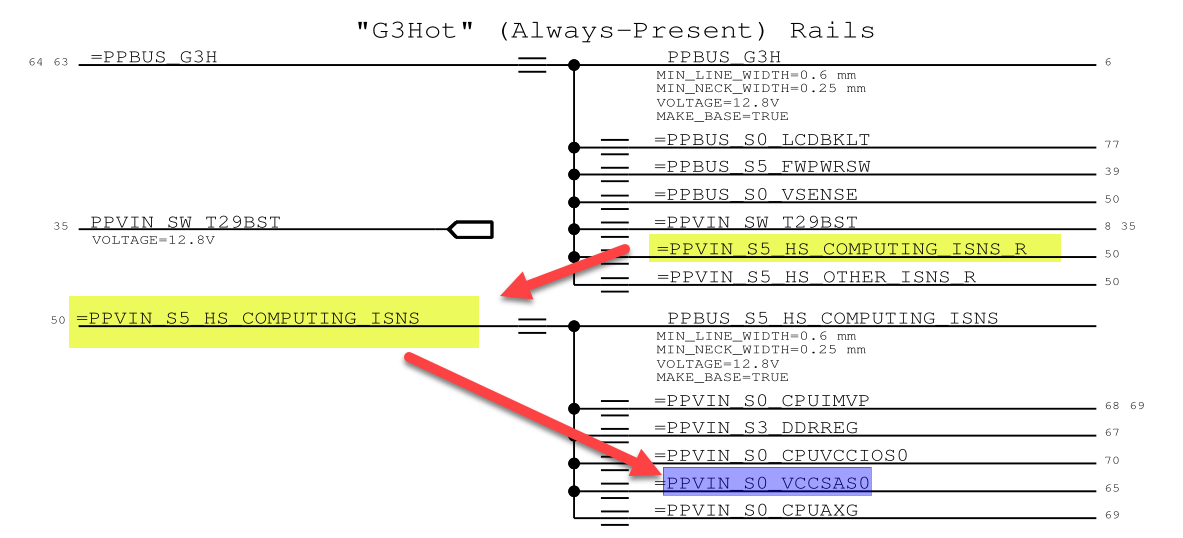

                    #69
                    Is there something else I should check for ?
                    • mon2
                      • Dec 2019
                      • 14668

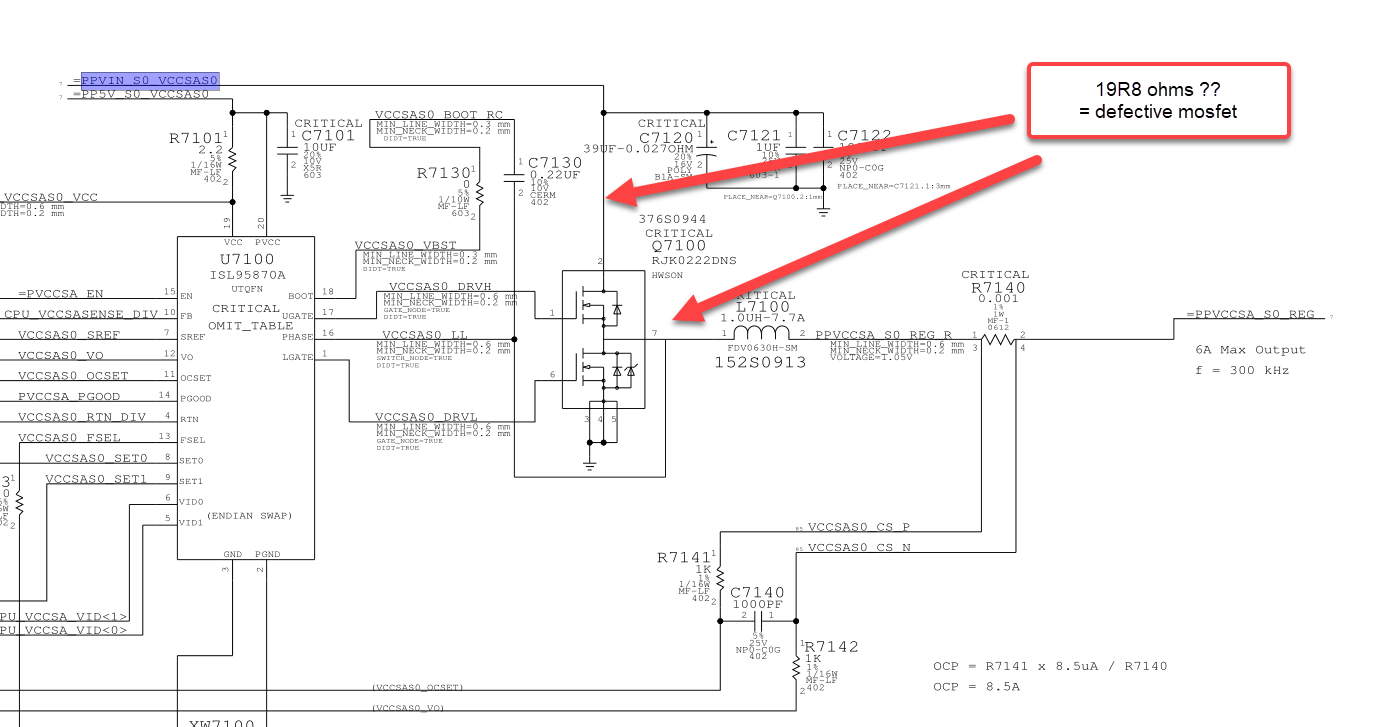

                      #70
                      See attached.
                      PPBUS_G3H powers many rails including PPVIN_S0_VCCSAS0.
                      The mosfets for each regulator must be working properly to regulate the local rail.
                      Based on the earlier post, Q7100 - pins 2 & 7 have a very low resistance. Can you confirm it is 19R8 (19.8 ohms) ??
                      This implies that the voltage from PPBUS_G3H (~12 volts) is likely to have travelled onto the PPVIN_S0_VCCSAS0 rail = CPU voltage. This will have harmed the CPU.
                      Remove Q7100 and check the resistance out of circuit of this dual mosfet. Make a note of the pin # 1 orientation before removal.
                      After Q7100 is removed, check the resistance to ground again of PPVIN_S0_VCCSAS0 (L7100, pin # 2). Is it still very low ?
                      Likely the CPU is dead but wait on the above details and others to comment.
                      • Nuld_
                        • Jun 2022
                        • 64
                        #71
                        It´s 22,3 Ohms on Pin2-Pin7.
                        Yup Pin 2 of L7100 is still at 5,8 Ohms after removing Q7100

                            • mon2
                              • Dec 2019
                              • 14668
                              #74
                              Review the resistance on mosfet Q7630 in the same manner as Q7100. Post the readings.
                              Then remove Q7630 and check the resistance to ground of L7630, pin # 2.
