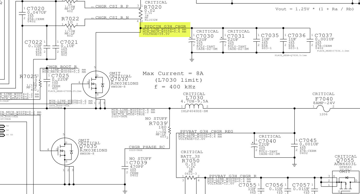

                  #48
                  Re: Macbook 820-3115 missing 3V42_G3H
                  Pin 1 is reading O.L
                  • mon2
                    • Dec 2019
                    • 14010

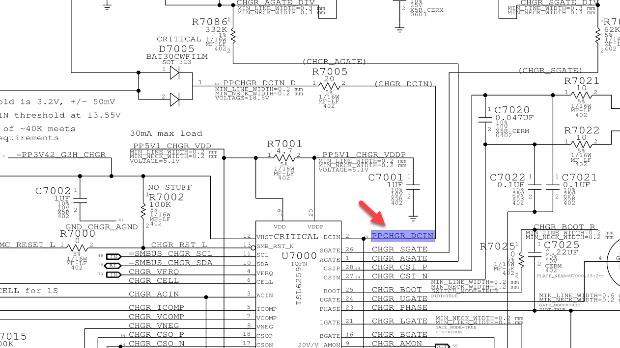

                    #49
                    What is the meter scale ? OL is a good sign that you do not have any bad caps on this (producer) side.
                    Confirm the voltage of PPCHGR_DCIN, ACIN, PPDCIN_G3H_CHGR.
                    If the voltage is powering U7000 and arriving at the high side mosfet, the next step is to confirm the mosfets are OK with resistance checks.
                    For the mosfet resistance checks, remove all power and check the resistance readings across the mosfet pins (Q7030):
                    Source (1-2-3) & Drain (5-6-7-8)
                    Source (1-2-3) & gate (4)
                    gate (4) & Drain (5-6-7-8)
                    Post each reading & the scale used on the meter.
                    Then repeat the measurements for the low side mosfet @ Q7035.
                    If the mosfet readings are not too low then it is down to U7000 being defective and needs to be replaced.
                    Without the fuse onboard, the PPBUS_G3H should be text boot perfect on pin # 1 of the (removed) F7040 fuse.
                    need to grab some groceries..will check back later...

                        #51
                        omg, it was hot outside..my milk duds were sweating. should burn the lawn and collect insurance.
                        Q7030:
                        Souce-Drain: 4Mohms (Mohms)
                        Source-Gate: 1Ohms (Ohms)
                        Gate-Drain: 9,5Mohms (Mohms)
                        The part is most definitely shorted and needs to be replaced. You can remove it off the board and check these measurements again on the removed component. Unless the ISL is causing this short condition, the mosfet should be replaced.
                        Q7035:
                        Source-Gate: 5kOhms (Ohms)
                        Gate-Drain: O.L (Mohms)
                        Also consider to replace this part as the resistance is low. Compare the value against a fresh mosfet.
                        These parts are very inexpensive so consider to buy spares and replace these 2 mosfets and do source also the regulator @ U7000 as a precaution. If you have a donor board, even better.
                        After the replacements, still leave off the fuse @ F7040 and confirm that PPBUS_G3H is restored.
