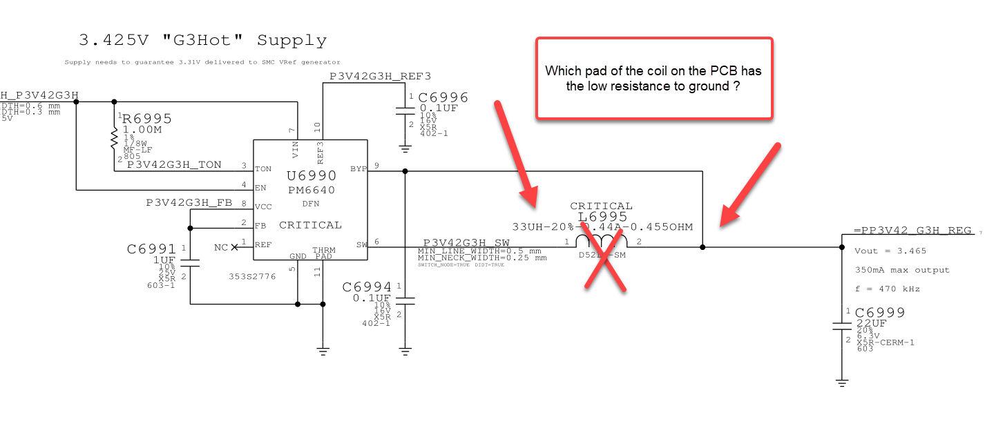

          That is a very low resistance to ground. There is a short somewhere.
          Remove this inductor. Careful to not lose or burn the part in the process. Use lots of flux, low air pressure so other parts do not go flying. If you have it, apply kapton tape to prevent other parts from the heat near this inductor.
          After this inductor is removed, check the resistance to ground again at the pads on the pcb where this part was soldered.
          Which pad measures the low resistance to ground?
          Is it the pad that is linked to the 3v42 regulator (producer side) ?
          Or is it the pad that is linked to the downstream (consumer side) ?
          • Nuld_
            • Jun 2022
            • 64
            Re: Macbook 820-3115 missing 3V42_G3H
            It´s definitely the producer side which is 3.2 ohms.
            Consumer side is climbing above 16Mohms.
            Pin 9 of U6990 is now definitely shorting to ground.

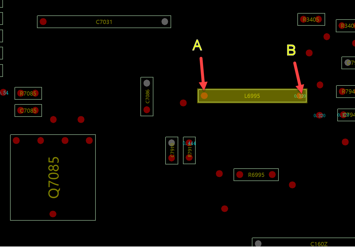

                  Wait. I may have my bearings in reverse.
                  Which side is with the short ? If it is on the left side (of the schematic / coil) = producer side. The side that is creating this power rail.
                  The right side (of the schematic / coil) = consumer side = downstream.
                  Please clarify.
                  See attached so we can be on the same page.
                  Is it 'A' or 'B' with the low resistance to ground ?
                  • Nuld_
                    • Jun 2022
                    • 64
                    Low resistance was on Pin1. It´s B
