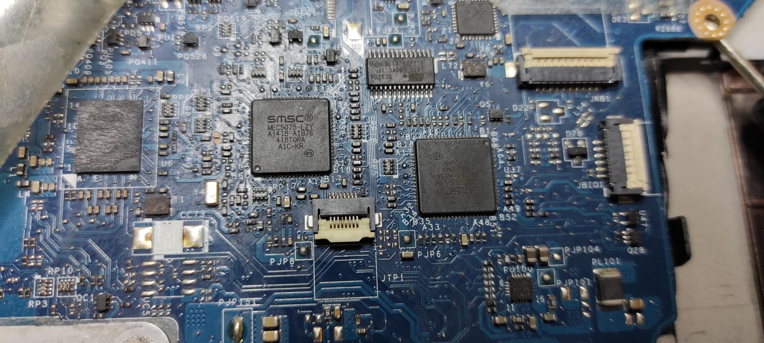

          Where was the water damage,post a picture of the area.

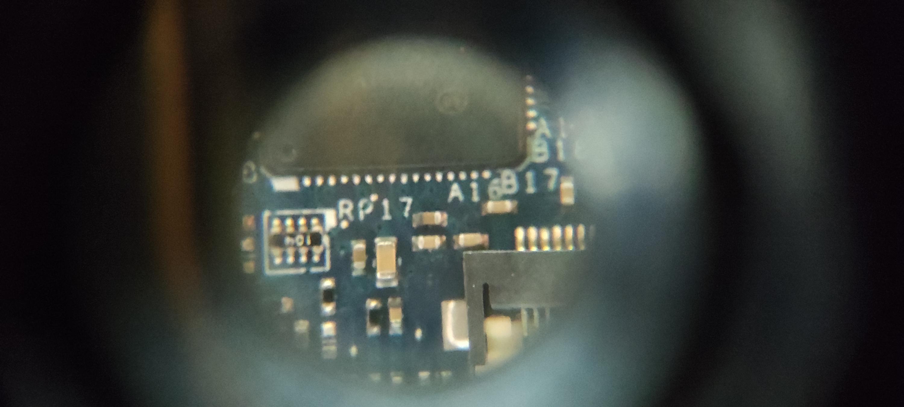

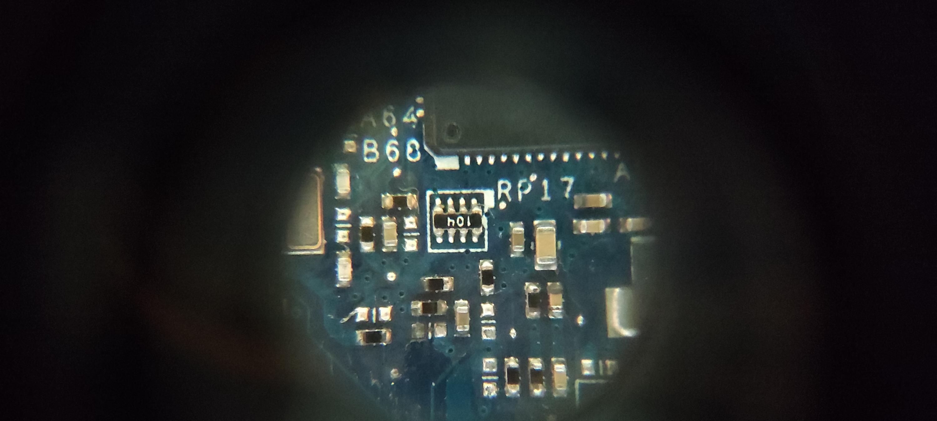

            Re: Dell E5440 no display output on monitor and VGA BUT works on HDMI!
            The area right under U38 and left of the connector JTP1
            Attached 2 magnified pictures and 1 with the whole area.

                                • 21241
                                Check all the resistors (resistance in ohms) and blackened caps.Ive highlighted the ones that look bad to me in the picture.Most of them might be ok if you touch them up with a bit of flux and solder
