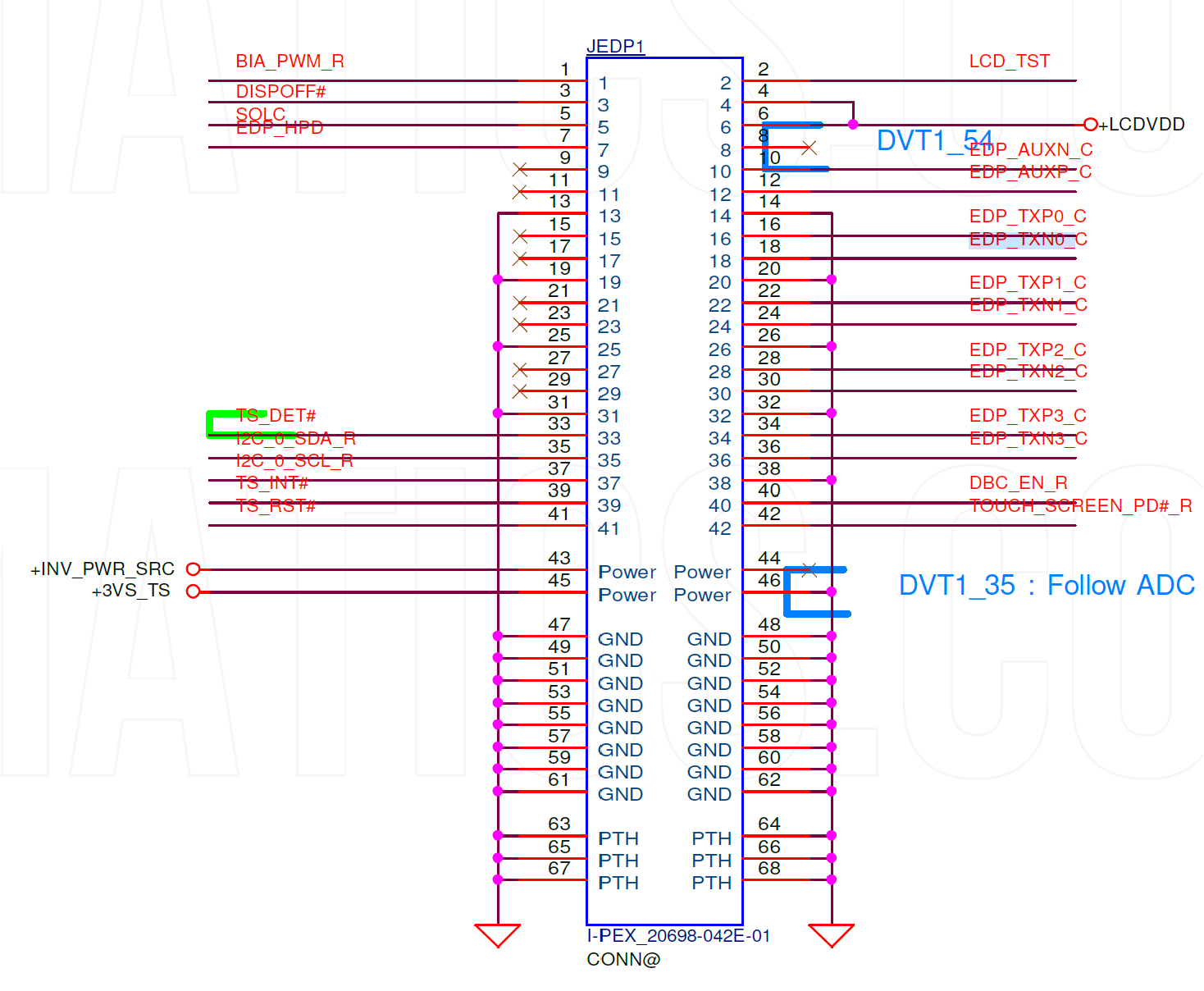

    I have a Dell XPS 9300 that's working perfectly fine with an external display plugged, from windows the internal display isn't detected. At boot I can see the Dell logo then when it should display the boot/bios or whatever the screen goes black (no backlight, no image using a flashlight). I tried unplugging everything on the motherboard except the eDP cable but it didn't helped (so it's not the lid sensor). LCDVDD/backlight power are powered down when this happen, PANEL_BKEN_EC and ENVDD_PCH are also down to 0v. It's weird, it almost feels like the motherboard is shutting down the display but I can't figure why, specially since the display is properly working at first...
    Does anyone have any idea ?
    Schematics & boardview -> https://www.badcaps.net/forum/troubl...-and-boardview

    Turns out the display flex was defective, it's a bit weird it still display the Dell logo even though the cable is defective.
