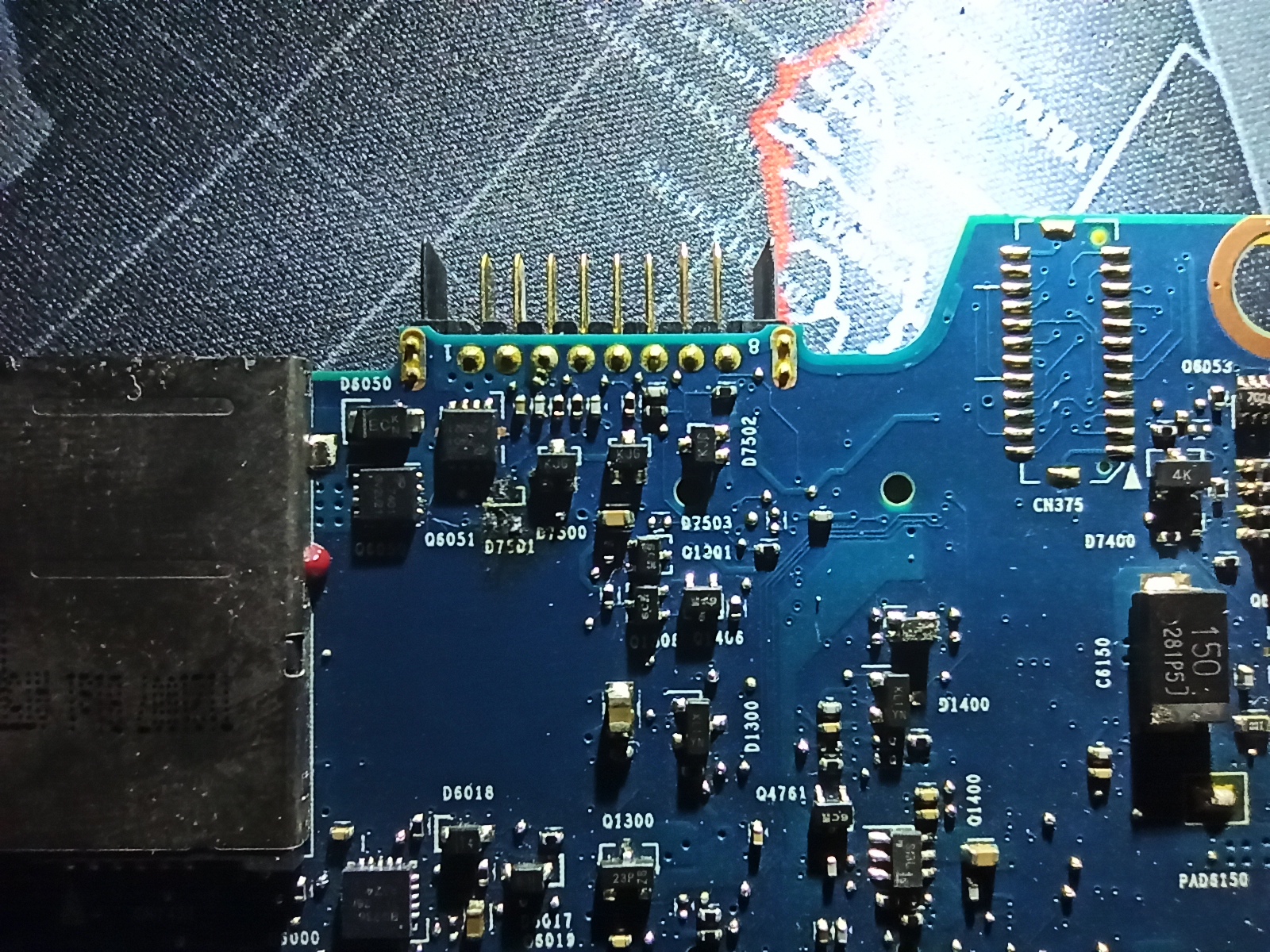

HP 8470p, Battery isnt Detected.
  • echo26
    • Mar 2022
    • 47
    • Philippines, Asia, Earth, SolarSystem, Milkyway Galaxy
    Hi, Ive read the pinned Charging Circuit memo. It was advised to check the Charging SDA and SCL. However I believe these must be checked using an ocilloscope. I only have an analog multimeter along with me. I needed help as I have changed the battery already but still isnt detected. Drivers were uninstalled and reinstalled however still no sign on sucess. The amber lights up when plugged in, laptop hangs up with keyboard and mouse unresponsive except power button, sometimes doesnt boot on battery. Now the new battery I believe is already drained as not being charged. When Left charging on adapter, teh amber light non-stops on blinking. Laptop is working fine without the battery but I badly needed it to be having a working battery for ease.
    As I am asking for help, I would like to know what Voltages I needed to post here in order for you to be able to help. I would have to disassemble the laptop and will be deemed unusable so I ahve to use my phone. I have a schematic so it wont be a problem identifying pins and pads.
    Tried new Charger btw, still have the same issue baout the battery not being detected. I tried finally to test the battery with th T-pin(pin 6) pulled down to ground (pin 8) with a multimeter and no Voltage isnt showing anymore with pin 1 to pin 8. probably the battery already shut off because it was drained. I am trying to aquire a new battery again. If I can get the desired voltages, maybe that will send me to a resolution for the problem. Thanks.
    I have attached the boardview and the schematics for anyone to look to make it easier.

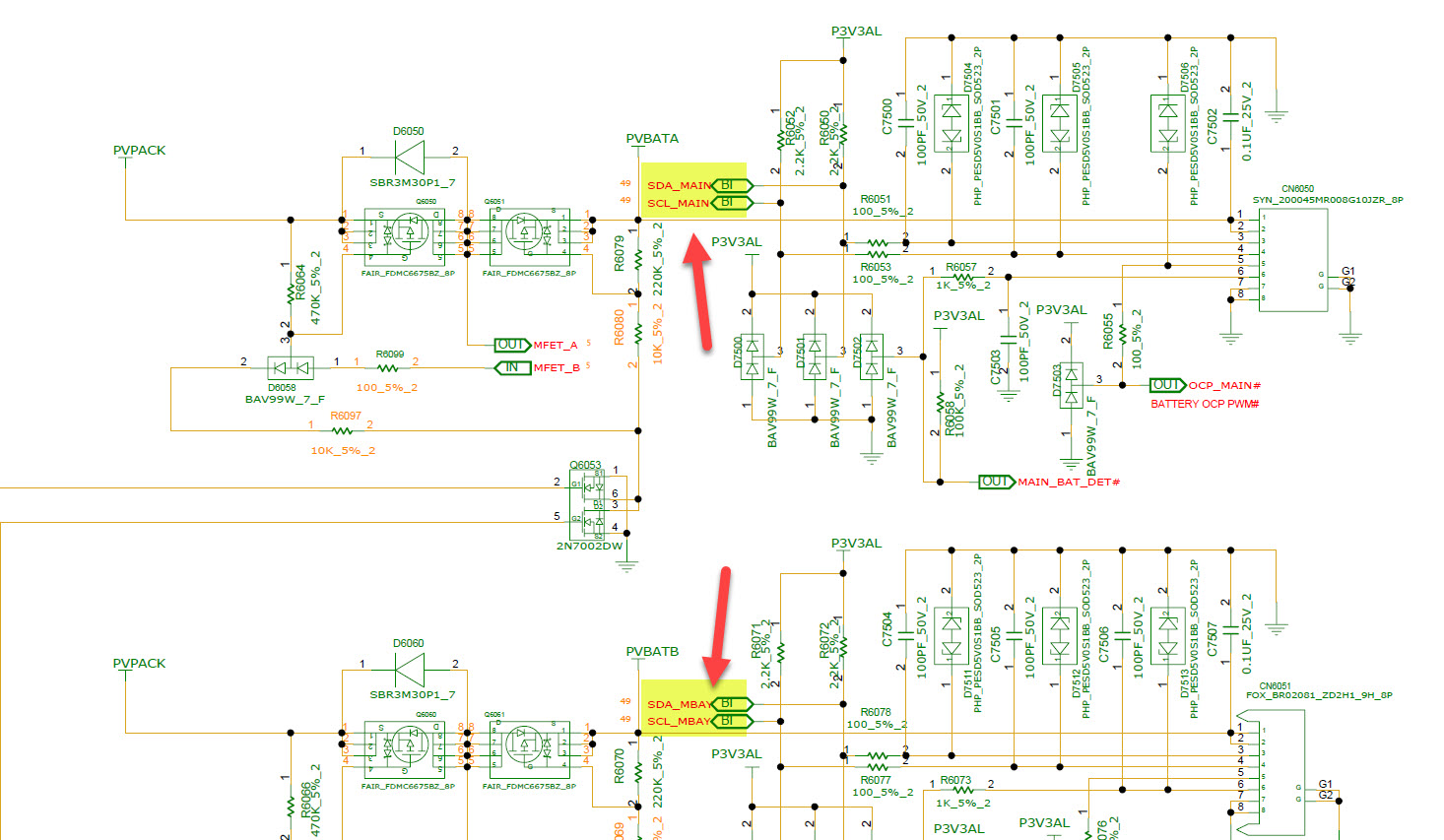

        I see 2 different I2C bus connections for the battery - not sure why but best to check both of them for stuck logic levels.
        Which connector is using your battery pack ?
        • echo26
          • Mar 2022
          • 47
          Re: HP 8470p, Battery isnt Detected.
          Cn6050 to be exact.
          • mon2
            • Dec 2019
            • 14098
            Ok - confirm the voltage @ SDA_MAIN & SCL_MAIN.

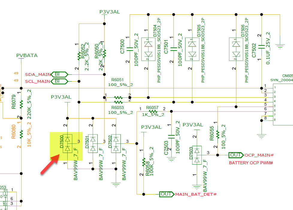

                          The readings do not sound correct but ignore for now. They sound very low in resistance.
                          See attached. Remove the ESD diode @ D7500 off the board.
                          Then check the voltage again on the same SDA & SCL lines.
                          Post the readings.
                                Well noted. Check the resistance of R6050. Is it 2k2 ?
                                Remove the diode @ D7504 (right side of the schematic). My bad, this is the ESD diode for the SDA line.
                                Check the voltage again after this removal of the part.
                                You can solder back the D7501 part since it is not the guilty party.

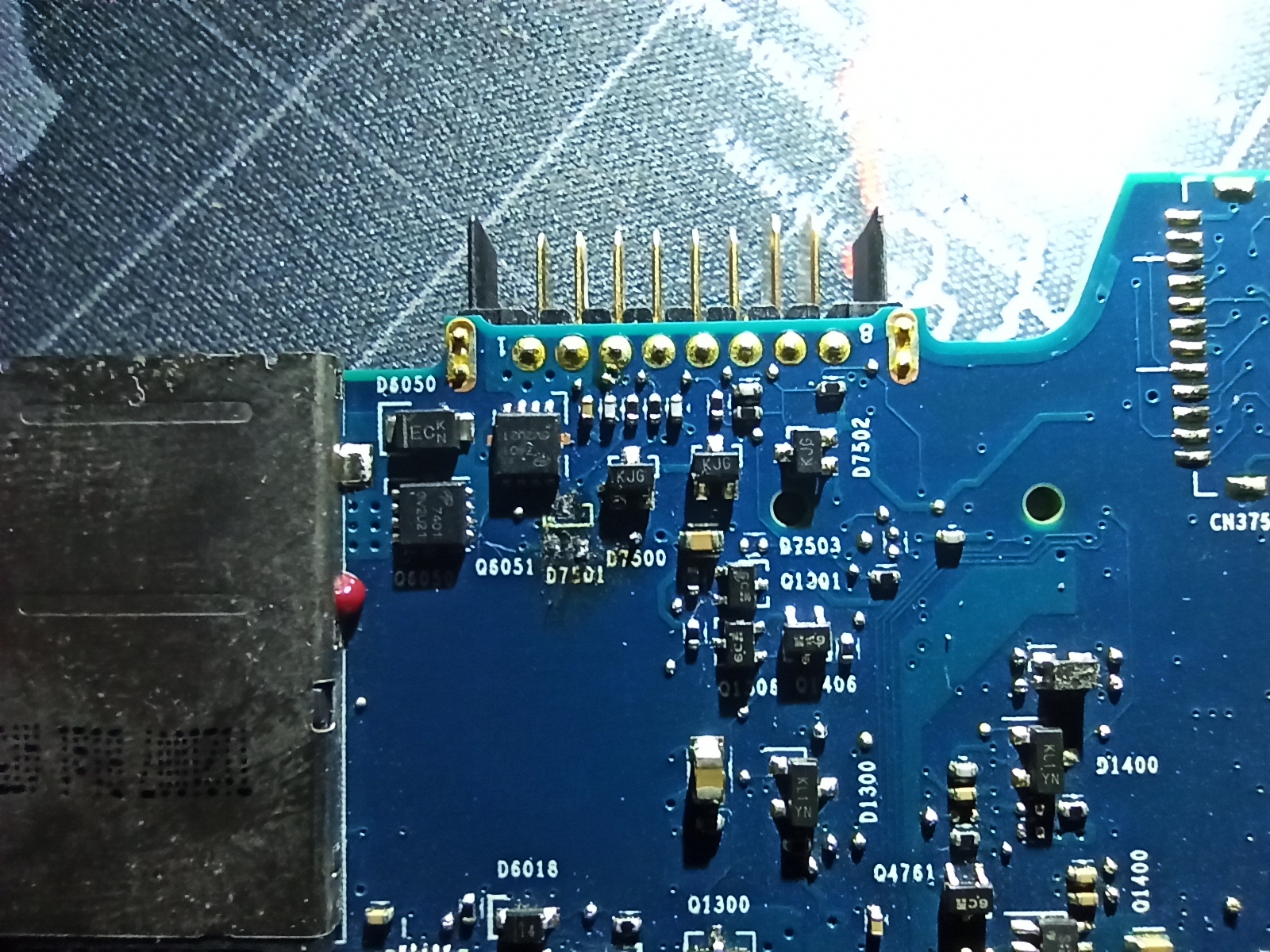

                                  I was actually looking into the Resistor haha, I can't still find it. It's hard without having a board view. Forgive me if I reply slow because I only use my eyes to locate the parts 😂😂
                                  • mon2
                                    • Dec 2019
                                    • 14098
                                    If it helps, post pics. Should be nearby the battery connector. Likely black in body color and it may or may not have a white band.The part is not polarized so may not have a band on it.
                                    • echo26
                                      • Mar 2022
                                      • 47
                                      Yep, can't still find that Resistor, I only found the 100ohms Resistor on top the pin 3 of the diodes.
                                      • mon2
                                        • Dec 2019
                                        • 14098
                                        Could it be on the other side of the logic board ? Post those pics. About to take my late lunch.
