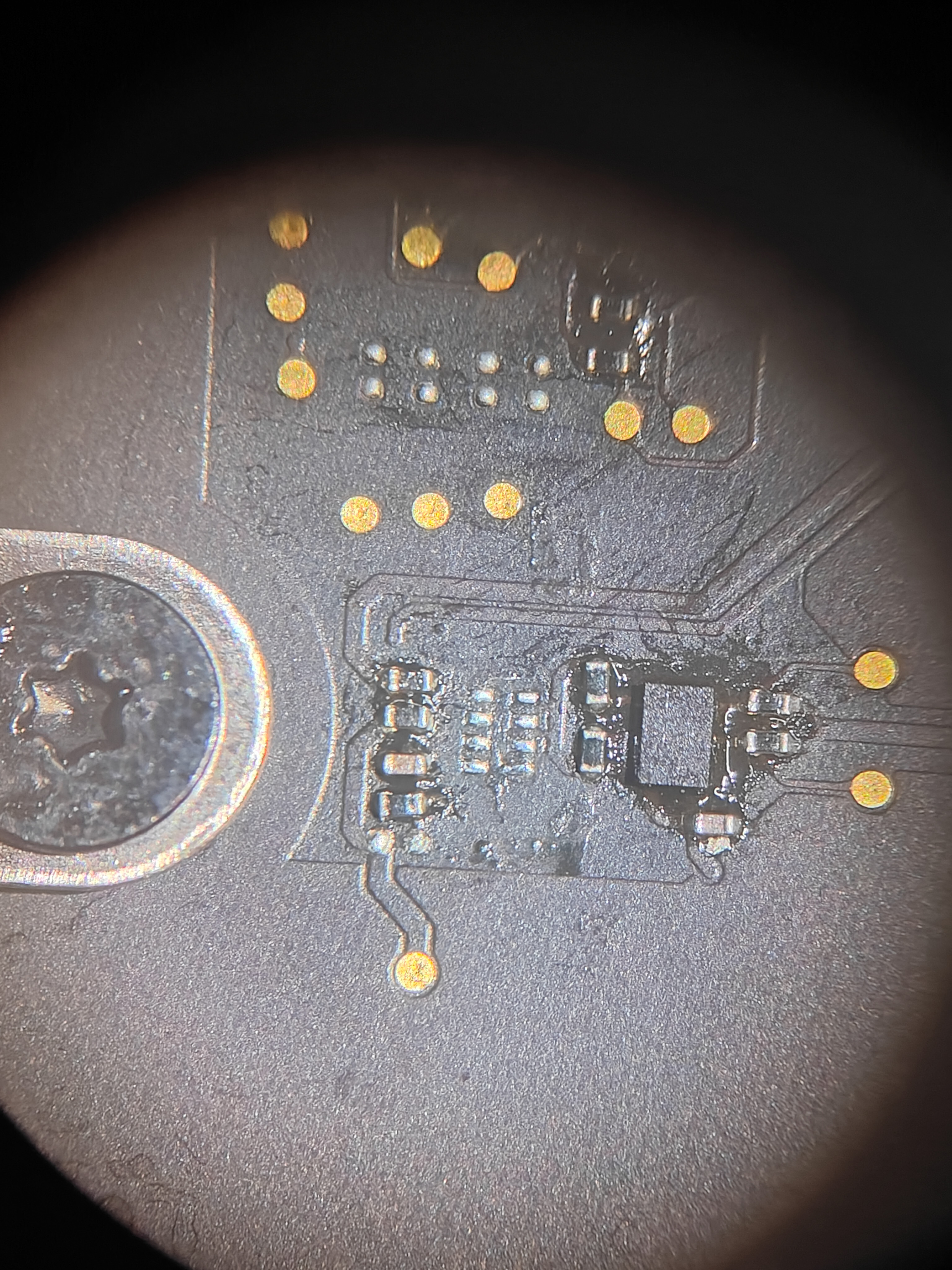

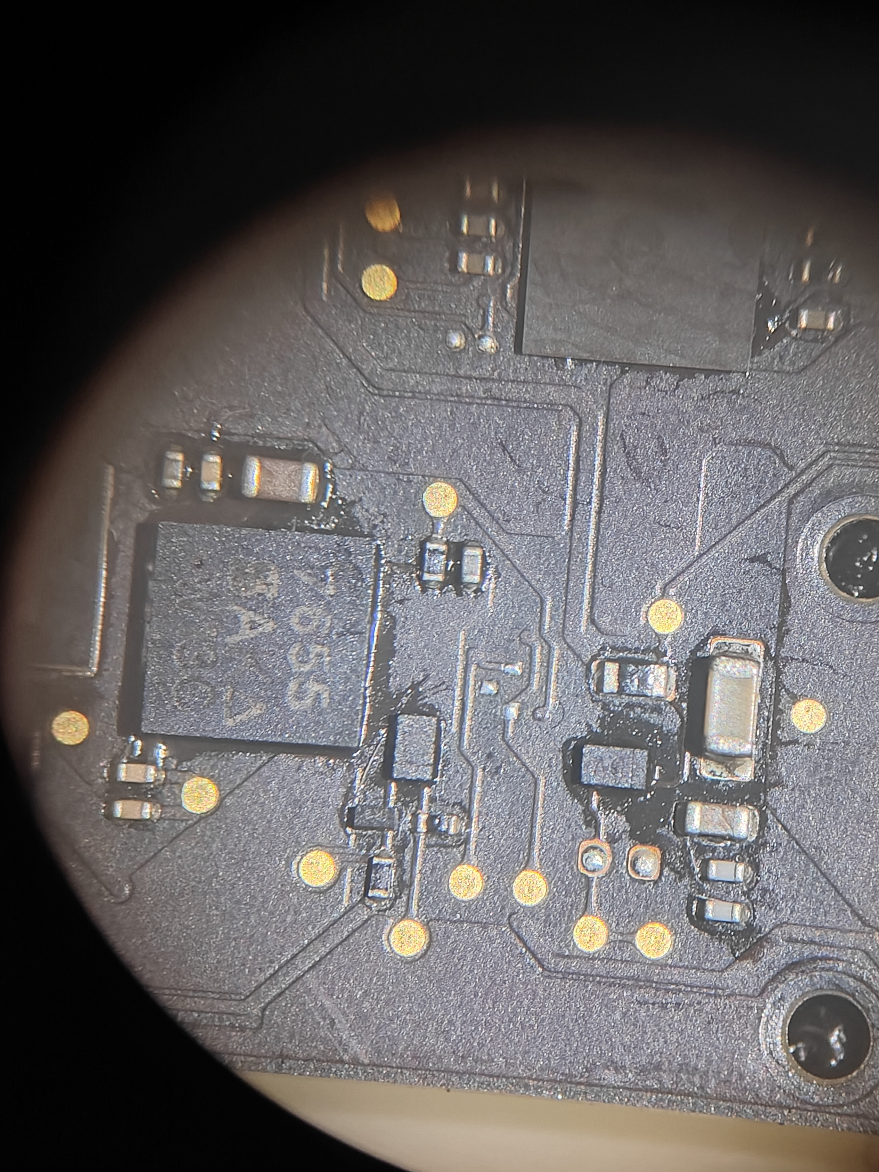

    Post pics of the removed UD201 and U5150 areas of the board.
    With these parts removed, there should be no short on I2C_SMC_PWR_3V3_SDA / I2C_SMC_PWR_3V3_SCL.
    Remove all power. Meter in resistance mode (not diode mode). Measure the resistance to ground on:
    I2C_SMC_PWR_3V3_SCL
    I2C_SMC_PWR_3V3_SDA
    Post the measurements in ohms.

      I2C_SMC_PWR_3V3_SCL - (In Ohms scale on my multimeter) reads 0L. (if I set to auto-range - 13.53kohms)
      I2C_SMC_PWR_3V3_SDA - 11.4 Ohms
      Attached are pictures from the two areas as requested. Please disregard my flux stains that surrounds the area. I will clean that up later. I tried to cleanup the area you're interested in a bit with some isopropyl alcohol so what you're seeing surrounding the area is flux.

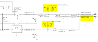

                    • mon2
                      • Dec 2019
                      • 14666
                      I think you mean:
                      UD102
                      UD150
                      level shifters? Are these BOTH level shifters onboard? To me, this is a strange arrangement to have 2 different levels shifters with different operating voltages paired together.
                      • grimacelord
                        • Jan 2017
                        • 380
                        Originally posted by mon2
                        I think you mean:
                        UD102
                        UD150
                        Our schematics seem to have components labeled differently from one another. Mine has different labeling than yours. See attachment.
                        Yes, BOTH components "UD___" are on the board.

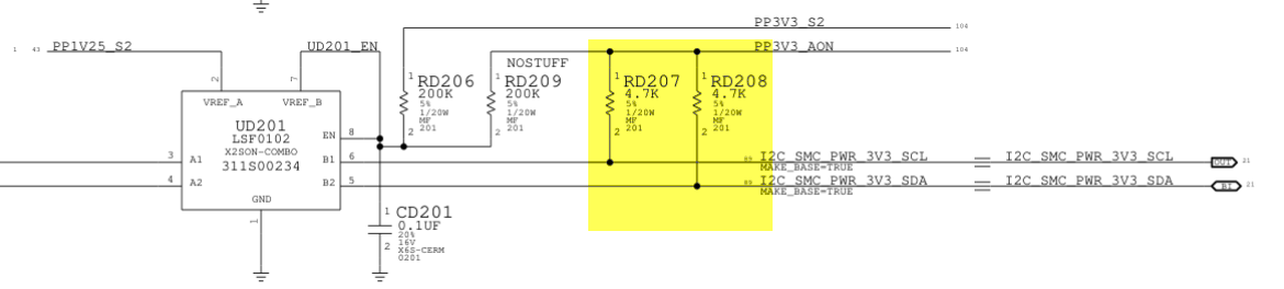

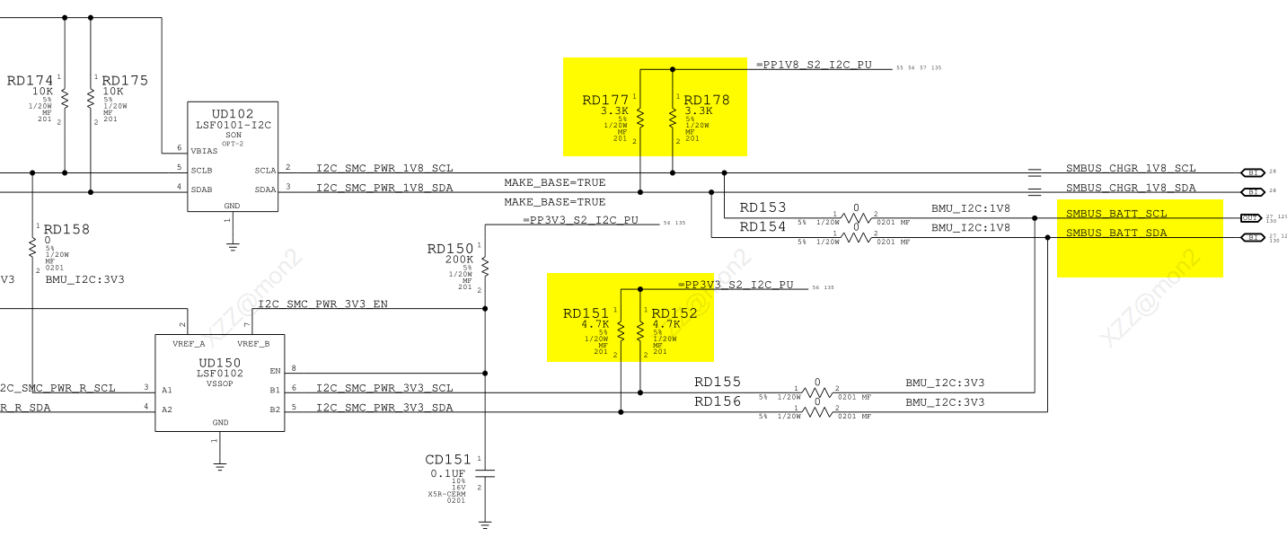

                        • mon2
                          • Dec 2019
                          • 14666
                          Your schematic makes more sense than the one in my (paid) database service.
                          Confirm the pull-up voltage is present on the pull-up resistors.
                          • grimacelord
                            • Jan 2017
                            • 380
                            Both resistors read 3.23V although they are not stable and fluctuate between 3.22-3.23V, barely a difference but I figured it might be worth pointing out. Either way, they're still not 3.3V, as they should be.
                            • mon2
                              • Dec 2019
                              • 14666
                              Remove all power. measure the resistance to ground of the same 3v23 power rail. What is the resistance in ohms?
                              • grimacelord
                                • Jan 2017
                                • 380
                                In Ohms scale:
                                RD208 - (I2C_SMC_PWR_3V3_SCA) - OL
                                RD207 (I2C_SMC_PWR_3V3_SCL) - OL
                                If I switch the multimeter to Auto-Range, it reads:
                                RD208 - (I2C_SMC_PWR_3V3_SCA) - 4.55 MOhm
                                RD207 (I2C_SMC_PWR_3V3_SCL) - 4.44 MOhm
                                • mon2
                                  • Dec 2019
                                  • 14666
                                  Assuming you have fresh batteries in your meter, the rail to me is a bit on the lower side as compared to the expected 3v3 but is not shorted.
                                  Confirm the resistance across each of these resistors. Do they match the schematic values?
                                  The next fault may be with the level shifters themselves. Confirm the level shifter is being powered. Measure the voltage to ground on the other side of the same signals = pins 3 and 4 of the level shifter.

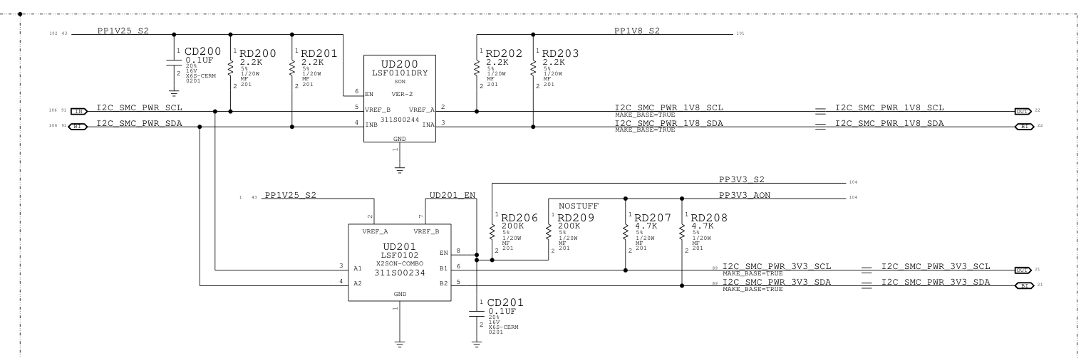

                                  • grimacelord
                                    • Jan 2017
                                    • 380
                                    Both of those resistors read 6.7kohms, but the schematic says that they should be 4.7kohms. I checked my donor board and they read 6.7kohms on that board as well. A different thread I was reading on here from another user also reported his resistors to be 6.7kohms as well so I don't know if the schematic is correctly reporting the true value or not.
                                    UD201: (The pins themselves are inaccessible under the chip, so I have to measure from nearby components)
                                    Pin 3 (as measured by Pin 2 of RD200 next to it) - 1.25V
                                    Pin 4 - (as measured by Pin 2 of RD201 next to it) - 1.25V
                                    • mon2
                                      • Dec 2019
                                      • 14666
                                      The input signals imply that the output should follow and be pulled to the 3v3 but they are not. The pull-up resistance is not super critical. We often use even 10k pull-ups on our many designs for I2C / SMBUS interfacing.
                                      Has UD201 been worked on? Flux and reflow it. This part may be defective.
                                      • grimacelord
                                        • Jan 2017
                                        • 380
                                        Yes, UD201 was replaced with a donor from a donor board, but admittedly, the donor component may have been defective itself. I am not sure. Neither the original component nor the donor is working. I have already sourced a replacement at Digikey. Do you think it would make sense to buy new ones at this point?
