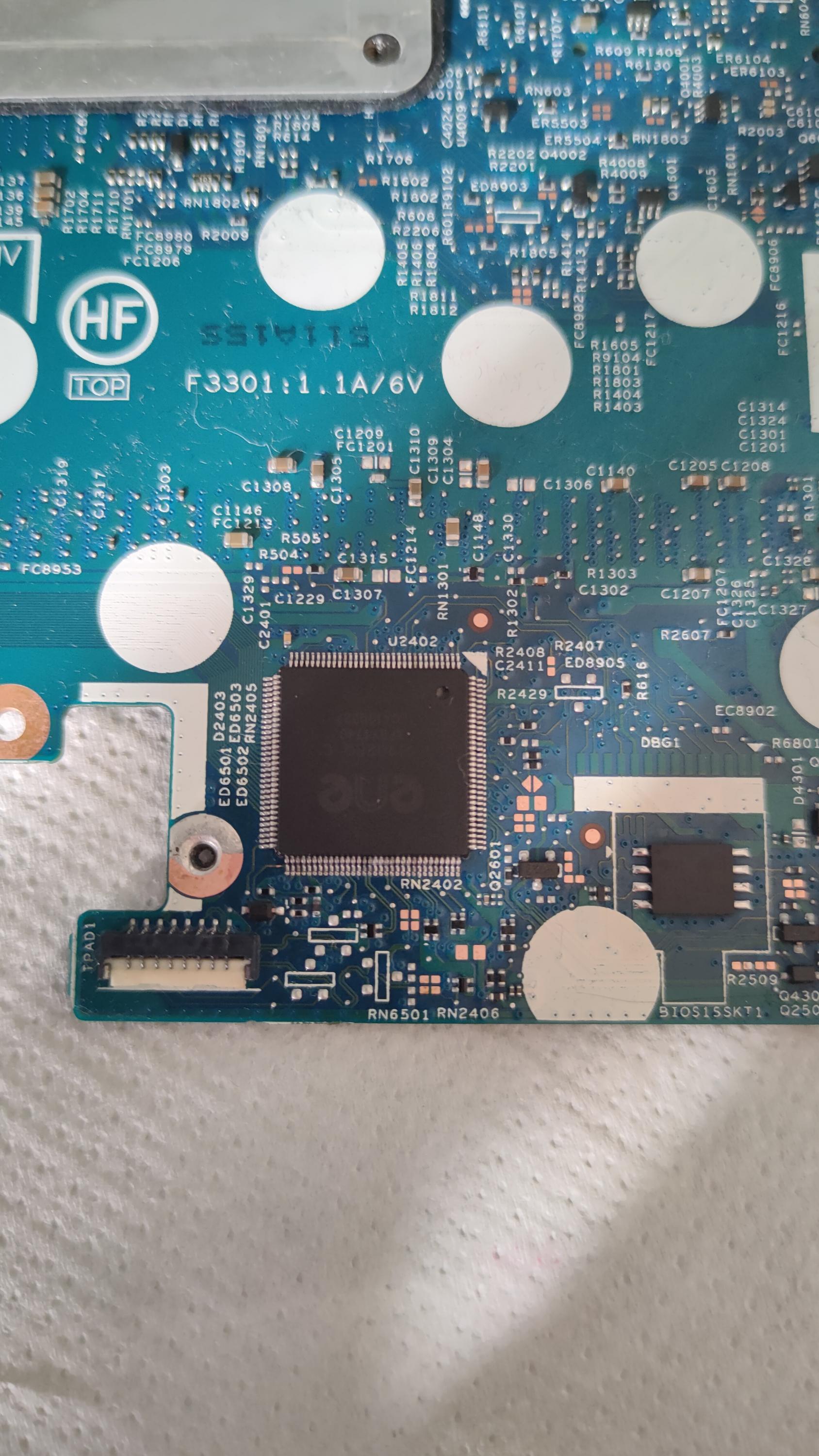

    dc jack led glows orange without even programming but mb dont turn on . You need to program kbc. Are you sure u have +3V LDO on pin17 of SY8286BRAC(AWV)?? If yes, then post a clear picture of KBC9028 with surrounding components. may be some resistor is knocked off while soldering the kbc or kbc is not properly soldered and/or kbc is defective. You have +3V_EC at pin 96 of KBC?? Be very careful while measuring pin17 of sy8286brac. better not to measure on the pin directly.

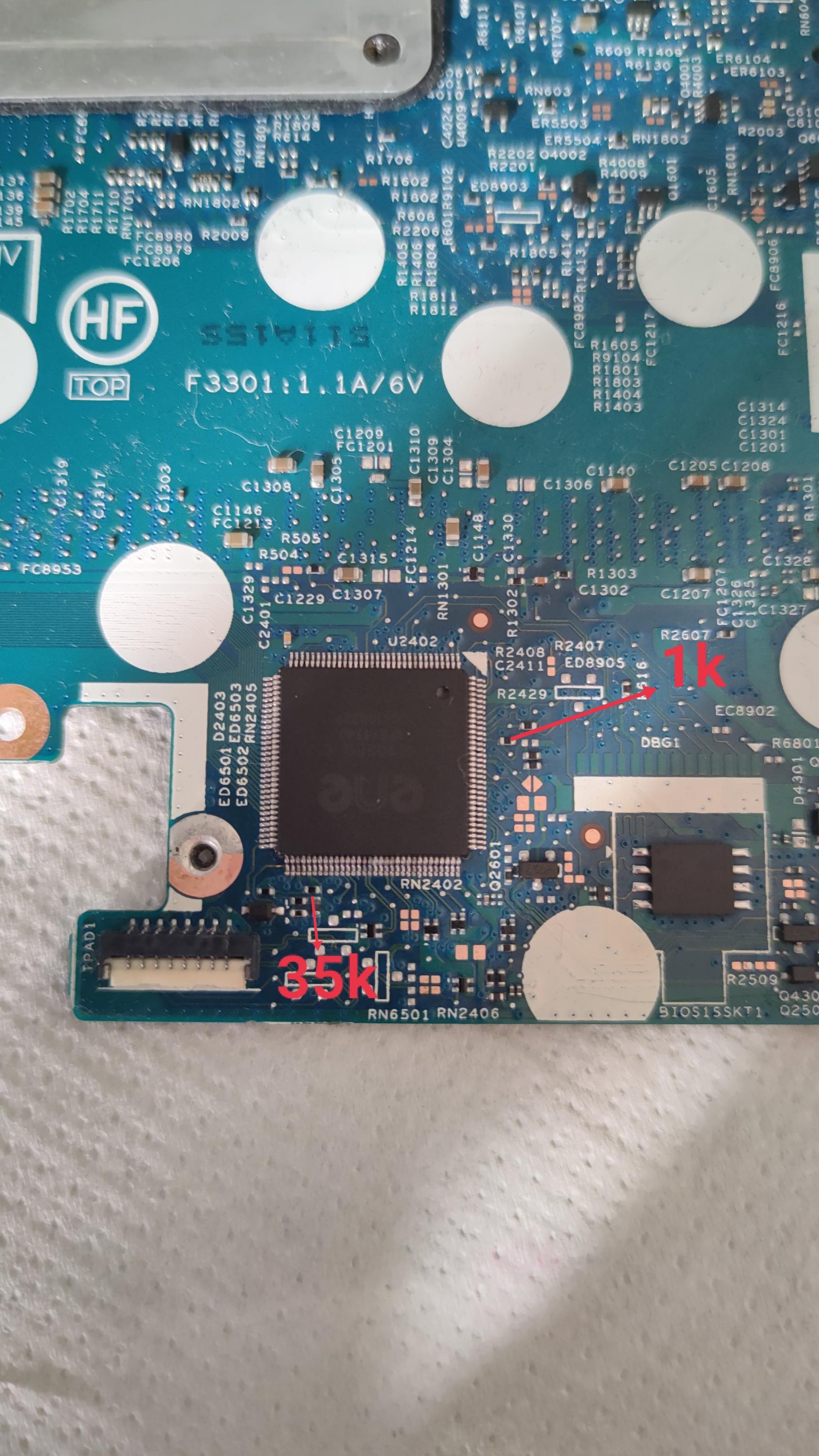

    ok, I re-soldered the original kb9028q, the charge led is ok, orange,
    I press the power button, the white LEDs light up for about 10 seconds and then turn off,
    in ignition I find the 5V and 3 V on pl 4502 and pl 4501,
    3v on spi mxic (already written another bios)
    I can't find CPU power supplies, and Ram, Pl5201 marks 0.6 ohm, it should have 1 V, generated by Pu5201 (V15U 1533sf) I don't recognize the type of ic on the code,
    wiring diagram I can not find it for this motherboard, there will be some signal that does not allow the correct ignition sequence, I suspect pch, do you have advice

        Just received another dead mb(same). KBC is badly soldered with missing surrounding components. @reset1986, can you help me with the value of those 2 resistors circled in black.

          here, measured without welded kb9028q,
          I'm waiting for a new kb9028q already programmed

            Thanks for resistor values. Soc is bad(pch part). Even after removing kbc,3v pwm, short remains on 3V line. Injecting 1V,10A makes SOC heat up . So end of story as neither I've such SOC, nor do I have stencil for same. So returned it to customer . Feel bad for the customer. Unit was just 1 month out of warranty and goes to scrap. It was with touchscreen.

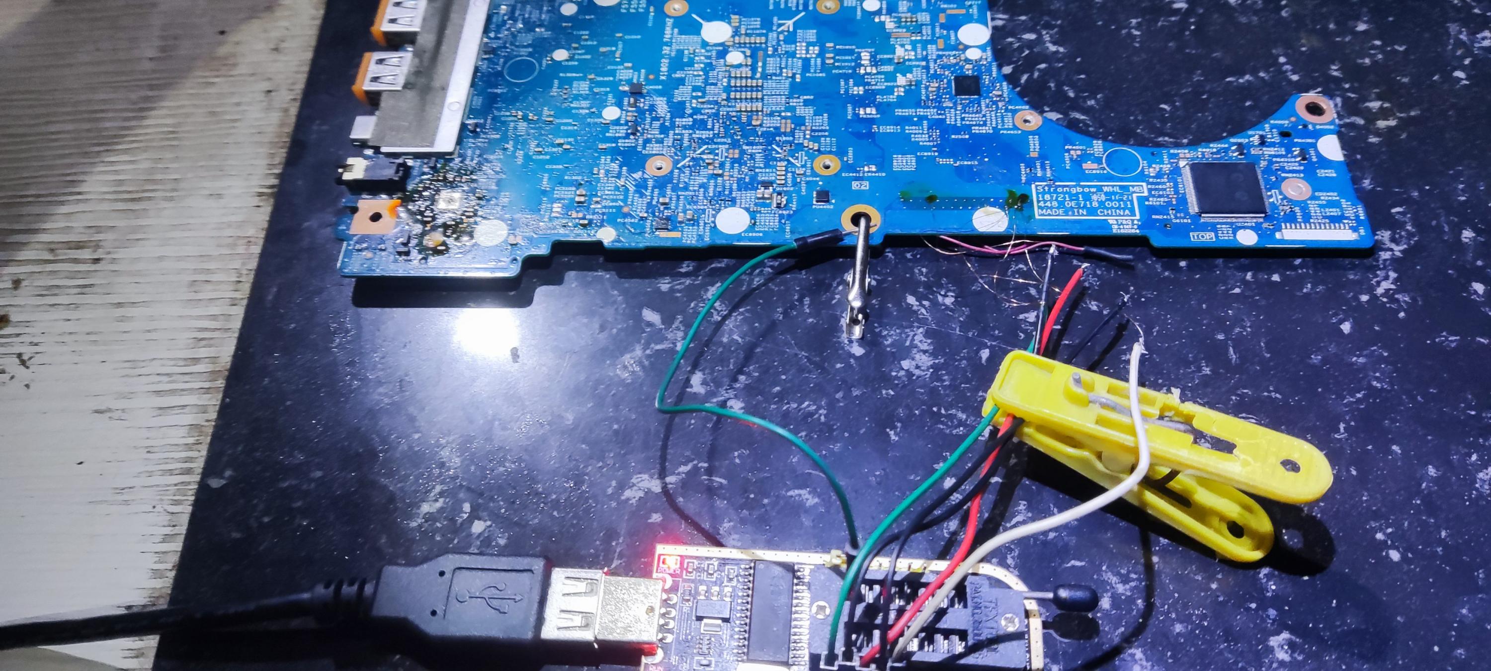

                      i've try neo programmer with ch134a for programming kb9028q.. solder it directly to keyboard pin on acer sf314-56. but i've no luck. pm slp s3 and pm slp s4 not showing up.. the kbc respon my power button and enabling the other 3.3v 1v and 1.8v..

                        Are you sure the pins on keyboard connector are correct. Make sure to trace the pins from the chip directly to the keyboard with a multimeter. And make sure it is grounded properly. I dont think the board will turn on if the signal is properly grounded

                          yes i've flash it with 3 different ec bios.. detecting, programming and verifying succses but no luck. still missing slp s3 and slp s4.. rsmt_rst and pm powerbtn are coming.. i'm affraid my PCH..

                                      For future reference of those using CH341A trying to flash KB9028:
                                      https://www.youtube.com/watch?v=GQGH6yZuXCc&t=567s
                                      The correct pinout as I have sourced from the video above:
                                      pin 42 (KSO3) to Ground
                                      pin 59 (KSI4) to CS
                                      pin 60 (KSI5) to CLK
                                      pin 61 (KS6) to MOSI
                                      pin 62 (KSI7) to MISO
                                      MISO and MOSI are backwards on post #34, I wasted so much time looking for other pinouts for this chip because of that
                                      I used NeoProgrammer 2.2.0.10 with KB902x profile to flash it
