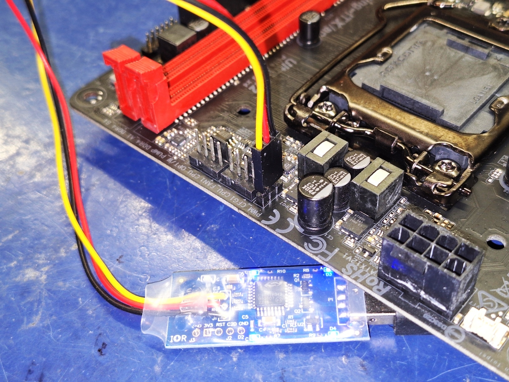

    I have an ASROCK Z270 GAMING-ITX/AC motherboard with a fried VCORE controller IR35201 (International Rectifier, currently Infineon).
    This chip is unfortunately programmable, so after replacing the chip, it needs to be programmed with a config file, which I do not have, as the chips is not readable any more (total short on power supply pin).
    Some of you maybe know, it is possible to read out the config file from a board with a working chip using the USB005 I2C adapter and IR/Infineon software called PowIRCenter. The software is available freely at Infinion site, if I remeber correct after registering.
    I'd appreciate, if somebody who has access to this motherboard and the USB005 adapter could help me out with this config file.
    I know the chance for such a coincidence is low, but who does not ask does not get any answers.
    Some more information about how to read out the such config files is in the following post:
    https://www.badcaps.net/forum/troubl...xii-hero-wi-fi
    Here a picture how to connect the USB005 adapter to this board - normally where the 3 wire cable is connected there are only 3 solder joints (vias), but I have soldered a 3 pin header into the place, as this is easier than soldering a cable.
    The connecting wires are:
    Pin 1 (Black) - GND
    Pin 2 (Red) - SMB_DATA
    Pin 3 (Yellow) - SMB_CLK
    The board must be powered to be able to read the chip - to start this board a CPU must be inserted, this board is one of the few that checks if CPU is present before starting.
