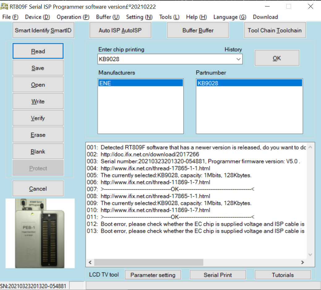

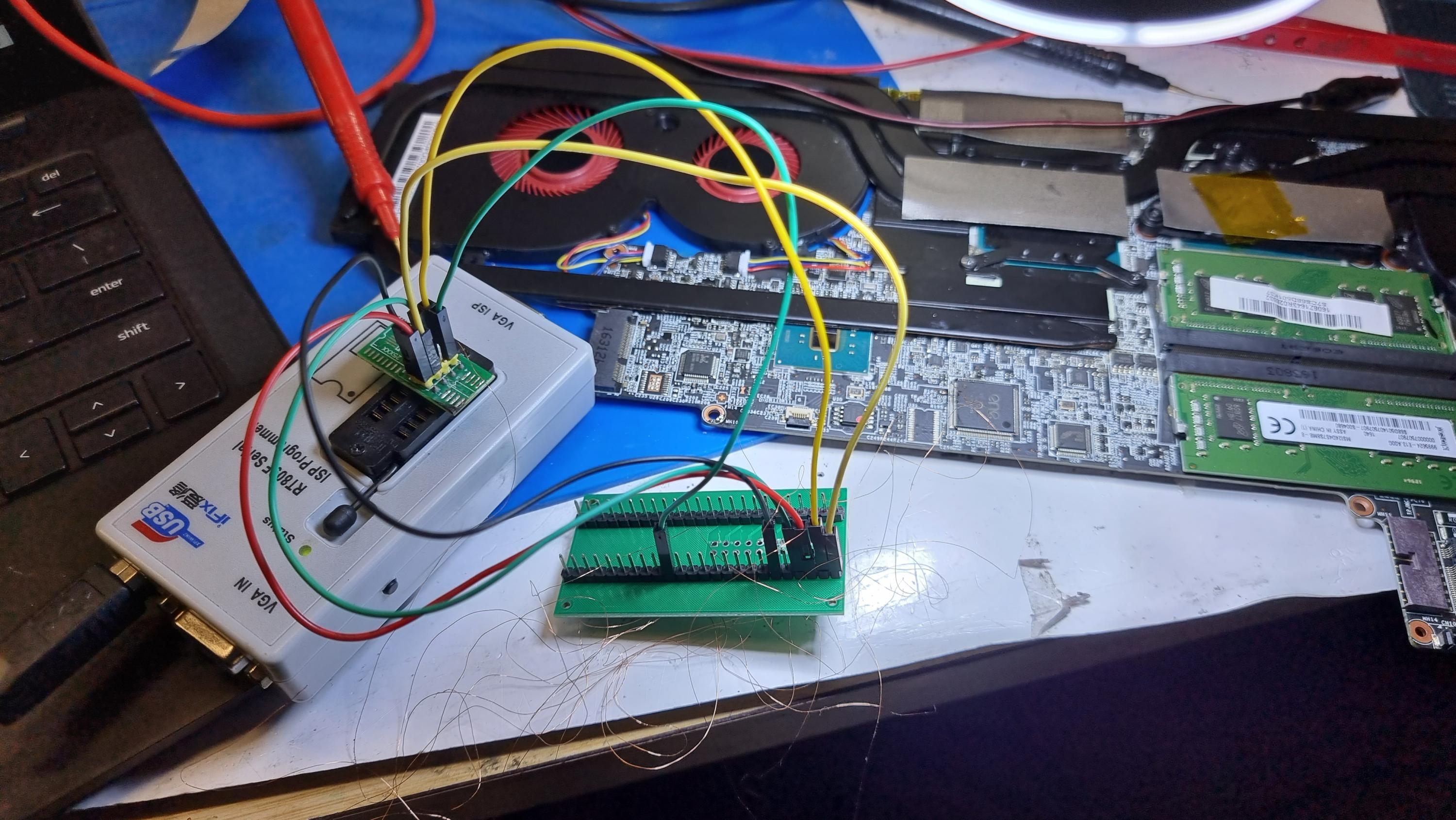

    Hi all, I'm having trouble detecting a SuperIO. ENE KB9028 using RT809F which says it supports KB9028. it's programmable through SPI Flash. From schematics I have connected the RT809F as follows. Pin 1 CS to > Pin128, Pin 2 DO to > Pin120, Pin 4 G to Ground. Pin 5 DI to Pin119, Pin 6 CLK to Pin126, Pin 8 VCC to Pin9 of SuperIO. I also rotated Pin 2 and Pin 5 thinking I made mistake. It simply doesnt get detected. I checked VCC it gets 3.3 from Power supply when DC jack is plugged in.
    I tried timing it like press read then Insert DC jack, or vice versa etc. No luck many times.
    What am I doing wrong? thanks
    I checked continuity and it's good for all cables from super IO to the RT809F

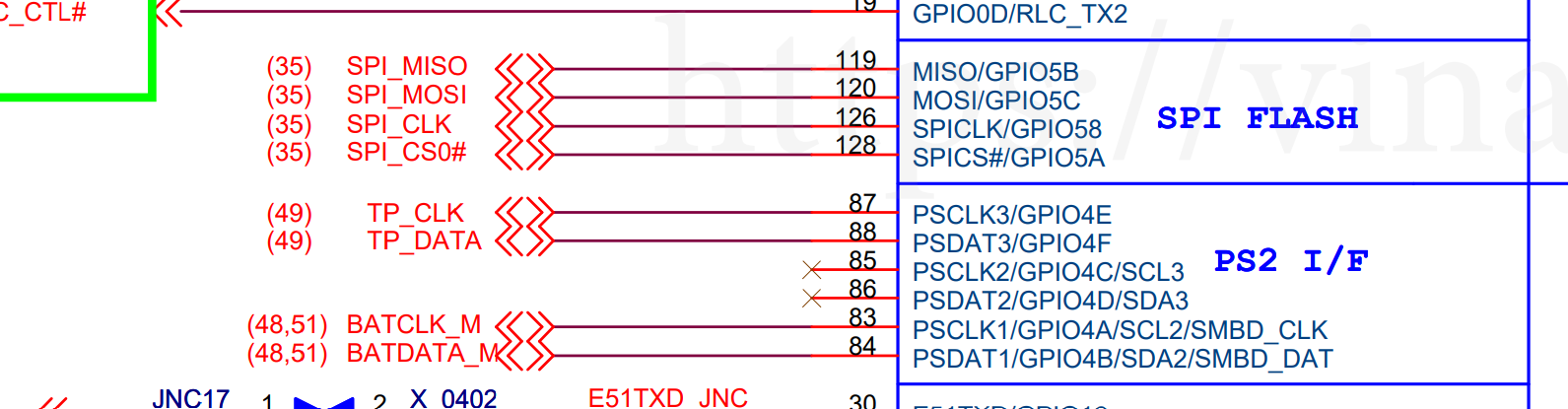

    KSO3=23 KSI4=4 KSI7=1 KSI6=2 KSI5=3
    KSO3 is going to Keyboard Pin 23.
    KSI4 is going to Keyboard 4 etc.
    But where is it going from Keyboard??? Which is which? Clk/DI/DO/VCC/CS etc.

        kso3=4 (kbout3) , ksi4=13 (kbout12) , ksi7=16 (kbout15) , ksi6=15 (kbout14) , ksi5=14 (kbout13)

          Ok I think I found it
          KSO3 GROUND
          KSI4 CS/CE
          KSI5 CLK
          KSI6 DI
          KSI7 DO
          If this is correct, I still can't detect it
          What do I do with VCC? I can see SuperIO Gets turned on due to 3V AW is present so I don't think I need to connect. Any advice?

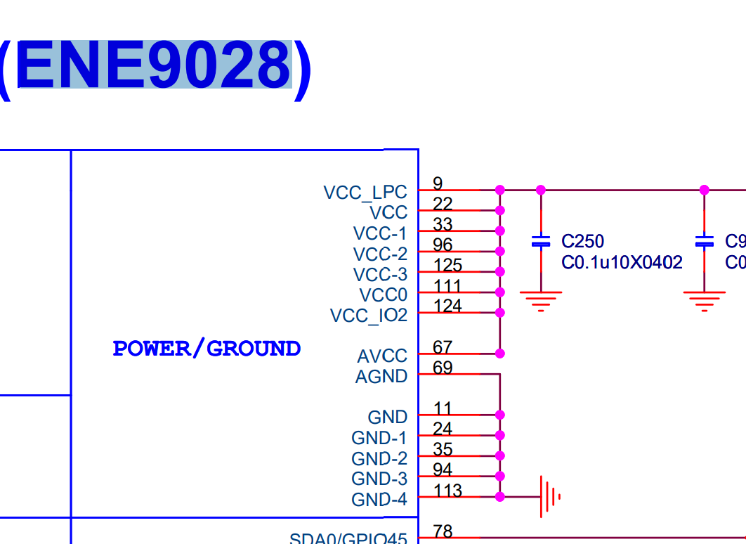

                I don't know if it makes sense but thin Pin count is 28. Pin 23 from top and bottom, both are over 3V - how can that be for the ground?
                Your recommendation of KBOUT3 is 3.69V from one side and 3.3 from other side, if you count otherway. Just in case I got counting the wrong way, both are above 3V. What am I missing here?

                          Thanks for the video. I actually already done this with a ch341a programmer and KB9012 chip. But now I am trying with the same programmer with a KB9028 chip. I cant find schematic for the board yet so I might end up removing the chip and manually trace the lines to the keyboard connector.
                          its actually kb9028G chip so that explains why I need to remove the chip.
