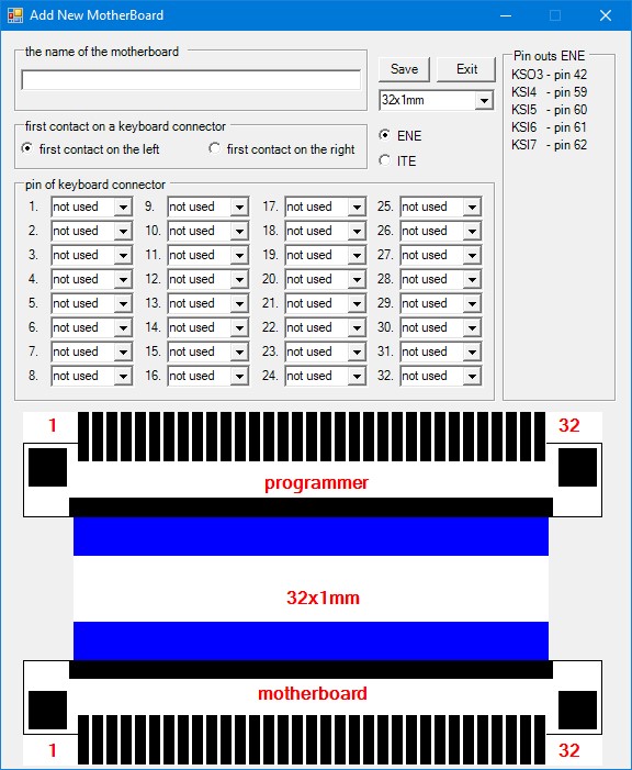

    The mb under repair is FAROE_Dis_X32_MB-MV 18742-1(HP). It came completely dead. Found 19V is not passing thru 1st dc-in mosfet. After diagnosis, replaced BQ24781 with BQ24780S and it solved that part of the problem. Next found +3V LDO is shorted, so removed the +3V PWM but still shorted. Removed KBC9028Q-c and short is gone. I've soldered new SY8286BRAC and KB9028Q-C(both new). DC jack is glowing now but mb doesnt turns on as kbc needs programming.
    I've SVOD1 which doesnt list kb9028 as an option. Still tried selecting kb9022 but doesnt work. The support has ended from SVOD-so cant download new config file. Schematic is perhaps not avlbl for this mb. I've RT809F which i beleive is also not capable of programming 9028 kbc(it can program kb9012/22).
    So can anybody give some idea how to program kb9028?? Please share config file for this mb. If anyone of sure of any other programmer which is capable of programming kb9028-i can buy a new one.
    Please suggest way forward.

      Vertyanov programmer lists it as this:
      KB_pins=32 LEFT DOWN 1MM KSO3=15 KSI4=28 KSI7=31 KSI6=30 KSI5=27 KB9028Q

                  In SVOD3, you can create your own configuration file for the motherboard. If you have access to the EC pins, then you just meter it out to the SVOD (see attached pic). You just need to work out ribbon cable pitch, which is pin 1, if it's a drawer type connector whether it's top or bottom connection etc. I create my own usually as the ones in the online database frequently don't work.
                  Maybe update your SVOD? They have SVOD4 out now.

                      The SVOD comes with a breakout adaptor with various flip type ZIF connectors for each connector pitch. They also supply an assortment of ribbon cables of varying pinouts and pitchs. You select which one to use based on the ZIF connector on the motherboard you want to program, create the mapping and connect. Note there is a micro USB on the breakout board that you use to connect to the board via USB cable. This serves no function other than to connect the grounds together.
                      Initial connect is a pin check (this is intended with board unpowered as it can damage the internal FET's of the programmer), check ground, then you plug in the power to the board. If the +3V for the EC is active, you then press Read ID. If successfully connected, you get the ID etc and you can then Read, Write, Erase etc.
                      Did a search with FlexBV and got a couple of hits on Acers for KB9028Q
                      Acer Swift 1 SF112-32
                      Acer Spin 5 SP515-51N
                      There might be a few cheaper alternatives, but I believe the SVOD is the most versatile. The software programming interface is pretty intuitive...it needs to be as you get almost zero support from these guys on the forum. You can buy an adaptor to program the EC's in a socket but it's quite expensive (140 euros). The SVOD comes with the ZIF adaptor and the ribbons for 178 euros.
                      https://shop.svod-project.com/index....&product_id=54

                          Thanks to all who responded. @khaahk, the pinout given by you is correct. I tried my level best but couldnt program ec with SVOD1 with custom made config file as provided by @khaahk. However, i got the job done with RT8209F by manually soldering the pins on kbd connector and khaahk's input is verified ok.
                          @reset1986, KB9012/22 cant be replaced for kb9028. I already tried kb9022 on this very mb and it creates problem. KB9028 datasheet i couldnt find anywhere. I referred to Lenovo 330S schematic for basic understanding of KB9028.

                                Re: KB9028 Programming
                                Originally posted by mon2
                                @mcplslg123, after you wired it up, did you program this component as the KB9028q or some other personality?
                                as KB9028. RT8209F has this in list.

                                  Yes, I got display
