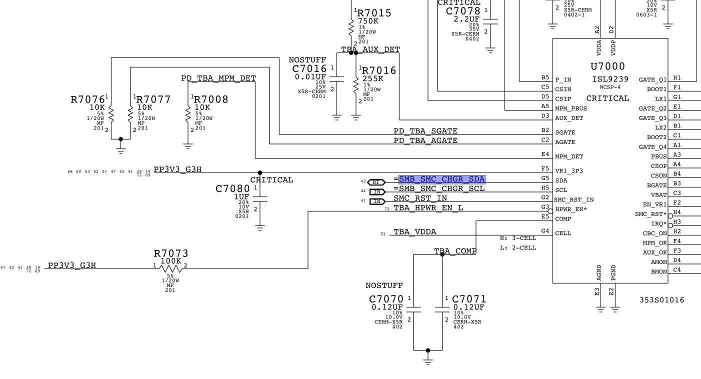

                            If you find the resistance is OK (not too low) on F7000, then check the DC voltage on:
                            SMB_SMC_CHGR_SDA
                            SMB_SMC_CHGR_SCL
                            These are the I2C (SMBUS) communication lines used to configure U7000.

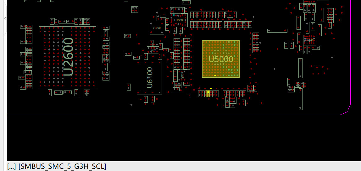

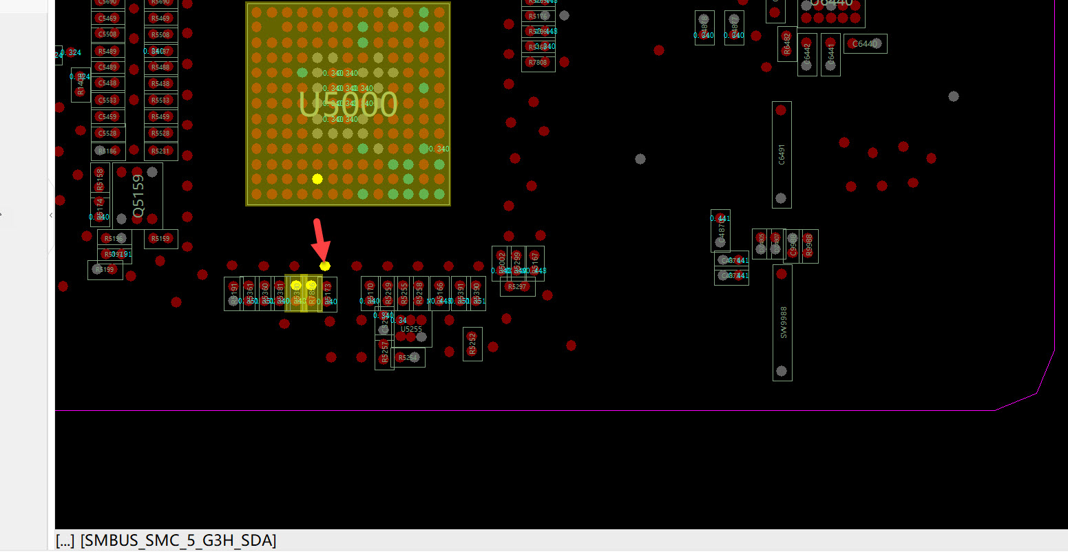

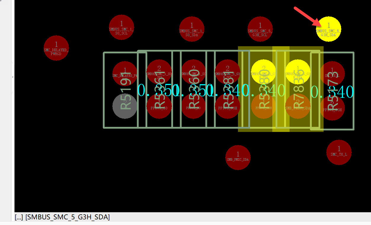

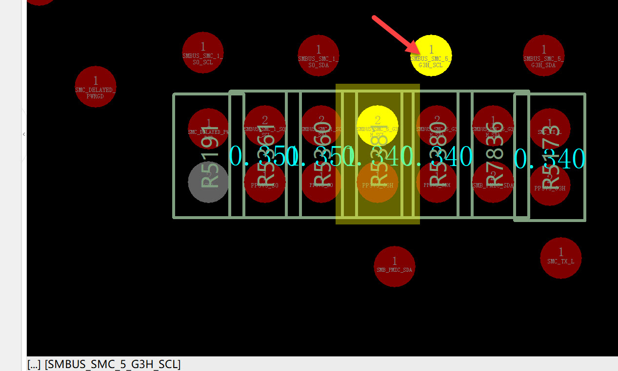

                                The SMBUS (I2C) interface pins are linked to the U7000 regulator.
                                See attached. Proceed with great caution as these are very tiny parts but you should be able to locate a sweet spot to take your measurements.
                                To confirm, your board is 820-00840-A ?
                                See attached on some test pads on this logic board for the SDA & SCL measurements.
                                Attach your external Type C adapter and very carefully check the voltages for the SCL and the SDA pads. Post their values.
