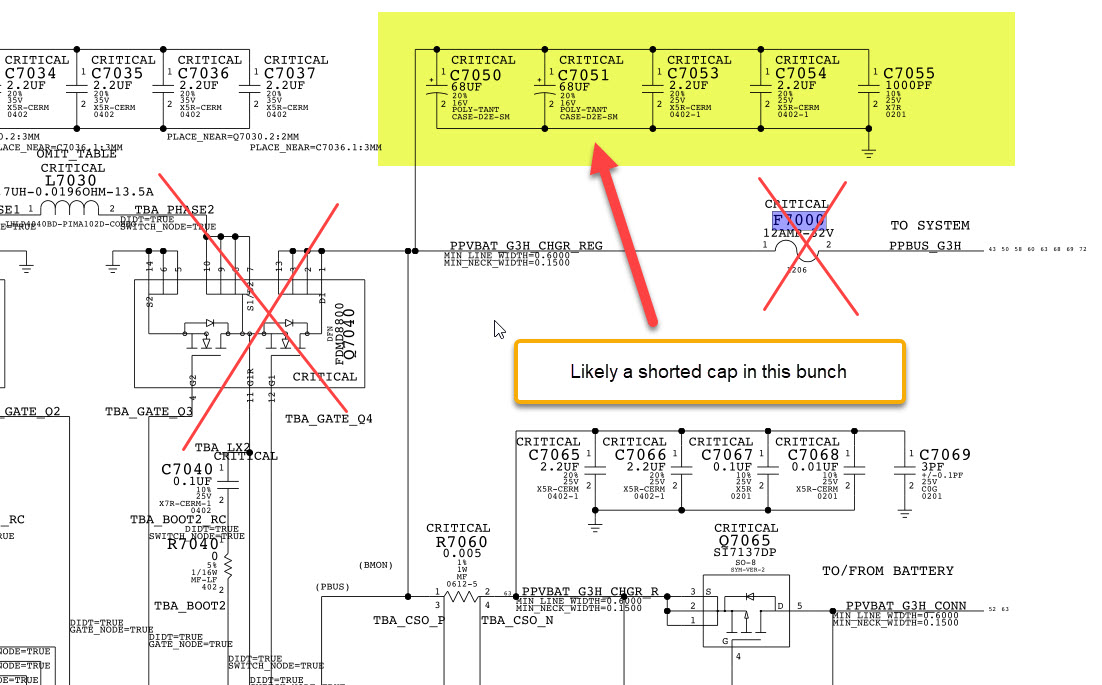

                        PPBUS_G3H on the supply side of F7000
                        Removed Q7040 and short went away. Tested chip, 1ohm resistance between pin 1 (connects to F7000) and 6 (ground).
                        Now PPBUS_G3H is 5v lol
                        • mon2
                          • Dec 2019
                          • 13934
                          #52
                          Re: 820-00840-A CD3215 short
                          See attached. The 'X' mark the parts you have removed.
                          After the above, there is still a low resistance to ground on pin #1 of F7000 (fuse is removed).
                          Is this correct ?
                          If yes, then you have a shorted cap likely in the highlighted group of caps.
                          My bet will be on one of the 68uf caps.
                          Apply flux and remove one of the 68uf (C7050 / C7051) caps. Then check the resistance to ground again to see if the short is removed or not.
                          If not, proceed to remove the next 68uf cap. Post your update.

                            After removing Q7040 resistance jumped to 40mOhm. Replaced with chip off donor board now I get 5V on PPBUS_G3H. 20V 0.04A power connector
                            • mon2
                              • Dec 2019
                              • 13934
                              #54
                              40mOhm
                              Small 'm' will be milli-ohm so this should be 'M' for Mega-ohms. That is good.
                              If the pad # 2 of the F7000 fuse is not with a low resistance, solder back F7000. Test again.
