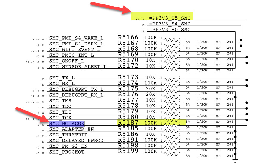

                  Re: 820-00840-A CD3215 short
                  Post the voltages of the attached locations.
                  the SMC_BC_ACOK is not OK.

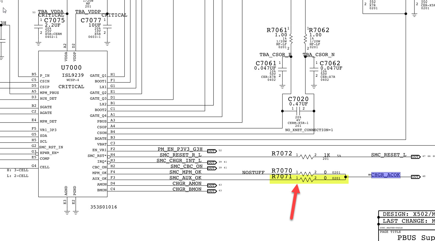

                  • powerblackout
                    • Feb 2018
                    • 109
                    #29
                    SMC_BC_ACOK is 0V at R5187. On the other side of the resistor PP3V3_G3H is 3.4V. I tested the resistor, 100K as the schematic says. U7000 creates this correct?
                    • mon2
                      • Dec 2019
                      • 13940
                      #30
                      Yes. Probe the other side of R7071 and post the voltage. If still 0V, then U7000 believes the AC adapter is NOT OK. This could be due to bad soldering, defective U7000 or that U7000 is unable to gauge if the mated adapter is OK.
                      AUX_DET will be the pin used by U7000 to determine if the adapter is connected or not.

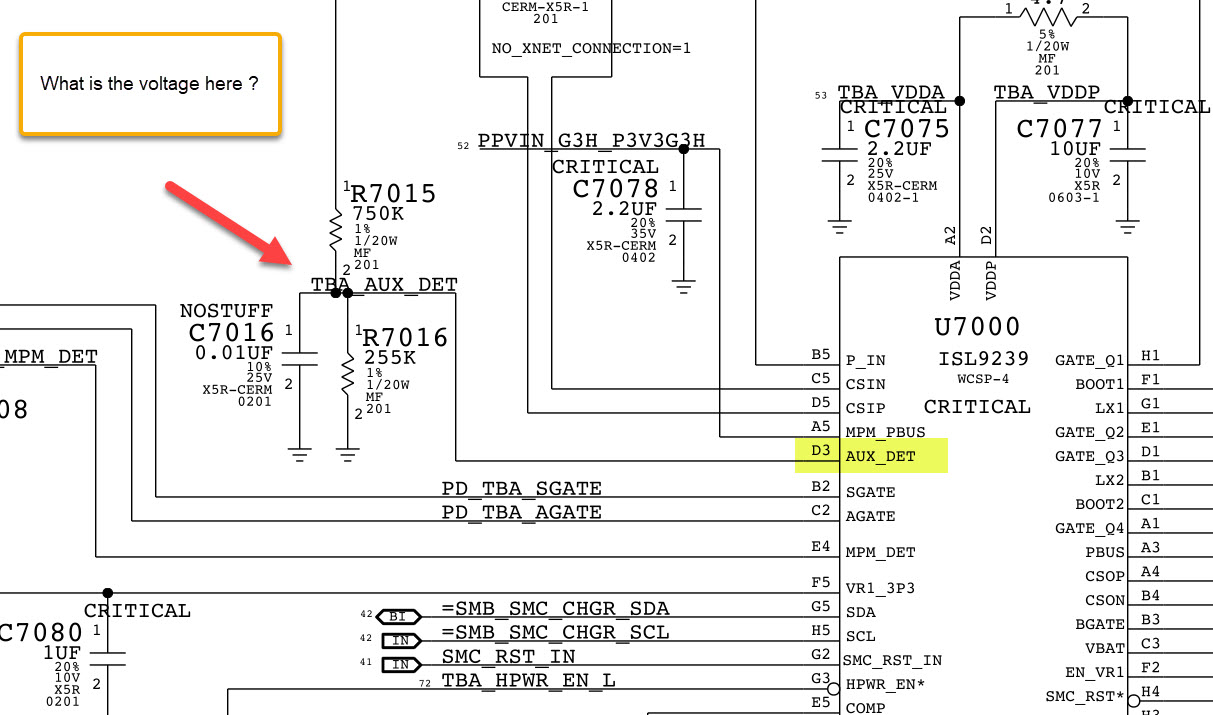

                        #31
                        TBA_AUX_DET is 1.29V
                        R7071 is 0.0V on both sides.
                        Bad soldering on the U7000, or bad soldering where the USB-C connector is?
                        • mon2
                          • Dec 2019
                          • 13940
                          #32

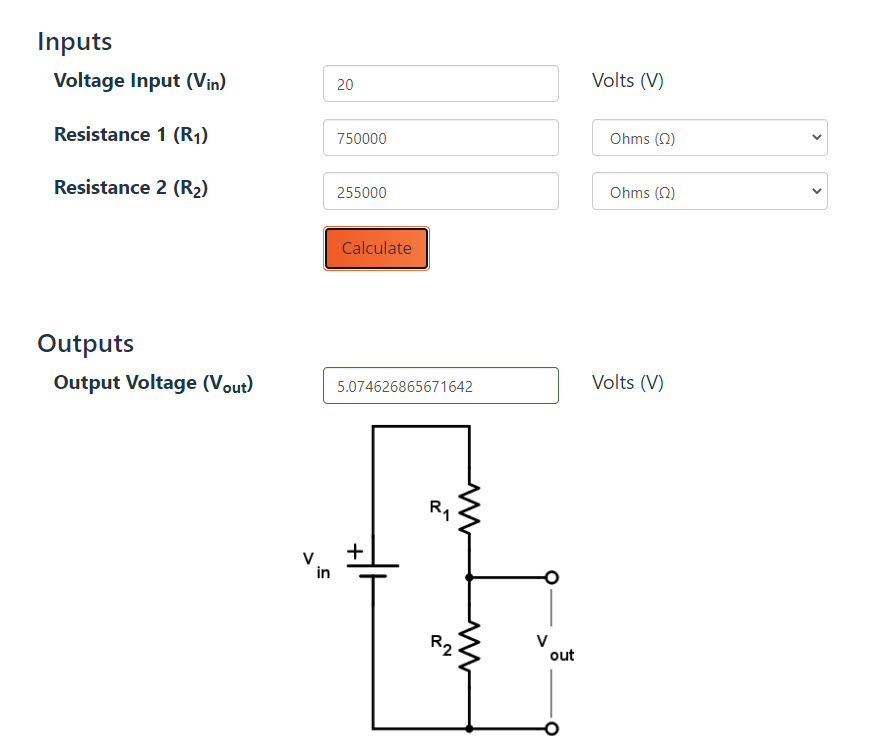

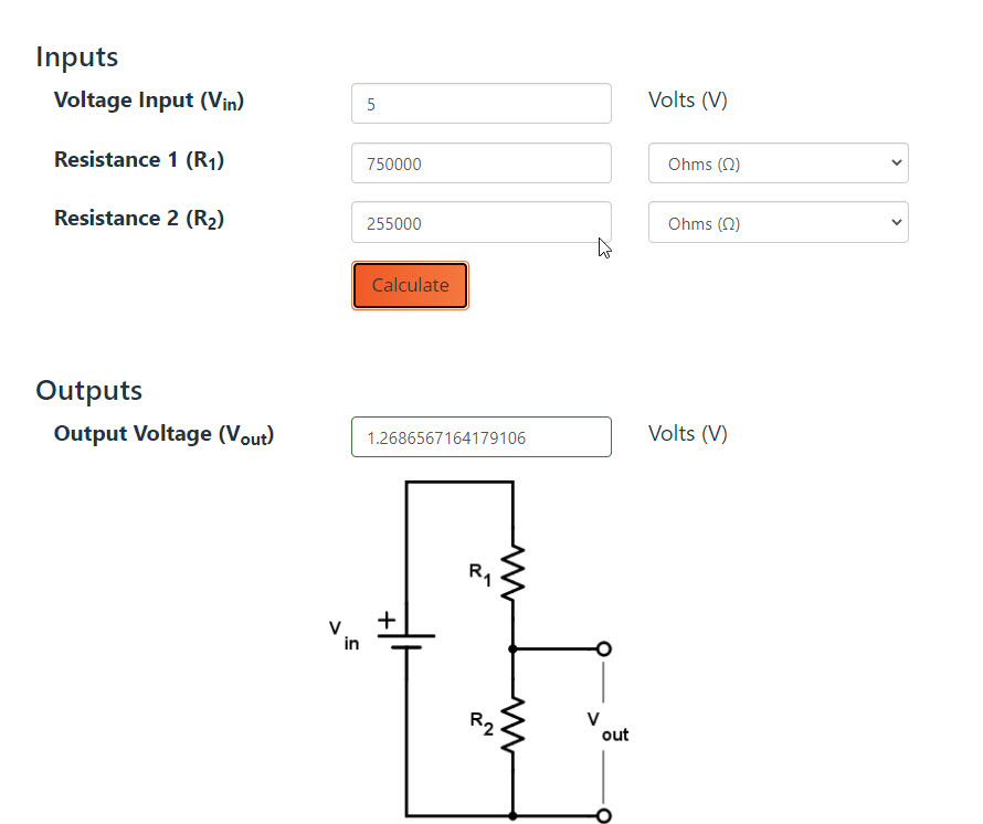

                          The TBA_AUX_DET is a good voltage and confirms that the input from your external power supply is @ 5V0.
                          However, the CD3215 devices need to be working - each one of them to select the 20V before I believe U7000 will output a logic high (~3v3) for the SMC_AUX_OK signal line.
                          While U7000 is not documented, it is most likely an open drain signal.
                          Presently, U7000 is likely pulling this line down to a low to denote the adapter is not good enough due to the 5v voltage.
                          Confirm that SMC_AUX_OK is not soldered low as follows:
                          Remove all power. Meter in resistance mode (2k scale). Check the resistance to ground of R7071 (either side of the resistor is ok).
                          What is the reading ? If the resistance is very low then it is a solder fault underneath the U7000 device.
                          If the resistance is OL (over load) or just a high resistance, then soldering is OK and U7000 does not like the AUX_DET value so it is keeping this line to a logic low value.
                          When the input does get boosted to 20V, the TBA_AUX_DET will respectively bump to 5v0 and then ACOK should be logic high as well.

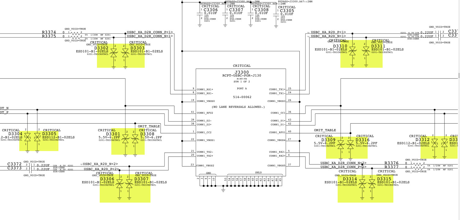

                                #35
                                Focus on each USB C connector(s).
                                For the power delivery to work, the CC1 & CC2 lines must be working.
                                Respectively, each CCx line features ESD diodes. If the ESD diodes are damaged, they could be pulling down the CCx line and causing this malfunction of not reaching the 20V desired voltage.

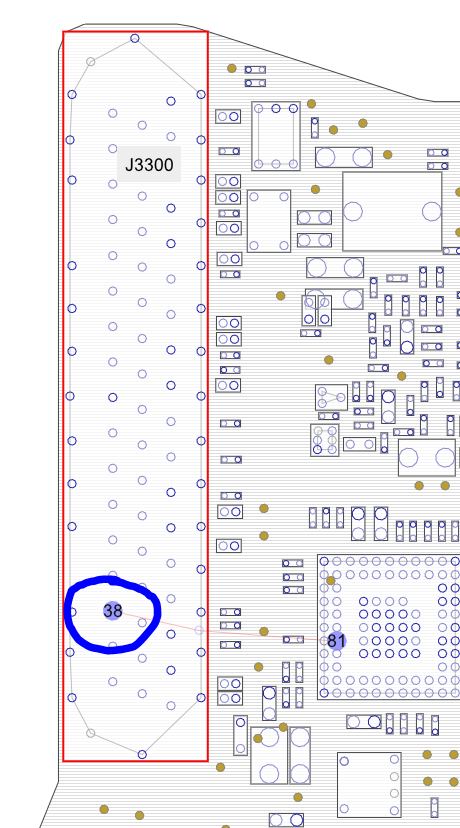

                                Review J3300 - see attached. For each pin with a diode, check and post the DIODE reading checks as follows -
                                REMOVE ALL POWER / NO BATTERY.
                                Meter in DIODE mode.
                                RED meter probe to GROUND (shield is ok).
                                BLACK meter probe to the USB port pin under test (DUT).
                                Post the reading. We are looking for any off readings here that may indicate a bad ESD diode = causing this fault.
                                I think you may have done this before but best to review again - update this thread.
                                Repeat the same testing for the other USB C connector block.
                                Something is causing this fault - perhaps still due to bad CD3215 firmware but need to rule out the physical connector issues.
                                      I'm running through these so far:
                                      D3302 0.328
                                      D3303 0.328
                                      D3304 0L
                                      D3305 0L
                                      D3301 0L
                                      D3308 0L
                                      D3306 0L
                                      D3307 0L
                                      D3310 0L
                                      D3311 0L
                                      D3309 .646
                                      D3316 0L
                                      D3312 0L
                                      D3314 0.11
                                      D3315 0.335
                                      I have the USB-C shield removed on the back in order to get to the diodes there. My multimeter can't reach the actual diode contacts, is it ok to test on the USB connection point? There seems to be a lot of 0L
                                      Is the entire connector defective?
