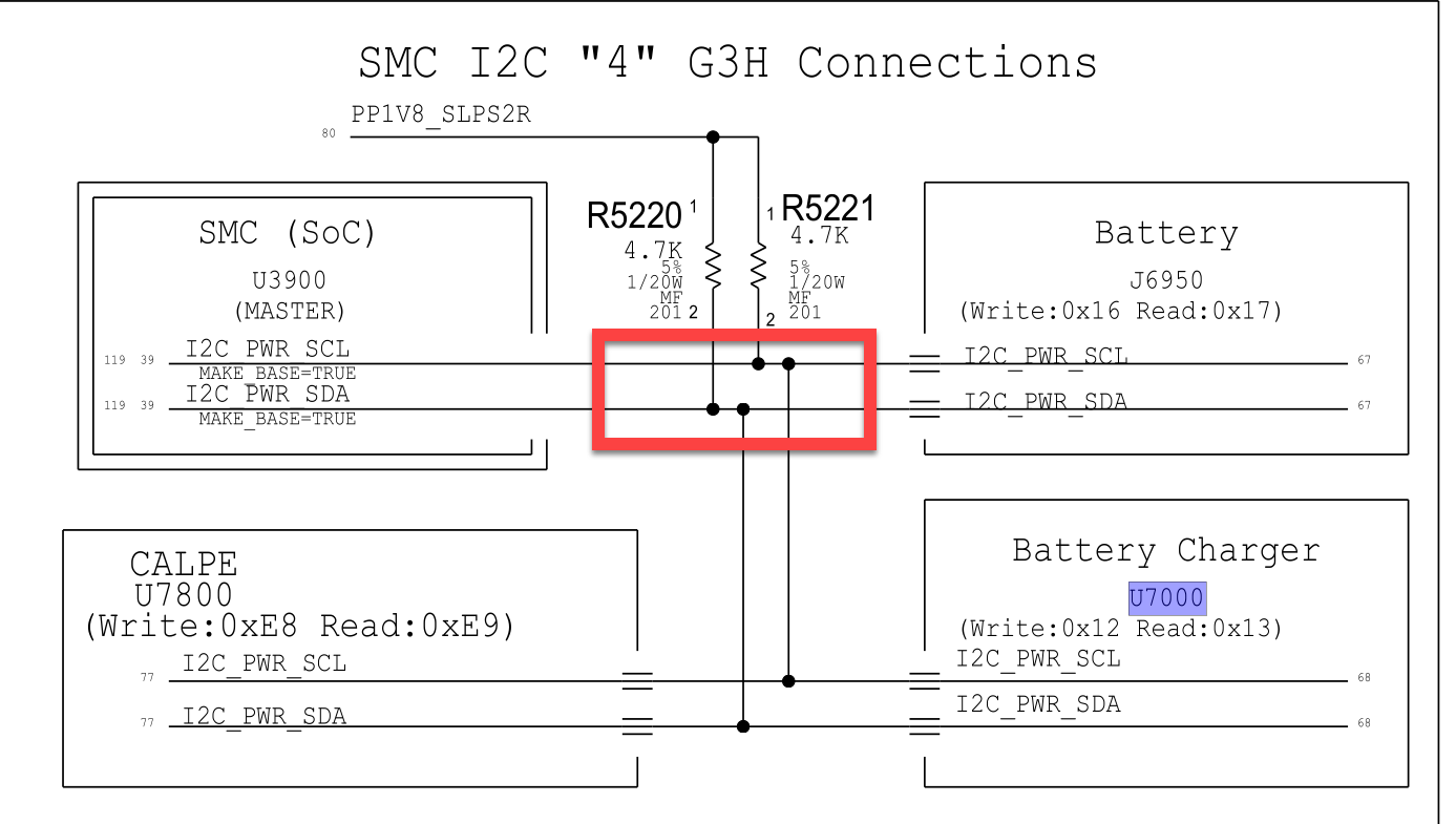

                                  Value of PP3V42_G3H ?
                                  Value of SMC_RESET_L ?
                                  Post the voltage readings for the SMC_I2C SDA & CLK lines.
                                  You may have an issue here since the PPBUS_G3H is @ 12v3 and should be 12v6. This higher value is configured using the SMC_I2C lines.
                                  Are these lines @ ~3v3 for each ? If not, remove all power.
                                  Meter in resistance mode (2k scale). Then measure the resistance to ground for these I2C lines again. Post the values.
                                  If the resistance is not too low then there may be a broken part (likely) or trace between the SMC I2C bus master connection to the U7000 device for at least one of these 2 lines.

                                    #137
                                    Re: MacBook Pro A1990 doest turn on
                                    I dont have this net in my board
                                    Also dont have this net in my board , but i found:
                                    SMC_RSMRST_L = 0v
                                    SMC_SYSRST_L = 0v
                                    Post the voltage readings for the SMC_I2C SDA & CLK lines (I2C_PWR_SCL and I2C_PWR_SDA)
                                    The voltage for those lines is flactuating between 1.784v-1.8v .
                                    i dont think that they are suppose to be 3.3v because they are pulled up to PP1V8_SLPS2R but maybe i am wrong.
                                    the resistnace for I2C_PWR_SCL and I2C_PWR_SDA is 4.9k and 5.2k.

                                      #138
                                      The voltage for those lines is fluctuating between 1.784v-1.8v .
                                      You are so correct. My bad..good readings.
                                      Yes, ignore the other labels - from another logic board.
                                      Post the voltage of CHGR_RST_IN (mates with U7000).
                                      You can measure @ R6940 (check both sides of this resistor).
                                      PS: Will check back later - time to be Arnold movers again - stove time. Bad weather did not allow for it on past weekends.

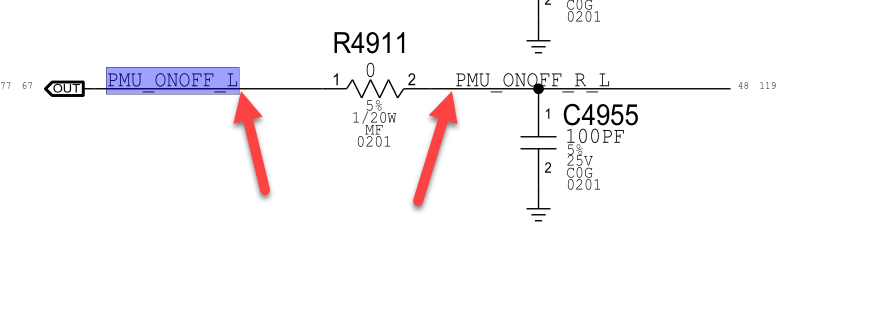

                                        #139
                                        Hey ,
                                        CHGR_RST_IN and CHGR_RST_IN_R are on 0v.
                                        the resistance to ground of CHGR_RST_IN_R is 54ohm.
                                        VDDA and VDDP of U7000 are on 5V.

                                          #140
                                          Hi. No, had to move 2 stoves but it is still too much ice for a safe move so next week..
                                          The above readings are not good.
                                          Pretty sure the reset line to the U7000 is active LOW so this means when the line is LOW (ie. ~0v), then the part will be held in RESET. So this means that the device @ U6940 is also spitting out the 0V.
                                          Confirm that U6940 is being powered. Check the voltage on PP3V3_G3H_RTC_X.
                                          While there, check the voltage of pins 3 & 4 of U6940.
                                          Check that this value matches BOTH sides of R4911.
                                          The resistance to ground of CHGR_RST_IN_R is too low.
                                          Remove the resistor @ R6940 and then check the resistance again for CHGR_RST_IN_R. Is it still very low ?
                                          If yes, remove the resistor @ R6941 and then check CHGR_RST_IN_R resistance to ground again.
                                          Something is causing this line to be with a low resistance to ground. Perhaps U6940 is faulty but try to remove the above parts to see if the resistance on the line can be increased.
