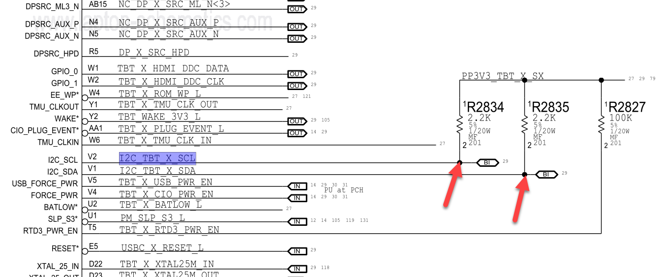

    • mon2
      • Dec 2019
      • 14085
      #102
      Re: MacBook Pro A1990 doest turn on
      Diode readings look ok.
      See attached.
      Post the voltage readings for the I2C lines used to communicate with these 2 - ACE controllers. Meter in DC volts (20v is ok).
      It should be ok to power from the side with the 20v reading and then measure these lines.

          #104
          See attached.
          Hey,
          Both of them are on 3.31v .
          I2C_TBT_X_SCL and I2C_TBT_X_SDA

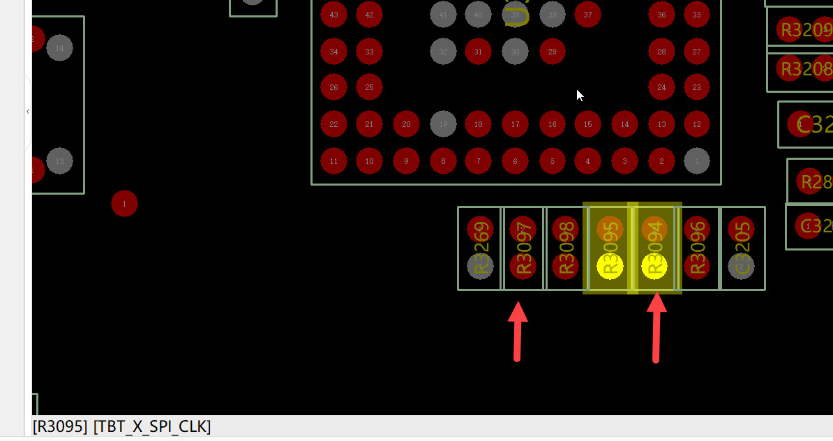

                    #109
                    Since, U3200 was replaced, be sure that the parts near U3200 are present and properly soldered.
                    Specifically, see attached.
                    Post the voltage readings for the highlighted resistors. For this test, use the adapter on the non-working side.
                    Have you attempted to use the power adapter by rotating the adapter connector ? Do try that as well.

                      #110
                      Hello mon2 ,
                      Those resistors are connected to the ROM chip U2890.
                      I measured the voltages once again :
                      R3097 voltage is 0v
                      R3095 and R3094 the voltage is 0.07v.
                      all the components near U3200 are present.
                      yes , i did try to use the power adapter by rotating it, no change.

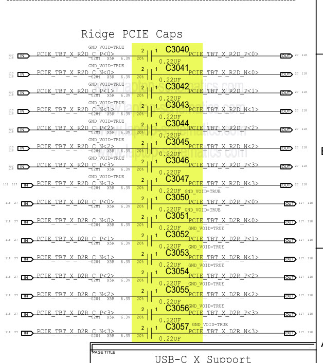

                            #113
                            1) See attached. Be sure that each and every cap that is highlighted is present on the board. These are PCIe DC blocking caps and they MUST be present and without a short. Else the TBT controller for the side that is not working, will fail to function.
                            2) The side that is not working is based on the ALPINE RIDGE controller
                            UB2800 Alpine Ridge TBT controller links to ACE controllers UB3100 & UB3200 = non-working set.
                            and
                            UB0000 Titan Ridge TBT controller links to ACE controllers UB300 & UB400 = working set. Leave this group alone since you can reach 20V on this side.
                            3) Review if any of the PCIe caps are missing - reflow if any one of them looks ugly due to the possible liquid damage. Then, if you feel comfortable, consider to flux and reflow U2800 but it is a large device but should be do-able with enough flux and patience to possibly remove any liquid damaged balls. 'Make it dance' but do not disturb the surrounding parts.
                            Perhaps before you do this, you can try some other simple ideas such as:
                            a) if you remove the flash rom that is not working - do the lines that are reporting to be 0v get pulled up to 3v3 ?
                            b) consider to reflow the non-working flash rom in case it was hit with the liquid. Try this idea first.
                            Just do not want to go down the rabbit hole and nuke something else.
                            I did check the market for a logic board to toy with but they are not cheap so for now, we are without this box in our shop.

                              #114
                              About 2 : Did you saw the photo that i sent about the pads below U3200 , one of the pads #71 which connected to the TBT looks a little bit not fully soldered. the name of the net : USBC_XB_AUXLSX1 , attached the photo once again ( third on the right column ) the first pad is gnd also little bit fishy.
                              About 3 : all the caps are there , no liquid damage.
                              About 3a : great idea will try that.
                              About 3b : also great idea will try it first

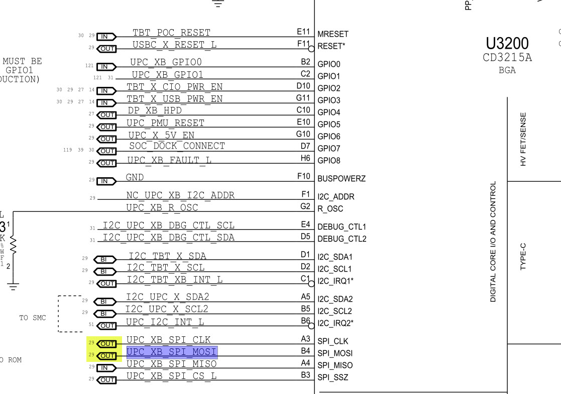

                                    #117
                                    here are the results for U2890 , DC measurements:
                                    Pin1 TBT_X_SPI_CS_L : 3.3v
                                    Pin2 TBT_X_SPI_MISO : 3.33v
                                    Pin3 TBT_X_SPI_ROM_WP_L :0.726v
                                    Pin4 GND : 0v
                                    Pin5 TBT_X_SPI_MOSI: 0v
                                    Pin6 TBT_X_SPI_CLK: 0.07v
                                    Pin7 TBT_X_ROM_HOLD_L: 3.33v
                                    Pin8 PP3V3_UPC_XB_LDO: 3.33v
                                    From this earlier post, pins 5 & 6 have an issue.
                                    From my understanding, the ACE controller @ U3200 is the SPI bus master and the SPI flash is the SPI slave.
                                    So U3200 is driving the CLK and the MOSI (Master-out-slave-in) pins.
                                    Remove all power, meter in resistance mode (2k scale is ok).
                                    Measure and post the resistance to ground for:
                                    UPC_XB_SPI_CLK (R3095, pin #2)
                                    UPC_XB_SPI_MOSI (R3097, pin # 2)
                                    Do you see a low resistance on either or both of these lines ?
                                    If not, perhaps the device @ U3200 is not soldered properly - that is, the balls for these 2 interface pins are not mated with the solder pads on the PCB.
                                    This will explain a high resistance yet no activity on the interface pins that are required to communicate with the SPI flash device @ U2890.

                                        Post the voltage readings for:
                                        1) Each CD3215 LDO rail - if any of the rails are OFF or low then stop searching and need to focus on that ACE controller for damaged parts.
                                        2) PPBUS_G3H
                                        3) U2890 flash - each pin
                                        4) UB090 flash - each pin
                                        5)
                                        I2C_TBT_T_SCL (RB034, pin #2)
                                        I2C_TBT_T_SDA (RB034, pin #2)
                                        6)
                                        I2C_TBT_X_SCL (R2834, pin # 2)
                                        I2C_TBT_X_SDA (R2835, pin # 2)
