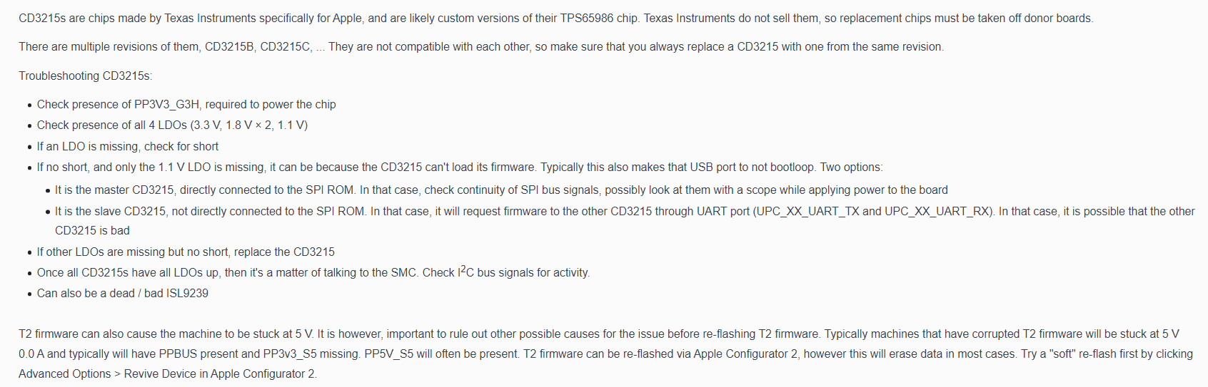

                    Hi. See attached.
                    1) Start with removing all power. Meter in resistance mode (2k scale). Check the resistance to ground for the 1v1 LDO rail for the ports that are not working.
                    What are the readings for each CD3215 1v1 voltage rail ?
                    Next, place the meter in DIODE mode.
                    Then RED METER lead to GROUND.
                    BLACK METER lead to the 1v1 voltage rail. Reading ?
                    Repeat for each CD3215 stuck @ 5v and then for the working CD3215 devices.
                    DO NOT have power to the logic board during these tests.
                    2) Post the voltage reading for PP3V3_G3H.
                    reference:
                    https://repair.wiki/w/Charger_stuck_...nstead_of_20_V

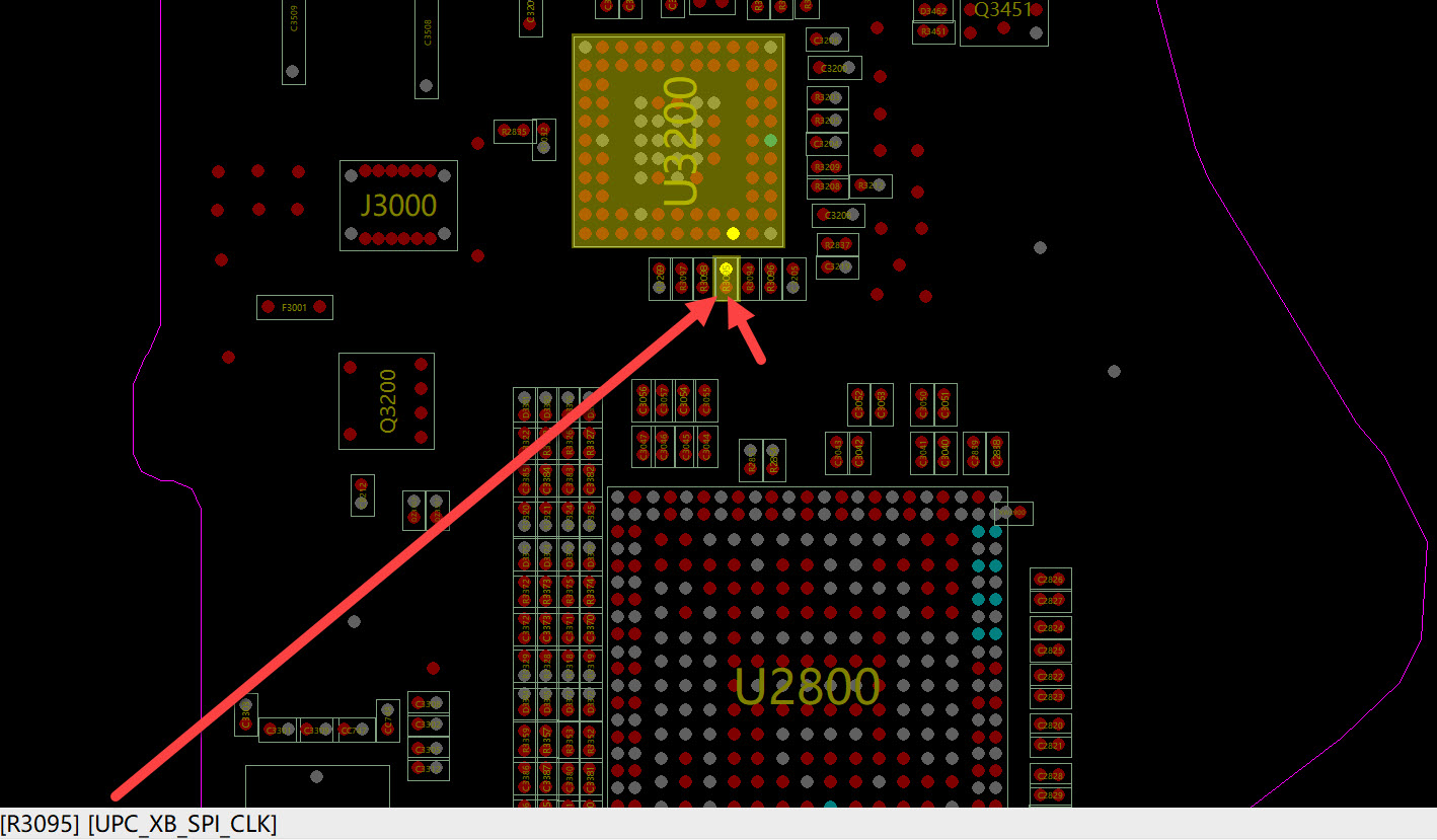

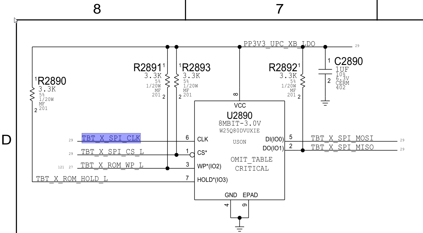

                        Post the voltages on each pin of the SPI ROM used by the CD3215 (non-working) @ U2890.
                        See attached. You can measure at the resistors.

                          #72
                          Re: MacBook Pro A1990 doest turn on
                          Hey @mon2,
                          here are the results for U2890 , DC measurements:
                          Pin1 TBT_X_SPI_CS_L : 3.3v
                          Pin2 TBT_X_SPI_MISO : 3.33v
                          Pin3 TBT_X_SPI_ROM_WP_L :0.726v
                          Pin4 GND : 0v
                          Pin5 TBT_X_SPI_MOSI: 0v
                          Pin6 TBT_X_SPI_CLK: 0.07v
                          Pin7 TBT_X_ROM_HOLD_L: 3.33v
                          Pin8 PP3V3_UPC_XB_LDO: 3.33v
                          thanks

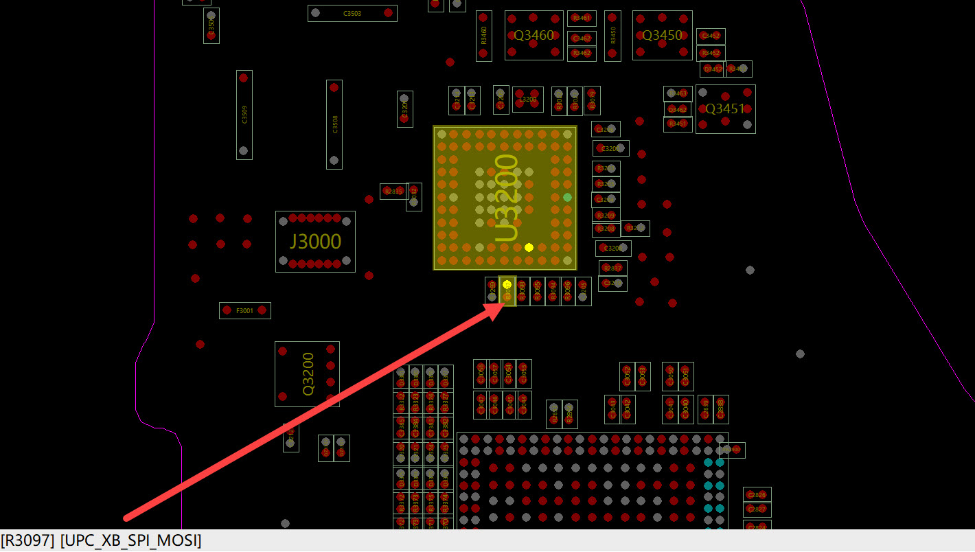

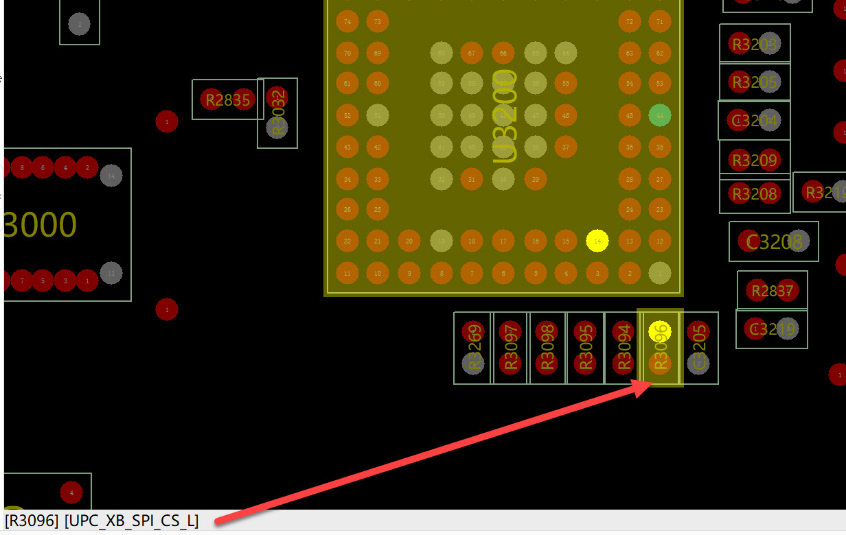

                            Remove all power. Meter in resistance mode.
                            Check & post the resistance of
                            R3095
                            R3096
                            R3097
                            • noz_1974

                                U3100 & U3200 are paired together. They need to function together to allow for the 20V selection. Since this side of the USB C ports is stuck @ 5 volts, there is some issue.
                                From my understanding:
                                1) U3200 is the MASTER controller & U3100 is the SLAVE controller.
                                2) U3200 is looking to extract firmware from an external SPI flash device @ U2890. Presently, your CLK and MOSI (Master Out; Slave in) are showing the wrong voltages. It is possible that they are 0v because the MASTER controller gave up searching for the flash memory chip. TBD.
                                3) After the firmware is extracted from U2890, then this MASTER device will communicate with the SLAVE controller @ U3100 over the UART lines (TX & RX) to send out the firmware details to the slave device.
                                UPC_XA_UART_TX
                                UPC_XA_UART_RX
                                will be used.
                                If any of these fail, then the 1v1 LDO rail will not function.
                                To add to this, the CD3215 itself could be defective. Is your source for the part a known good vendor ? Just asking but basing this concern from assorted postings.
                                4) For the soldering, consider to flux the replaced part well, hot air the part in circles and use tweezers to nudge the corners till the part moves on its own. Then it should spring back into place, naturally. This is a great method to allow for any shorts to correct themselves underneath the BGA device. It is worth a go to try this process.
                                Apply aluminum foil onto the parts you wish to protect. Be sure there is no power to the board. Or use kapton (polymide) tape for the same purpose.
                                5) It is good to have the 20V on the other ports and that may be all we need to move forward, for now. Perhaps others have additional feedback.
