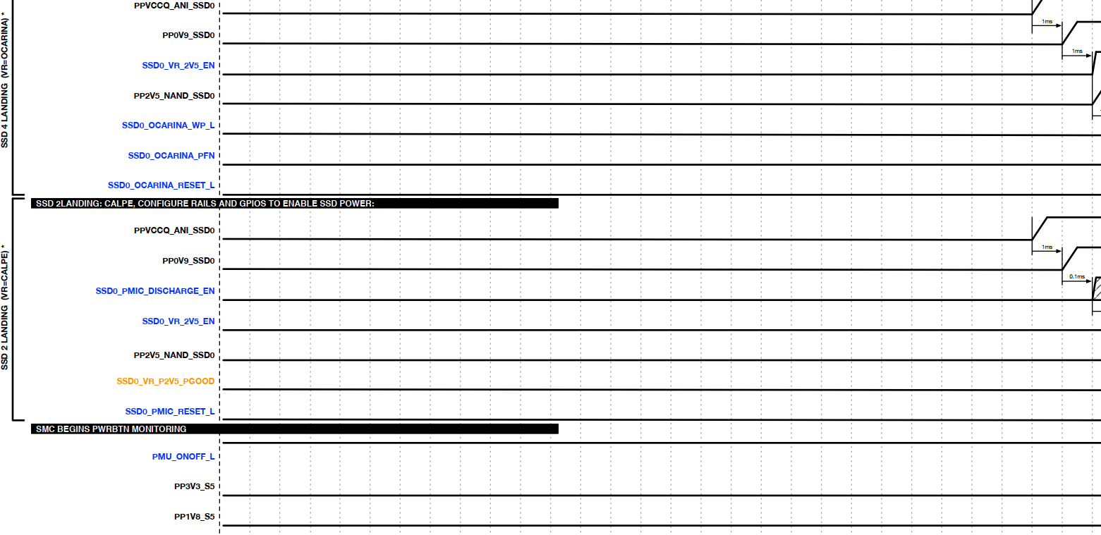

                                  Re: MacBook Pro A1990 doest turn on
                                  Hey mon2 ,
                                  I also followed the power rail sequence from 820-01598 data sheet that i found.
                                  I have all the rails up to the stage of : SMC BEGINS PWRBTN MONITORING.
                                  THE PMU_ONOFF_L is 3.38v but :
                                  1. PP3V3_S5 is 1.329v
                                  2. PP1v8_S5 is 0.44v.
                                  • mon2
                                    • Dec 2019
                                    • 14244
                                    #97
                                    Remove all power.
                                    Measure and post the resistance to ground for each of these rails.
                                    • noz_1974
                                      • Nov 2021
                                      • 71
                                      • Israel
                                      #98
                                      Hey @mon2,
                                      I decided to check and compare QB400 and Q3100 and Q3200 .
                                      Those chips as i see it are responsible to deliver 20v to the board ( PPDCIN_G3H).
                                      the results on the working USB C , QB400 :
                                      1. UPC_TB_GATE1 : 26V ( FROM CD3215)
                                      2. UNCONNECTED
                                      3. UNCONNECTED
                                      4. UPC_TB_GATE2 : 22.5V ( FROM CD3215)
                                      5/6/7 : PP20V_USBC_TB_VBUS: 20.37V
                                      8: PPDCIN_G3H: 20.37V
                                      the results on the un working USB C , Q3100 :
                                      1. UPC_XA_GATE1 : 10.83V ( FROM CD3215)
                                      2. TP_Q3100_DRAIN: 5.11 V
                                      3. UNCONNECTED
                                      4. UPC_XA_GATE2 : 8.27V ( FROM CD3215)
                                      5/6/7 : PP20V_USBC_XA_VBUS: 5.11V
                                      8: PPDCIN_G3H: 5.11V
                                      the results on the un working USB C , Q3200 :
                                      1. UPC_XB_GATE1 : unable to measure ( FROM CD3215)
                                      2. TP_Q3200_DRAIN: 5.11 V
                                      3. UNCONNECTED
                                      4. UPC_XB_GATE2 : 6.87V ( FROM CD3215)
                                      5/6/7 : PP20V_USBC_XB_VBUS: 5.11V
                                      Is it helpful in any way?
