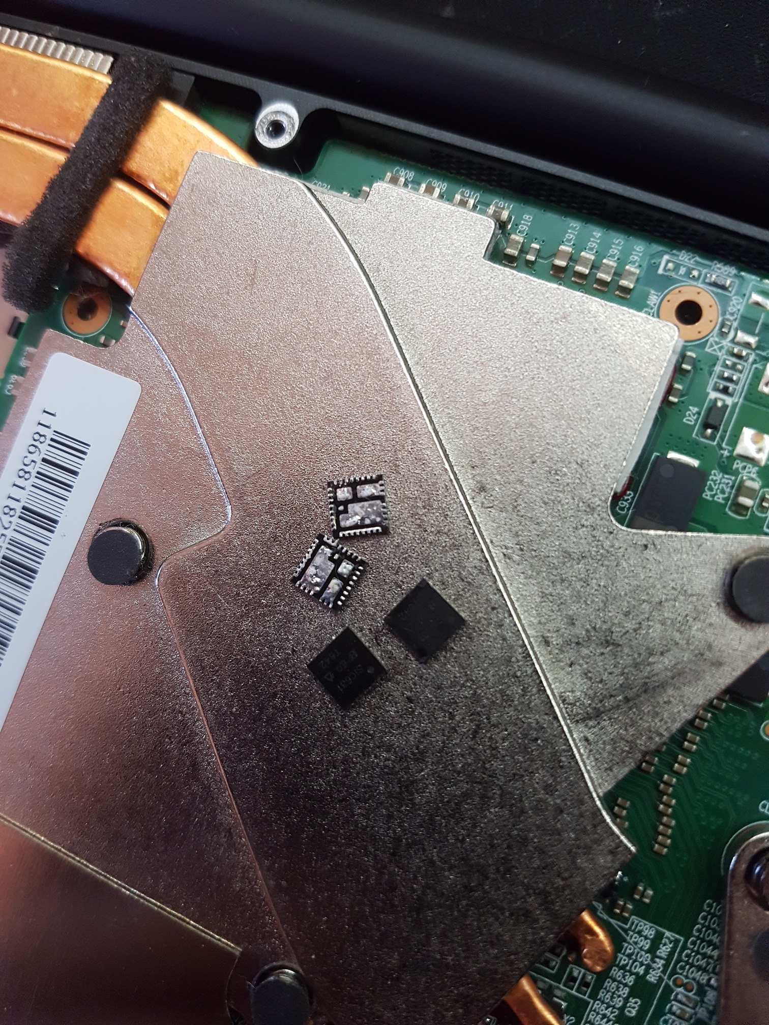

    Hello guys!

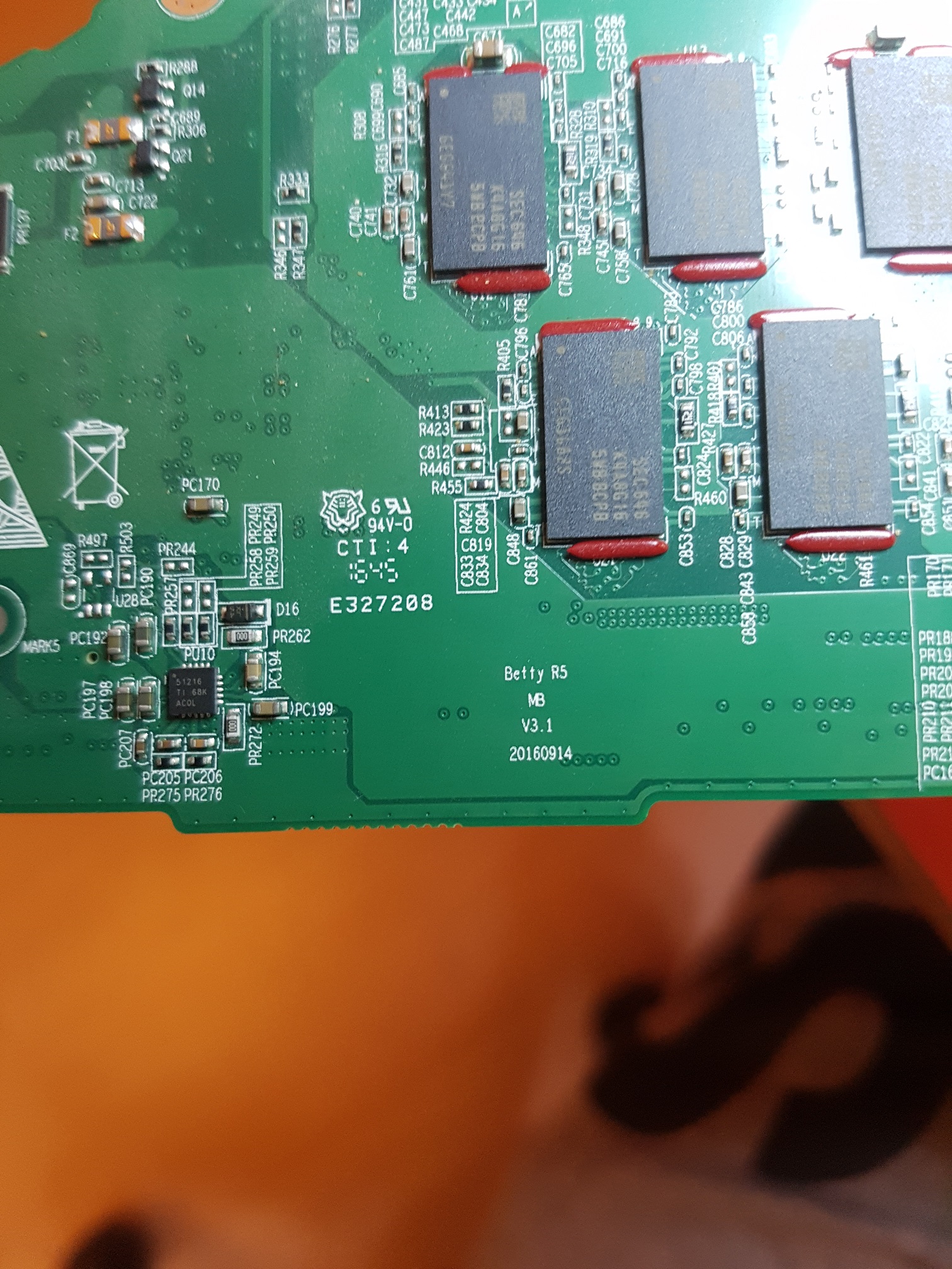

    I have a Razer Blade 2016 Model RZ09-0195 motherboard Betty R5 V3.1

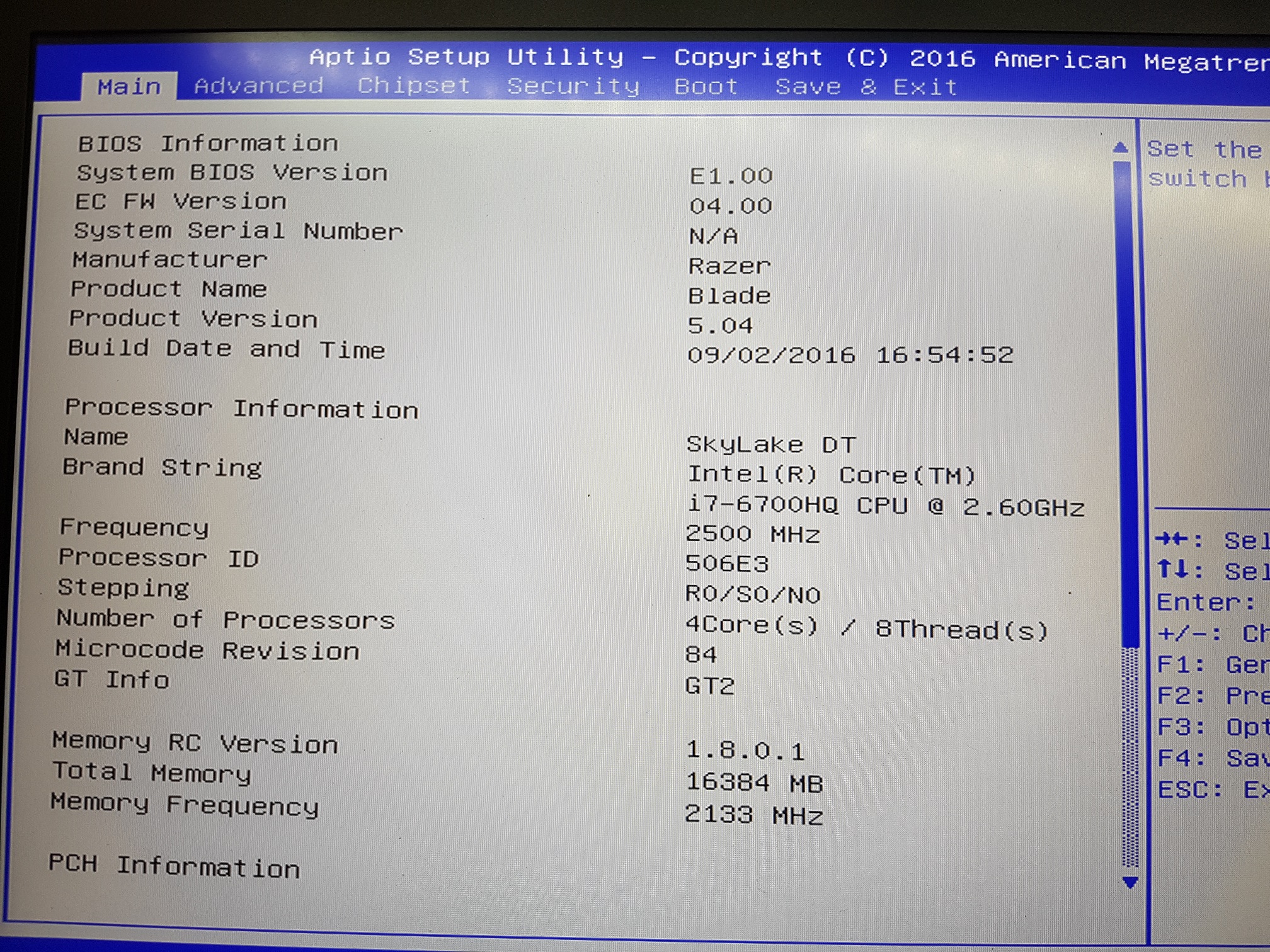

    Laptop turns on, I can get to the BIOS screen, but after it just hangs in black screen.
    Visual inspection nothing, board is factory.
    Tried another Bios dump, same thing. I see CPU activity at the start, but when I try to boot USB stick, it disappears and hangs in black screen.
    I measured just now CPU vcore, when turning on or when on bios I see 1.10~0.9V, but after POST it goes to 0V when back screening.
    This laptop has the SIC631 mosfets and the Intersil 95855A controller.
    Should I replace these SIC631 Mosfets?
    Anyone with some experience with these boards?
    Thanks in advance!

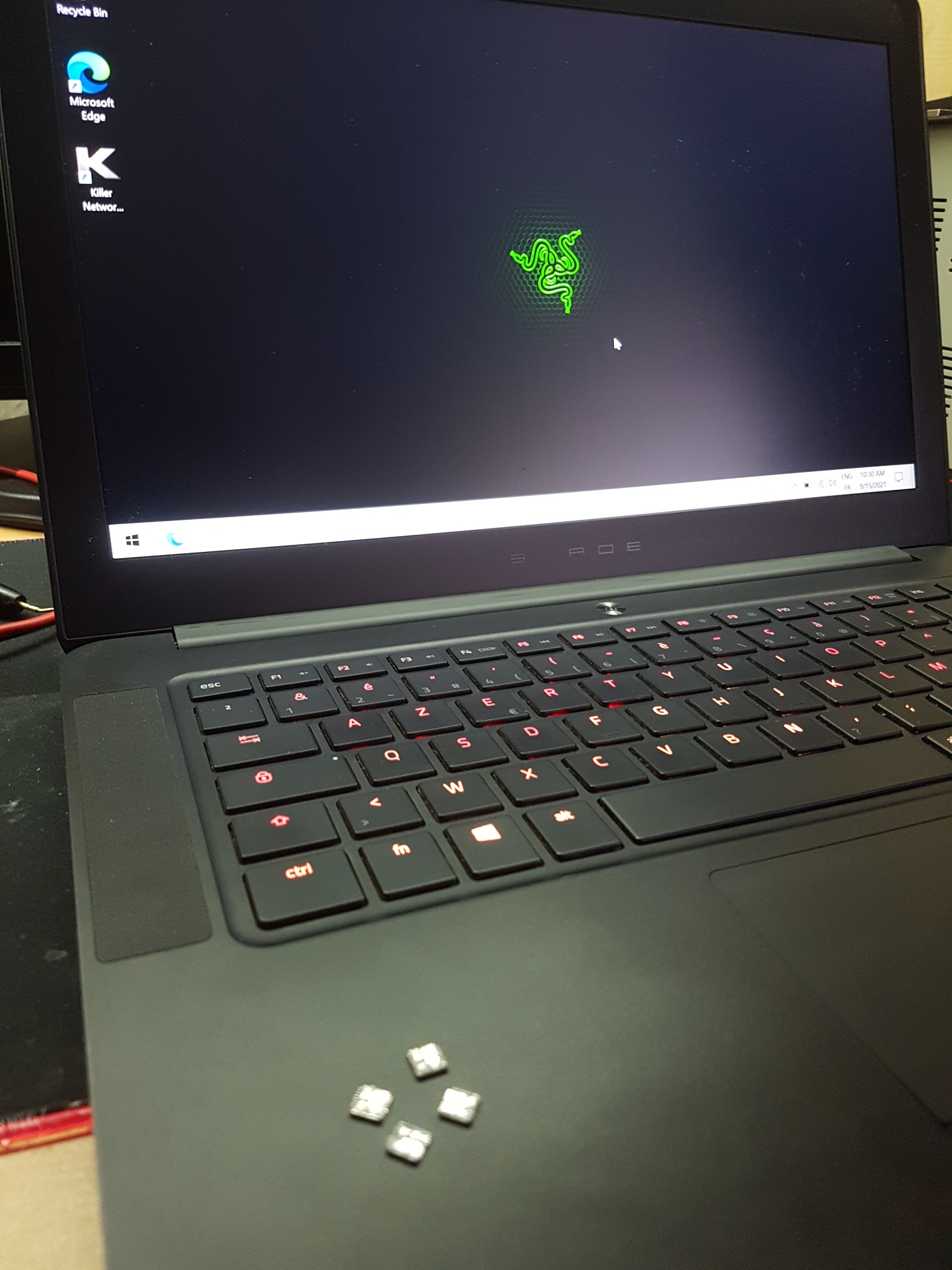

          Well since these boards are known for CPU power circuitry failure, I went ahead and changed all CPU mosfets, the SIC631... and machine now works 100%!
          So when CPU was asking for power after bios screen, the ICs were not able to properly switch and deliver power... solved.
          Just as reference in case someone finds themselves with similar issue.

                    That actually worked. In my previous post (the one before this), I said I had changed only 2 SIC631 for VCORE. Well, now I just changed the other 2 as well for VCCGT (Graphics).
                    And hey presto....I can not boot an OS
                    Thanks dude for the tip about changing all 4 MOSFETs. Although I reckon I only needed to change my VCCGT ones from the get go.
