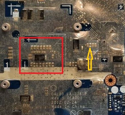

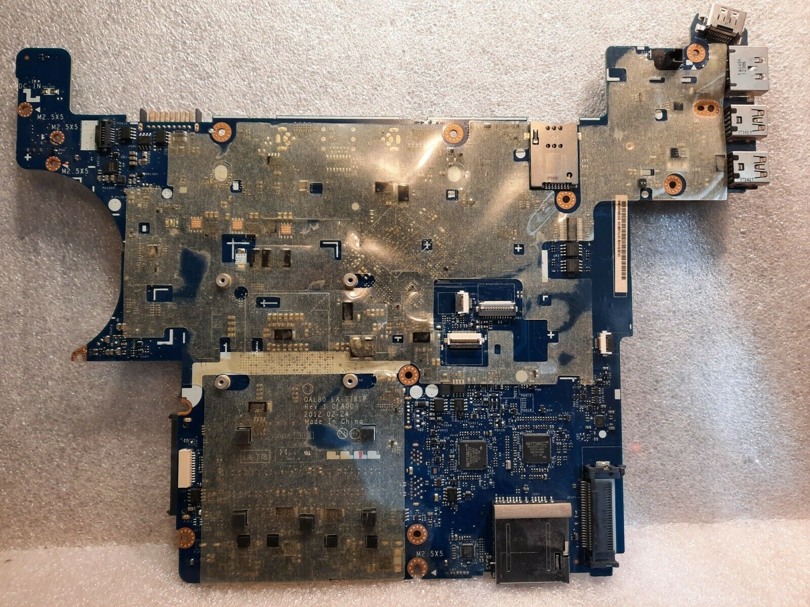

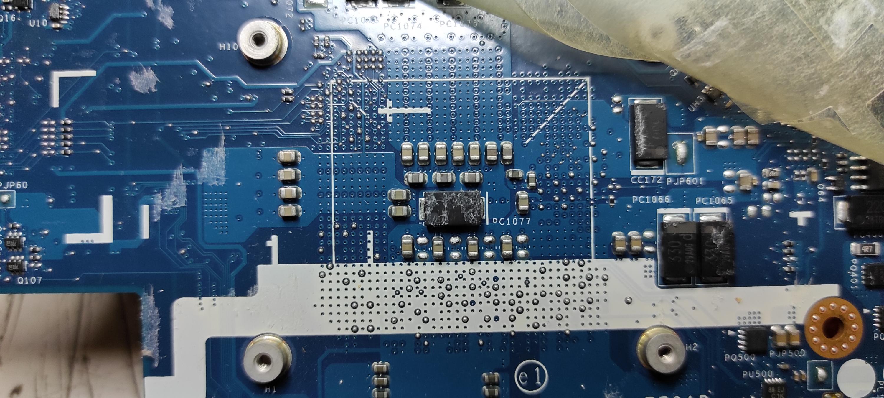

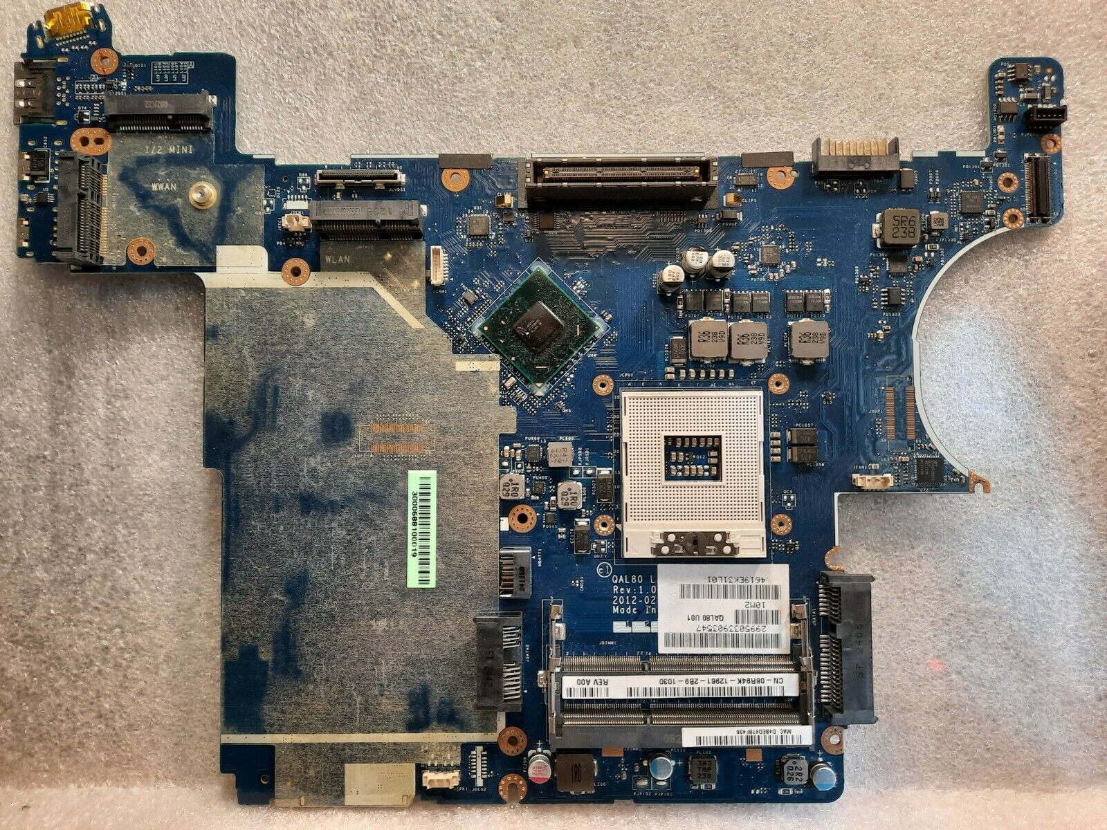

                                Re: Dell E6430 shortcircuit
                                It is actually labelled, Capacitors are sometimes also labelled as "PC". In your case that would be PC1077. And no, I don't think its a short circuit. Measure its resistance and report back. +VCC_Core will have a low resistance because of the CPU.
                                Also, post a picture similar to post #13 but without the plastic, I saw a cap that looks a bit odd (not sure if its because of reflection, glue or dirt). Maybe you could take a closer look.
                                Edit:
                                Nevermind, the capacitor is not present looking at picture in post #15.
                                  Edit:
                                  Resistance in all capacitors there is 3.2Ω
                                  PC1077 in the center is tantalum cap, i know. I meant about all these around it, are these caps too?
