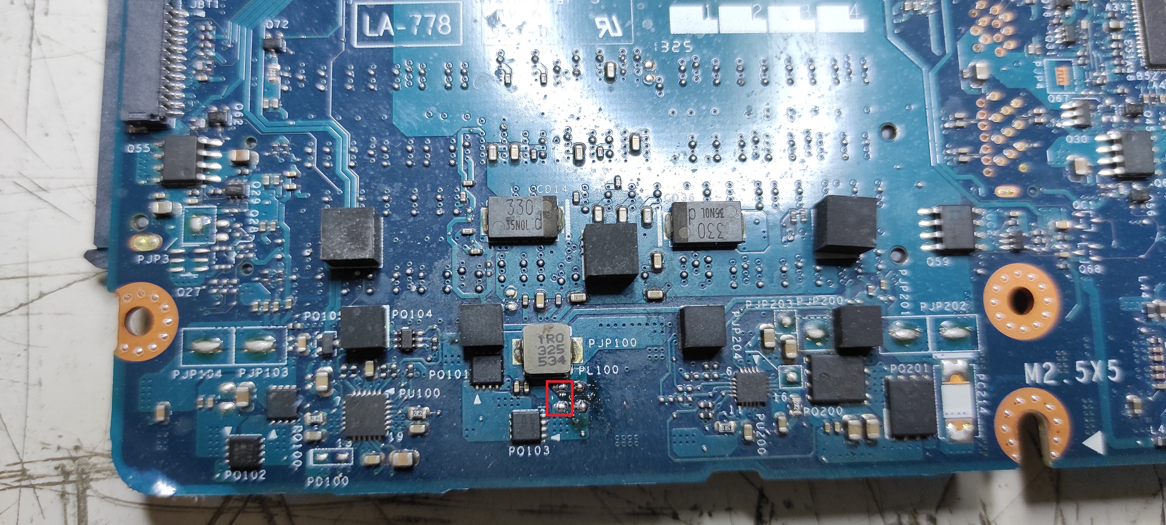

      Re: Dell E6430 shortcircuit
      Where was the shorted cap? Does it have any reference that we can use to locate it in schematic? If not, provide a picture.
      Previously you removed the CPU, it could be that dust got on the contacts. Remove the CPU and give it a good blow with compressed air. Also check if there is no broken/bent pins on the CPU itself.
      Sometimes motherboards are picky and wont post without a good CMOS battery. Check yours if present or put a known good one and try again.
      As for your BIOS, try cleaning the ME region. If you don't know how, post your original dump in the BIOS section and someone will help you.
        #43
        The cap is in bottom of the motherboard (check marked area in attachment)
        I think the cap is 0.01uF, not sure though.
        I tried another CPU, no luck.
        I tried 2 bios upload in forum and are guaranteed working but i was not lucky either in this case.
        What do you think about the cap?

          Measure voltage on all the coils and report back. Check if the power button is triggering properly by measuring voltage on it. It should be 3.3V unpressed, goes to 0V when pressed then back to 3.3V when released.
            #45
            Just noticed the PL301 is broken and missing from MB.
            Perhaps that's the problem or not critical component?
              #46
              What do you mean by broken? Physically or bad solder? Is there any voltage coming out?
                #47
                Physically broken, no idea how and when.
                No voltage on either pins.
                Switch has 3V and 0v when i pressed it but the MB remains on.

                  #48
                  Replace it if its broken and check again. Voltage present and stable on other coils?
                    #49
                    Which ones you want to measure?
                      #50
                      All of them but deal with the broken PL301 first. Check if PU300 is being told to turn on also, measure voltage on pin 5.
                        #51
                        PU300 has 3.3v on pin 5.
                        I'll replace the broken PL301 with one from the donor mb.
                          #52
                          OK great, hopefully PL301 is the only issue.
                            #53
                            Yes with PL301 the switch worked properly again, switch on and off.
                            I'll try it with screen to make sure everything works good and report back.
                              #54
                              All work, thank you very much mate!
