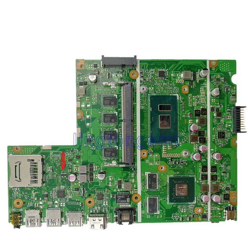

                    3- Can you please post a pic of that R5852 @Spider1211? Because i have been searching for it with a boardview but seems like there are some diferent things between my board and the boardview.

                        I no longer have the board with me, but here is a labeled picture from internet. Use it a guide with boardview, its the 3VA_DSW_ON signal.
                        For the random freeze & black screen, it could also be the onboard RAM is failing. Try to disable it and test with external RAM modules. Also check what Sametbey suggested.

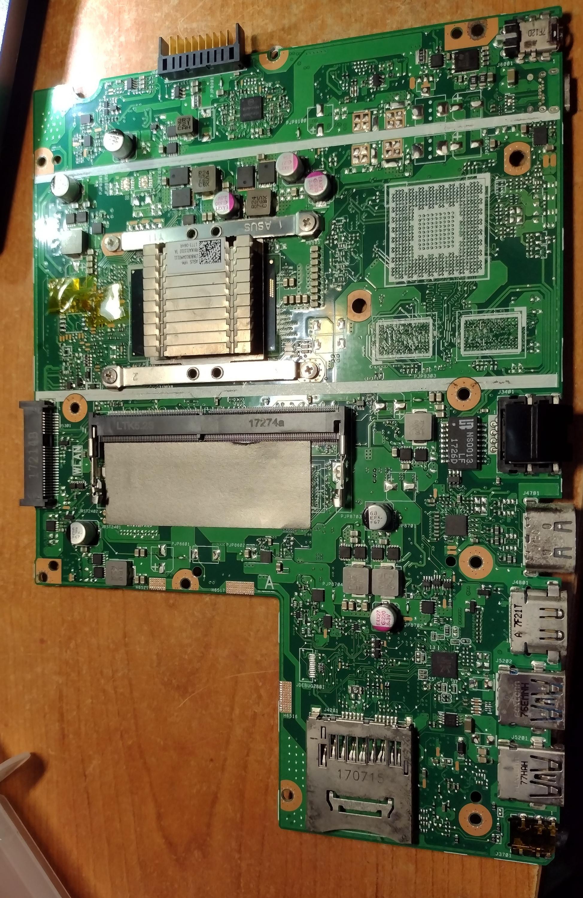

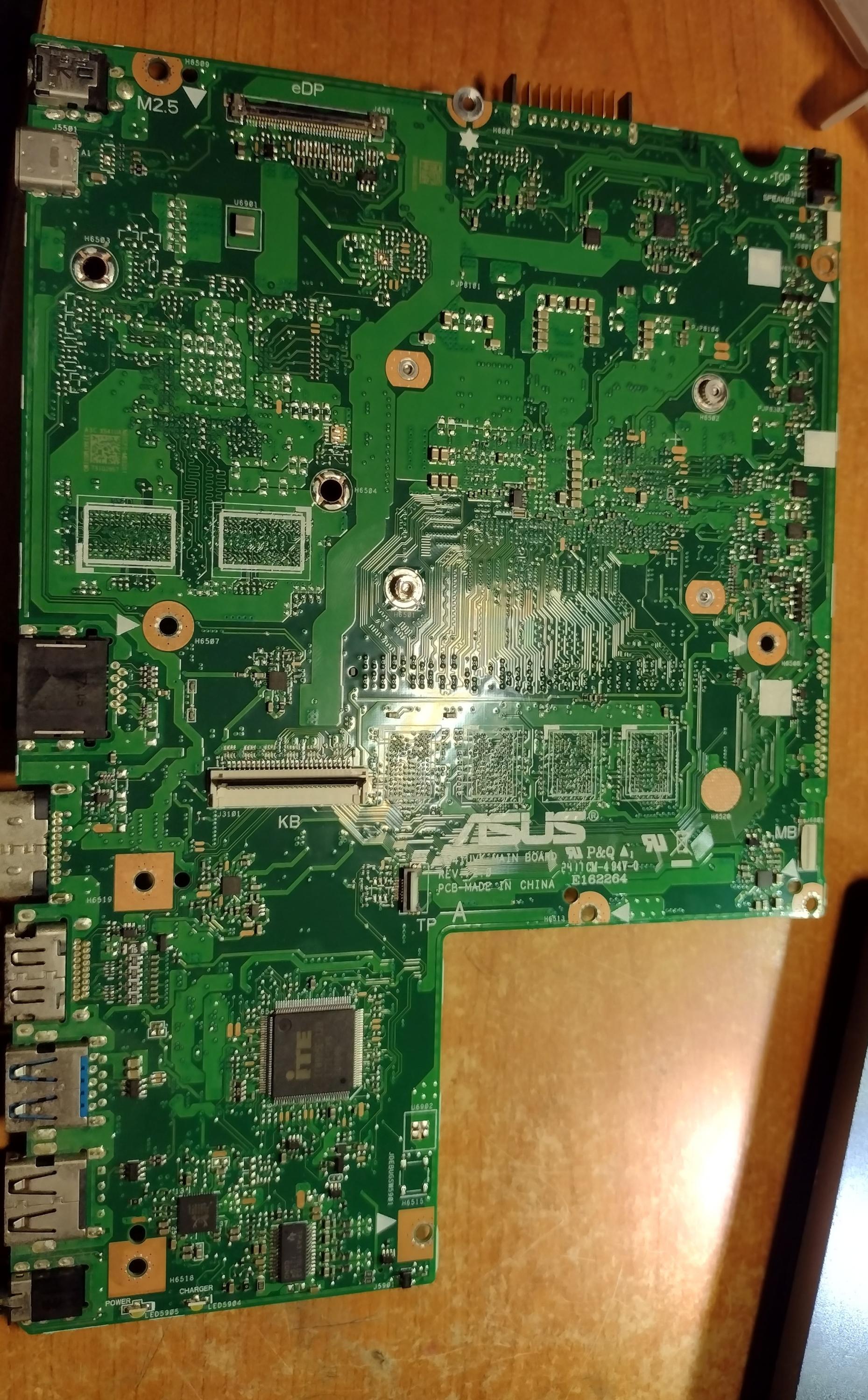

                          Re: Asus X541UVK Rev 2.0: random freezes, black screen, no boot
                          Hi! I finally got the motherboard working perfect at the moment. I have done another manually clean ME attemp using another ME version and now seems that it is working OK. Even the HDMI works when it was not working.
                          One weird thing in this board is that there are no BGA rams (only the pads are present but not the RAM sticks) and it is stock and rev. 2.0. I used the same boardview @Spider1211 but the side of my board is different that's the weird fact. Even the chipset that it is present in the attached photograph of the motherboard is not present in mine. I found the resistor and the value was OK!
                          I will attach the bios file i have edited with ME Injector, it is "Stock" status right now and was the solution of the problem on my motherboard.
                            Can you post a picture of your board? Top and bottom side.

                                @Spider1211 Sure!
