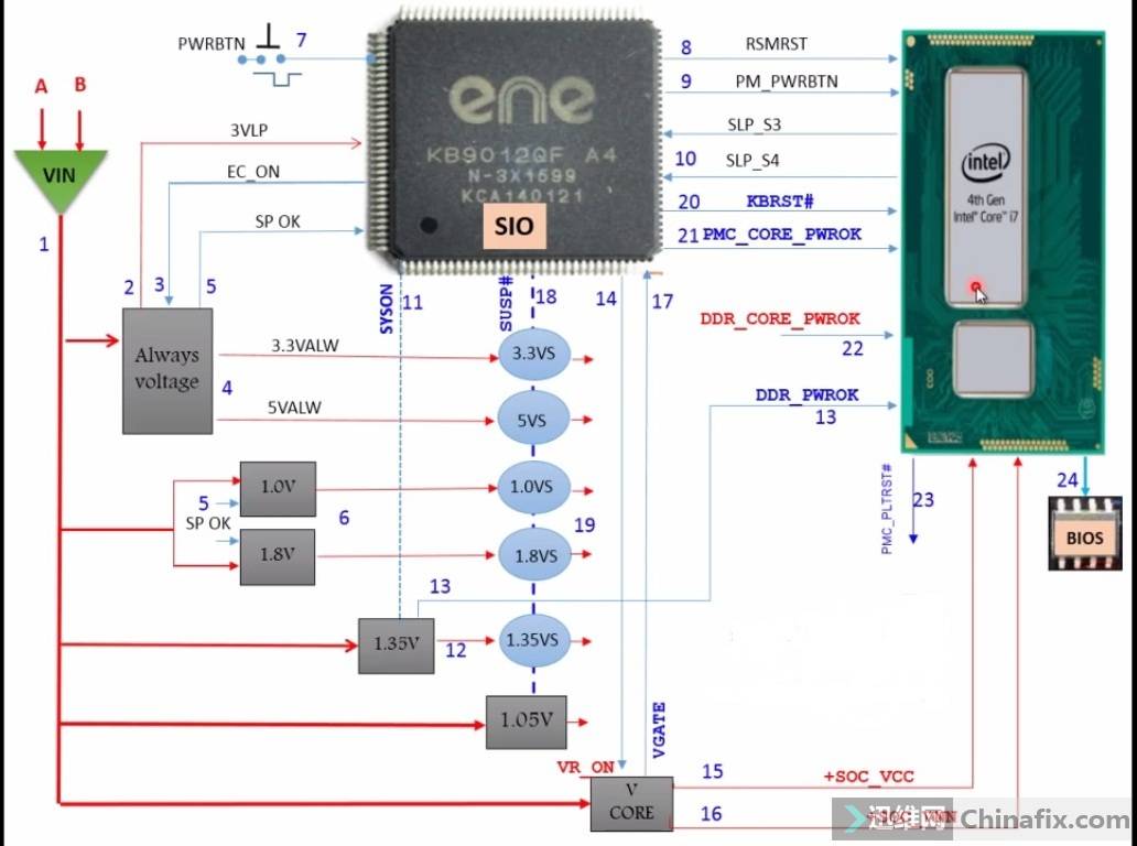

                now I have another problem and I have noticed that the signal PM_SLP_S4 # I have it in 3V
                According to the diagram, pressing the button goes down to 0v but immediately goes up to 3v
                where could i check?
                • Sametbey
                  • Jan 2021
                  • 229
                  • Turkey
                  Re: Cedar_Intel_MB 13269-1 5V_S5 0V
                  1 AC_IN plugs in and PU4404 opens, sends AC_OK.
                  2 PU4503 sends 3VREG signal to the IO chip.
                  3 KBC 14 pin S5_ENABLE signal sends to PU4503. 6 20 + 3V
                  4 PU4503 3V_PWR and 5V_PWR generates
                  5 KBC power button. It starts with
                  and other steps.

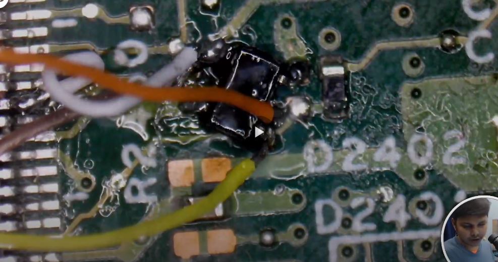

                    I found a video on youtube, which has the same problem and he fixes it like the attached image,
                    right on pin 21 where the PM_SLP_S4 signal from the KBC comes out
                    https://www.youtube.com/watch?v=hOTahvbWTcI
                    • Sojke
                      • Apr 2017
                      • 131
                      • Serbia
                      Where do RED and YELLOW wire go to??
                      • Sojke
                        • Apr 2017
                        • 131
                        • Serbia
                        Why the hell did he connect a wire to NC??
