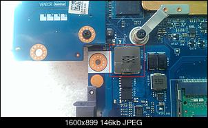

    DELL 15 3537 La-9981p UMA enable .
    8 beeps!..i change screen and screen cable too...still 8 beeps...any idea please !
    I remove PL 802 / Pl 1101 /Pl 800 still 8 beeps !
    any idea..Thank you

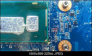

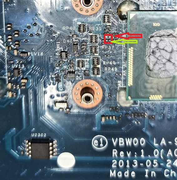

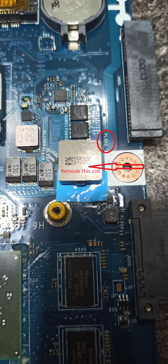

            Re: DELL 15 3537 La-9981p UMA enable .
            To convert this mb to UMA-only two steps required.
            01 Remove PL802
            02 Shift RC99 to RC100(located near PCH part of SOC).
            I'm attaching pic for same but they are not very good quality but will still help you.

              THank you mcplslg....but still 8 beeps!!
              PL 802 / Pl1101 / PL 800 removed.
              pjp 1300 / pjp 1301 / pjp 600 / pjp 1101 / pjp 1100 open jumper
              RC99 moved to RC100.
              Flashing bios with different dump from website and dell site.
              Always 8 Beeps..any idea

                    • my workshop
                    Good news , the conversion works ..but only at external display via HDMI.
                    without it 8 beeps..maybe the LVDS cable is the issue..i will try with another one to confirm.
                          01 Remove PL802
                          thanks its working fine
                          new clear image i am posting here
