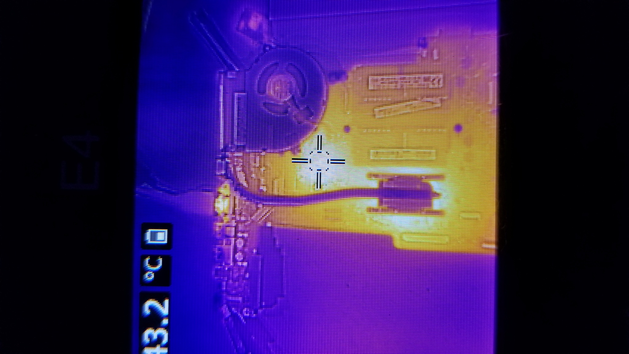

                I'm looking at the mobo, with a thermal camera and I don't really see any hot spots, other then the CPU and the 1.7V Mosfet.
                At each coil, there is a voltage, 1.05V, 1.35V, 1.7V, 3.3V, 5V. 19V rail is there. On coil has power at the startup, but very fast starts to drop. I'm guessing, it's that the battery charging power source and since I don't have a battery, it stops charging.

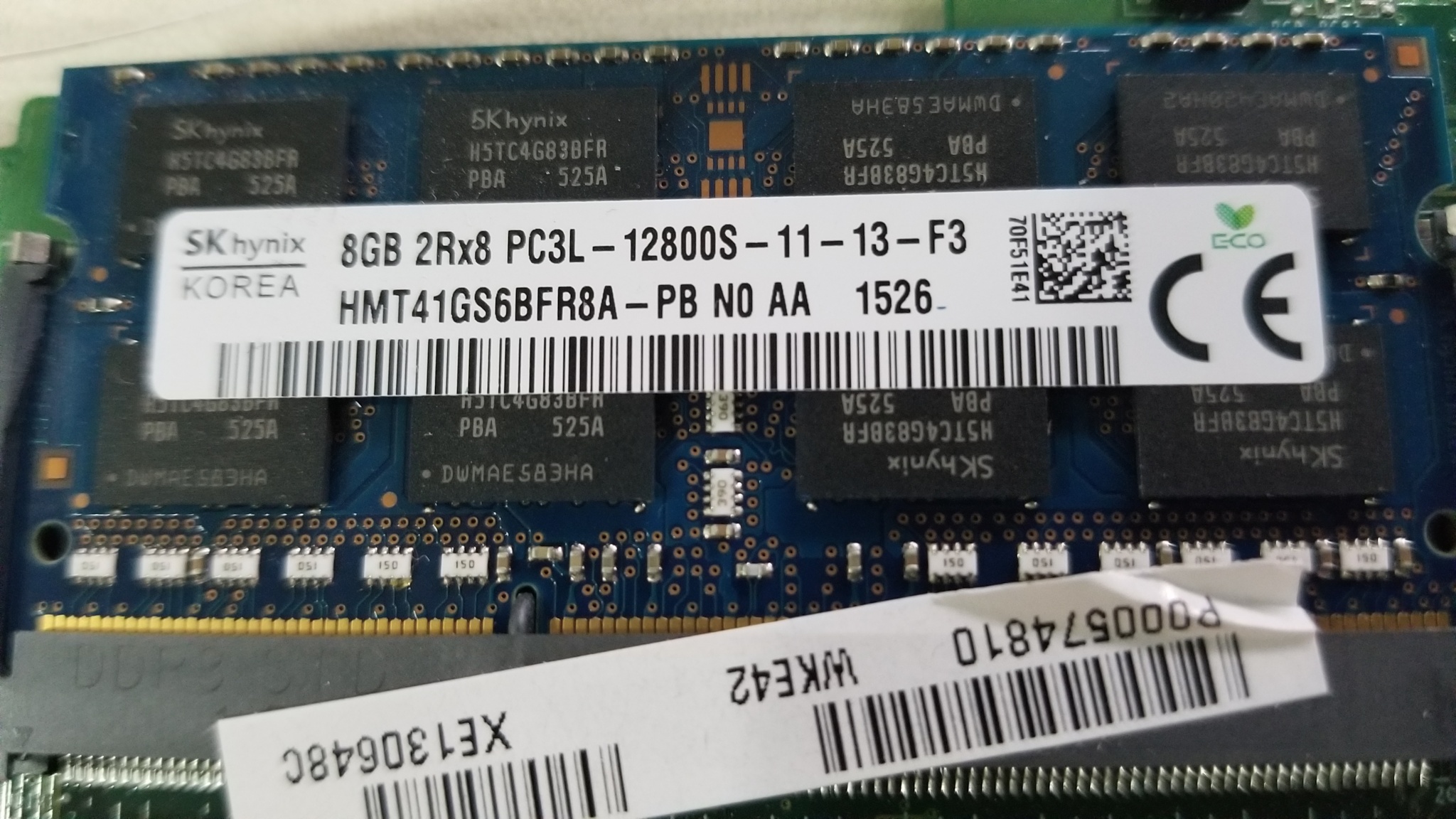

                • piernov
                  • Jan 2016
                  • 4439
                  • France
                  Re: Toshiba L55-B5276 turns on, but screen is dead
                  You need good compatible RAM (DDR3L) for the laptop to work.
                  • tibimakai
                    • Jan 2012
                    • 3680
                    I have popped in one from my own laptop, but I'm not 100% sure that it is compatible. I will have to do some research and see, if it is or not.

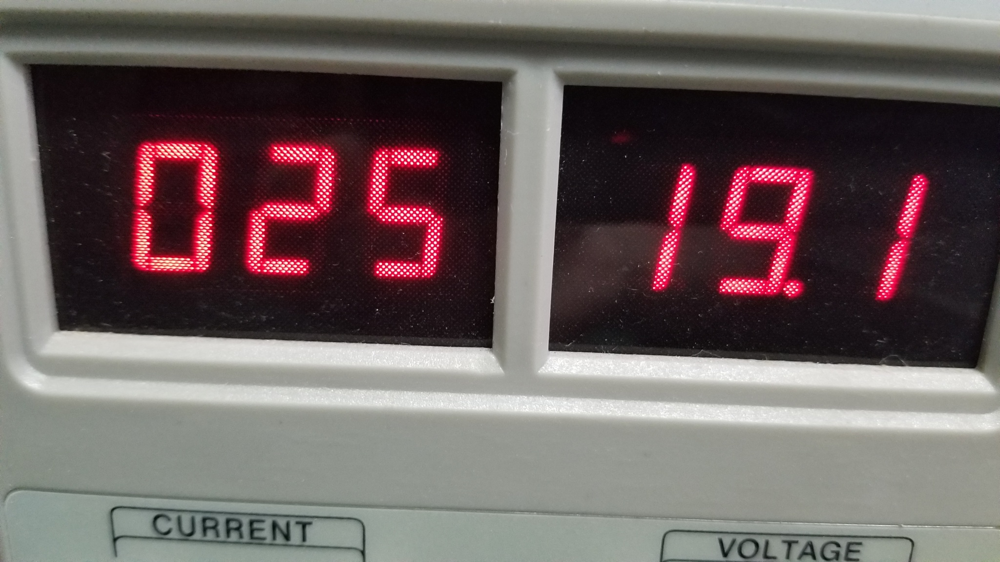

                    • tibimakai
                      • Jan 2012
                      • 3680
                      I have took some pictures, hopefully will help to visualize better on what is going on.
                      When the fan runs, the current goes up to 300mA.
                      Fan turns on and off, as it should.
                      Both CPU dies heat up equally.

                                      I have purchased a battery, just in case the it may be needed to boot.
                                      It charges alright(15.2V), power led is on, fan cycles on and off as it should, I have tried two other memories and it still won't boot.
                                      It consumes 1.2A, with battery charging and fan spinning.
                                      What else should I check?
