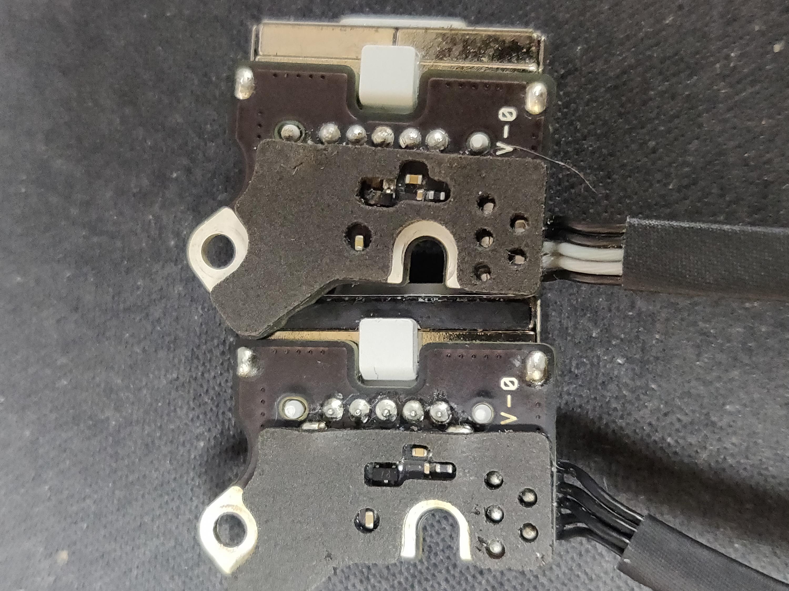

    I've got a Macbook logic board 820-3536-05 that I'm trying to repair, I believe it had a knock off charger connected. When I opened it up the DC in fuse on the logic board (F7005) had been blown and a unknown SOT323 type package was fried on the DC in board (photo attached).
    I have replaced F7005 and the DC-in board (820-2584-A).

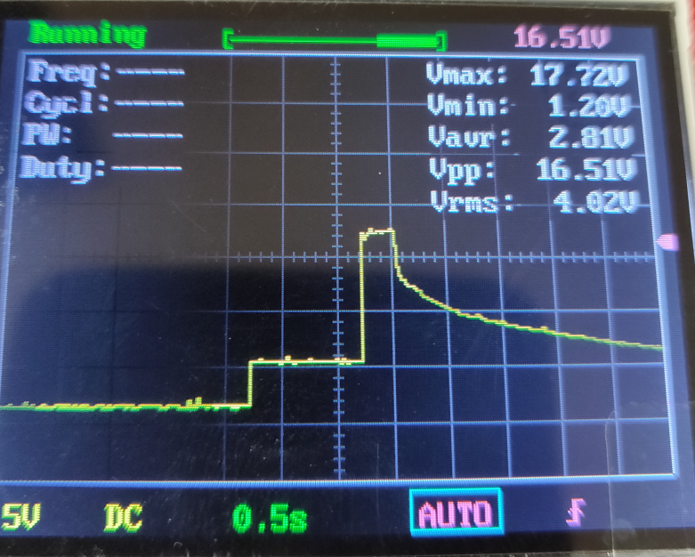

    However it will not take power from an official Apple charger. I see the 3V for 1 second which is supposed to activate the charger, followed by a momentary 16-17V but then the charger cuts out almost immediately (photo attached).
    Has anyone any suggestions?
    Many thanks in advance!

    Tried another 60W/85W Magsafe2? If yes, it'll usually be a defective Q7180.

      Re: Macbook A1502 820-3536-05 Only Works on Bench PSU
      That's great advice!
      I have removed Q7180 and can confirm that the source/drain on Q2 is shorted.
      I've got replacements on order, unfortunately not from the UK so might be a little while before I get an answer, but as soon as I do I'll be sure to report back.
      Thanks again!
        Great news!
        I replaced Q7180 as instructed and everything is working great, many many thanks!
