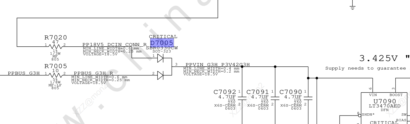

Macbook pro a1502 works, but not after a power off, then power on
This topic has been answered.
  • Xiran
    • Jan 2019
    • 49
    • Qro
    Macbook pro a1502 works, but not after a power off, then power on
    Hello again!
    I have a macbook pro a1502, which works without problems, the problem comes when I turn it off completely, and try to turn it on, the only way is to disconnect the battery and charger, I reconnect the battery and the charger, and only then does it turn on. I already reset the smc, but the fault persists​
  • Answer selected by Xiran at 02-06-2025, 05:11 PM.
    Xiran
    • Jan 2019
    • 49
    • Qro
    I put an extra button to power on/off the macbook, because like you say, it didn't work the power button
    • mon2
      • Dec 2019
      • 14753
      Disconnect the battery. Attach only the power adapter. Meter in DC voltage mode with 20v or higher scale.
      Carefully measure the voltage to ground on each pin of D7005.
      Post each measurement.
Name:	D7005.png
Views:	135
Size:	94.5 KB
ID:	3561584
      • Xiran
        • Jan 2019
        • 49
        • Qro
        Thx for answer!
        Tomorrow i´ll check, and post results.
        • Xiran
          • Jan 2019
          • 49
          • Qro
          Originally posted by mon2
          Disconnect the battery. Attach only the power adapter. Meter in DC voltage mode with 20v or higher scale.
          Carefully measure the voltage to ground on each pin of D7005.
          Post each measurement.
Name:	D7005.png
Views:	135
Size:	94.5 KB
ID:	3561584
          D7005:
          Pin1: 16.58v
          Pin2: 12.53v
          Pin3: 16.33v
          • Xiran
            • Jan 2019
            • 49
            • Qro
            Originally posted by mon2
            Disconnect the battery. Attach only the power adapter. Meter in DC voltage mode with 20v or higher scale.
            Carefully measure the voltage to ground on each pin of D7005.
            Post each measurement.
            Click image for larger version  Name:	D7005.png Views:	20 Size:	94.5 KB ID:	3561584
            D7005 with only power adapter:
            Pin1: 16.58v
            Pin2: 12.53v
            Pin3: 16.33v
            D7005 with only battery:
            Pin1: 0.03v
            Pin2: 12.51v
            Pin3: 12.33v​
            • reformatt
              • Feb 2020
              • 1541
              Have you verified the power button in the keyboard actually works? Check it on R5116 location --> SMC_ONOFF_L.
              • Xiran
                • Jan 2019
                • 49
                • Qro
                I put an extra button to power on/off the macbook, because like you say, it didn't work the power button
