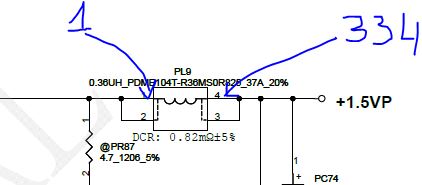

    hi
    after i repair the laptop , the laptop power on for 3 sec and off and power on again and off , i try to flash main and ec bios but nothing change
    any idea please .

    Re: please help acer v3-571 no data
    NO CPU COR
    +VCCSAP=0.9V
    1.5VP is missing comes from pu6 RT8207M vdd on pin11=5v
        Its better if you mention mb code and attache schematic, if available. Check whether you are getting 3VS and 5VS after switching on.
        motherboard model Q5WV1/Q5WS1 compal LA-7912P
        there is 3VALW=3.4v AND 5VALW=5v
        and i have 3vs and 5vs from pu21 pu22
        but 1.5v is missing .
          Check enable signals S5 and S3 on PU6.
          Measure resistance to ground on +1.5VP.
            s3 pin7=3.2v ; s5 pin8=3.4v
            which resistance exactly ? .
                Check PU6 pin 7 8 9 10 11
                PQ24 Drain 19+B , test PQ24/25 for any short, remove one pad of PL 9 and test the resistance both sides
                  thank's for help
                  pu6
                  pin 7=3.27
                  pin8=3.40v
                  pin9=0.13v
                  pin10=0v
                  i will check the others .

                    Pin 11 VDD ?
                      Pin 11 VDD ?
                      pin11 vdd=5v
                      pq24 drain=0.14v
                      no short in pq24 and 25
                      pl9
                      side read 334 ; side no reading no buzzer .

                        PL8 both should be 19+V this voltage comes to the Drain of PQ24 , if the Drain is 0.14V you have to trace it back check pc68/69 caps for short
                          sory i make a mistake
                          i check again the voltage on pq24 drain i found 19v but no 1.5vp in the source .
                            Ok now it’s time to change the PU6 and see for any changes ,check PR89 PC71
                              Ok now it's time to change the PU6 and see for any changes ,check PR89 PC71
                              I'm searching for an replacement
                              i have RT8207 but is not Appropriate.
