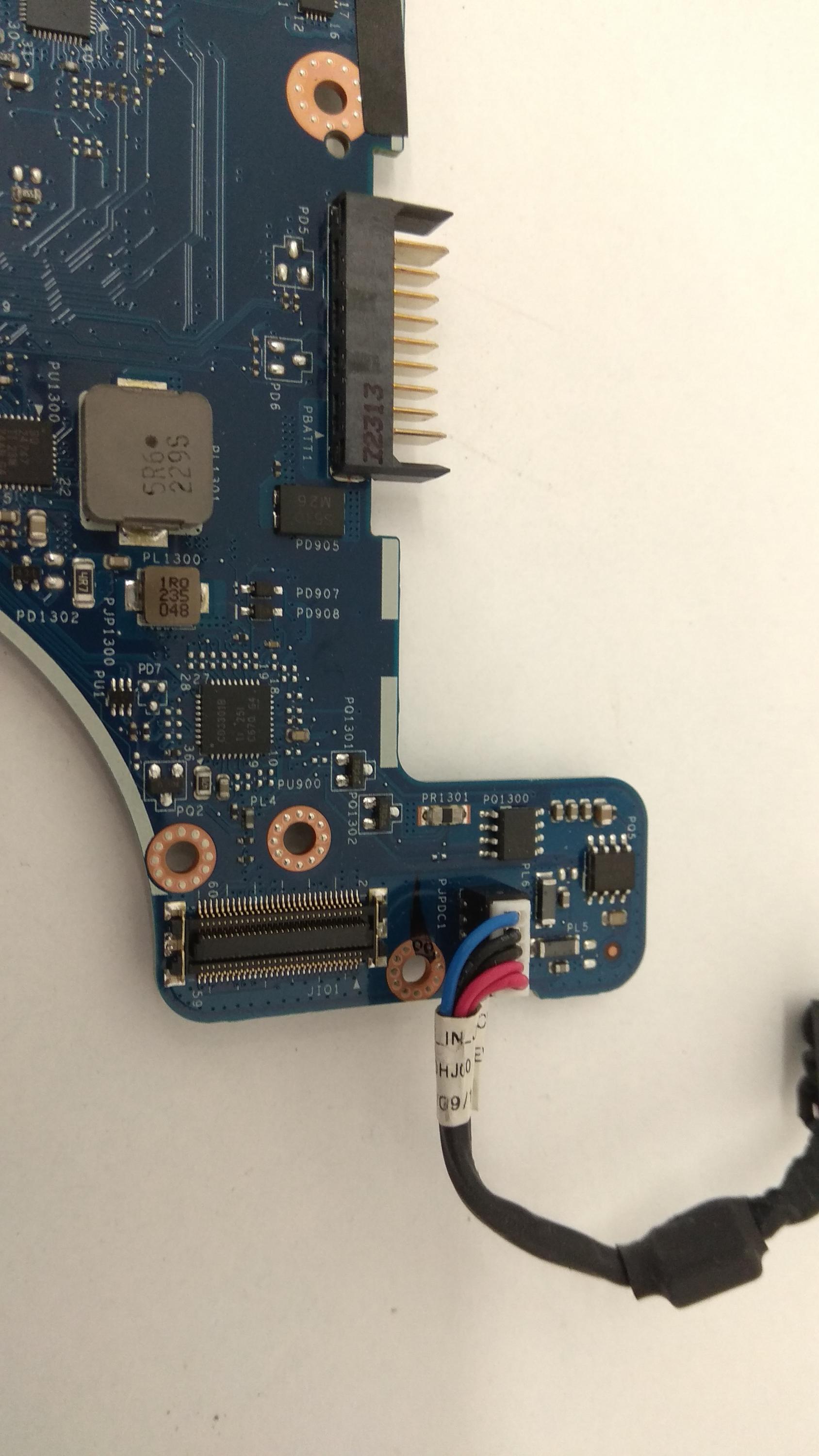

    Hello!
    When i plugin the genuine Dell adapter it doesn't recognize it and therefore it doesn't charge the battery, it only keeps the laptop power on.
    (the charging battery led light up for 1 second and then goes off)
    In BIOS i get "unidentified adapter" message, tried other Dell adapters without luck though.
    These adapters work like a charm in other E6430 so it seems like i have a ptoblem in PSID circuit (page 44 in attachment schematic).
    Tried other Dell E6430 batteries too, no luck.
    I also tried other connector (pulled out from a working E6430 but with no luck, also the line seems intact with Ω meter.
    Uploaded some motherboard photos from the PSID circuit too.
    Any advices welcomed, thank you in advance!

    Dell use a Small chip stored inside charger that use a 1 wire protocol.
    Check the connection on power pin to motherboard, try to reprogramm ec firmware.

      I checked the connection with another connector (pulled from a full working E6430) no luck.
      Also tested the connection between the plug and the motherboard with ohm meter.

        PR13 is 33 Ohms??

          So you mean there's a good connection between the center pin of the connector and the pad on the board? Do you get 3.3V on the PSID pin of the connector?

            Hello and thank you for helping me.Yes the PR13 is 33Ohms.
            On the PSID pin i get 1.73V.

              psid should be 3v

                      Voltage on PR12 PL4 PR13(both side)

                        PL4 and PR13 have 1.73V on both sides
                        PR12 has 3.3v on one and 1.73 on the other side.

                          PR12-both sides should be 3.3v

                              Did you check diode?pd7? Also pq2 did you check it? Resistance from gate to source?

                                PQ2 gate has no contact with ground at all, therefore no resistance measure at all.
                                PD7 is missing from board (never soldered)

                                  What about PU1 pin voltages??

                                    pin 1: 1.73
                                    pin 2: 0 (grounded)
                                    pin 3: 0
                                    pin 4: 0.05V (?!)
                                    pin 5: 5v
                                    pin 6: 0 (grounded too)

                                      I think you mean pin3 is 1.73V and pin1 is 0. Is that correct?? I doubt either pq2 or pq3 is bad.

                                        yes that's correct, so where can we check after this?
